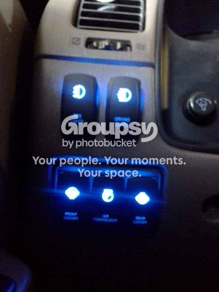

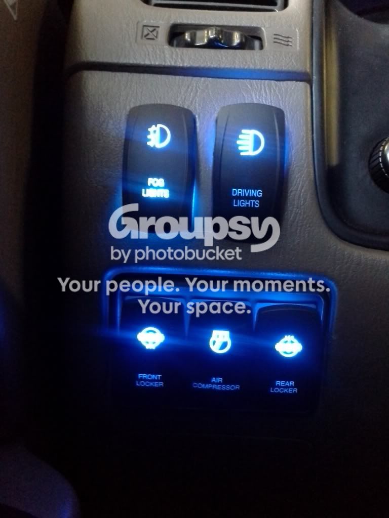

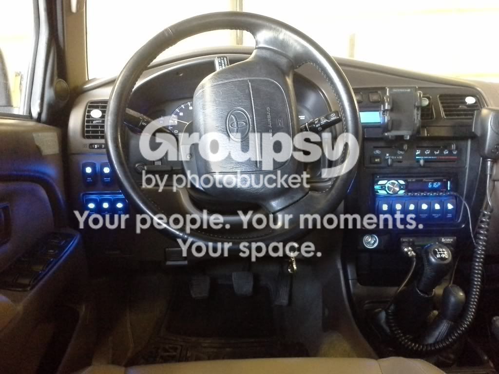

It's been a busy week and I am sure I must be in the top 10 customers at OTRATTW by now. I swapped all the switches on the left side of the steering column to match the rest.
All circuits off.
Only Fog Lights are on. Turning the bottom LED on. These switches are awesome.

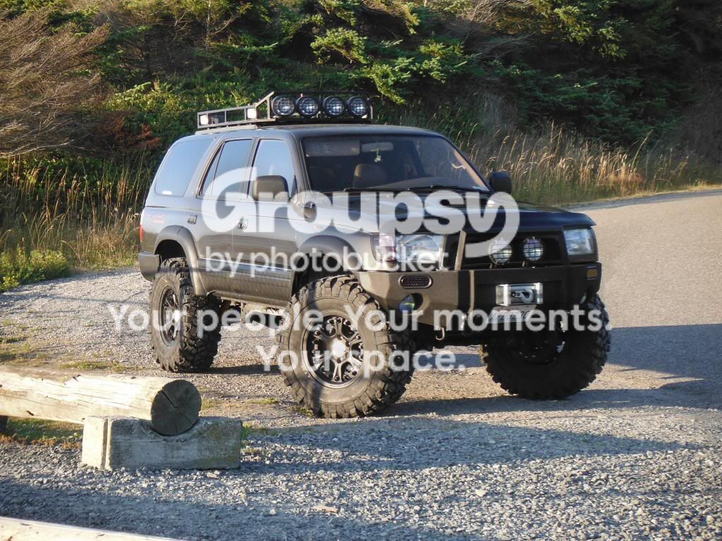

I have been following you thread for a long time and never really liked your bumper, it always looked too big to me.
But holy shit does it look good with the 35's!!
I have to say your 4runner is now one of the better looking rigs I have ever seen and that bumper you built with the 35's is by far the coolest thing I have seen on a 3rd gen.
I am sure you already know that your truck looks good but thanks for sharing the pictures you obviously know what your doing with a welder keep up the good work!
Wow! Thanks man. Though I can't take all the credit for the bumper. My buddy is a magician with a welder. I just explained to him how I wanted it and he made it happen.
It's funny because I've always thought the bumper was awesome but was almost out of place. The roof rack bothered me too. I liked both but they just didn't seem to fit. Now that I've got wheels and tires on it, it just fits I guess.
So sweet! I am liking the Contura V's more and more every time I see them...I might just have to swap mine out.

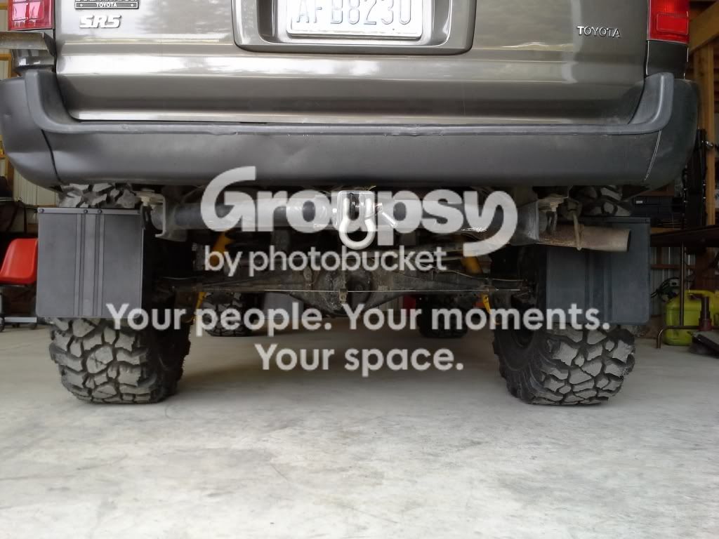

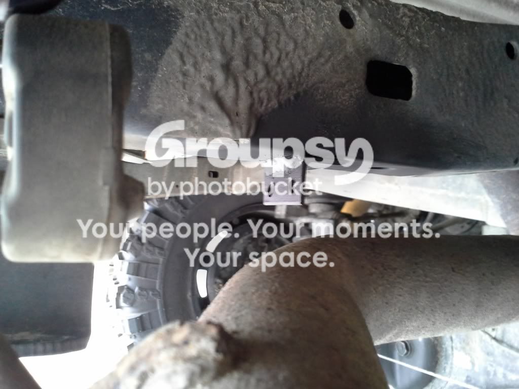

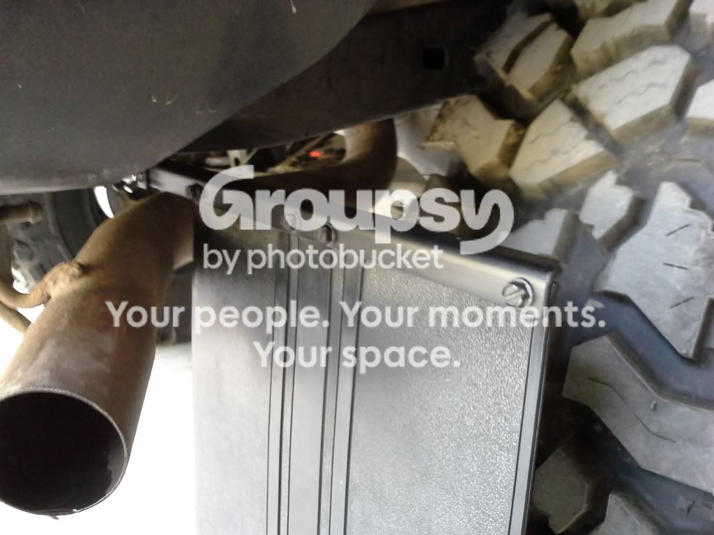

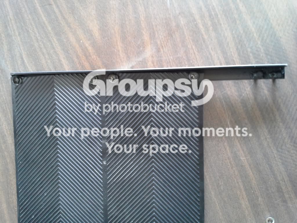

Not much of an update: Since I cut the rear bumper to clear the tires I wasn't able to keep the mud flap/fender flare combination. I needed some sort of mud flap to keep the truck as street legal as possible and the local police out of my ass.

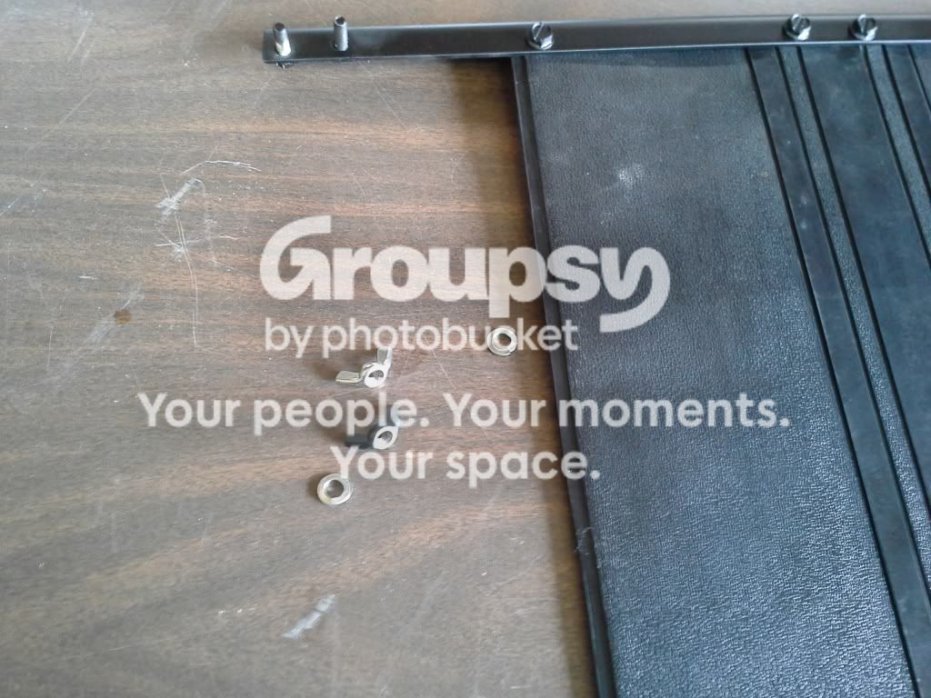

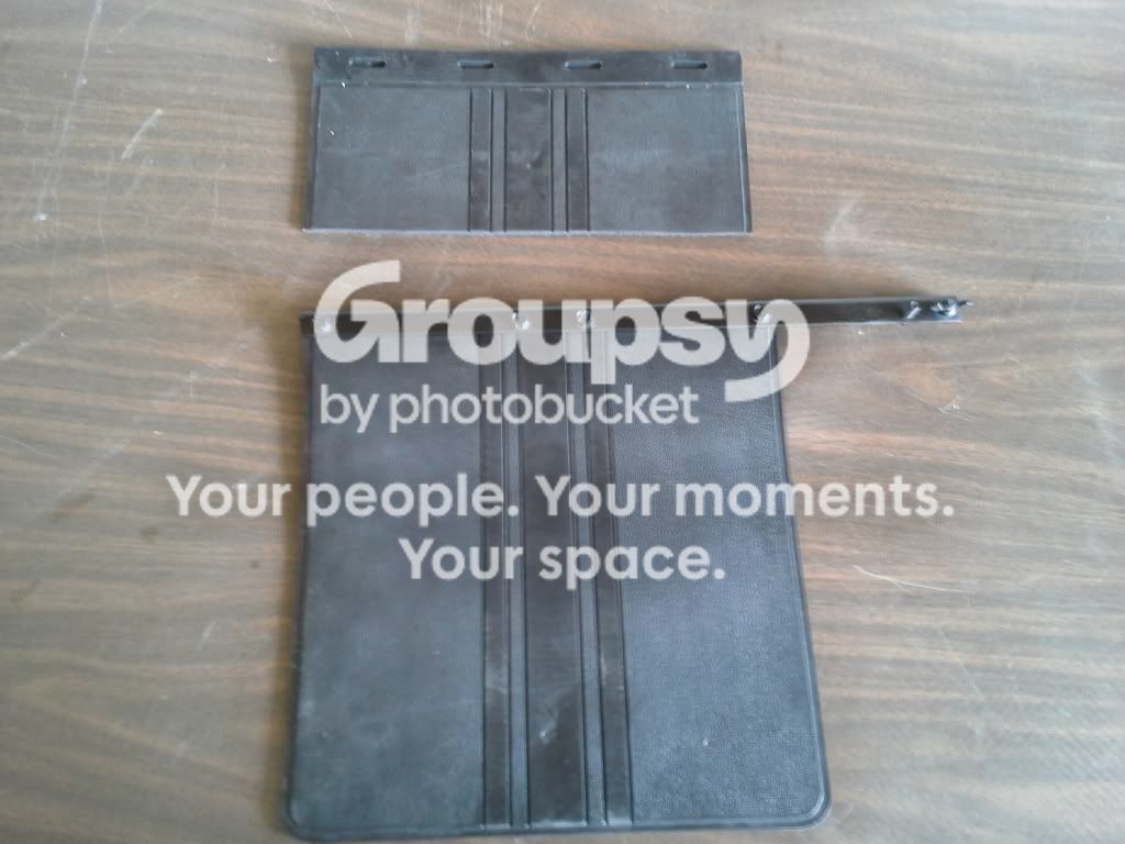

I always ended up ripping off my mud flaps when wheeling in my last truck. So I made a pair dis-connectable ones and solved my problems. Here is my rendition of Quick Disco Mud Flaps for the Runner.
I think the pictures can explain the rest.
I don't find it to be the most desirable look but it gets job done and I can easily remove them.
Yeah, I know the hidden hitch sucks and needs to go away but I don't want to pull it off until I get the rear bumper built.
