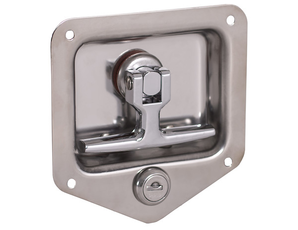

I like these: Search for "t handle latch"
https://www.amazon.com/Buyers-Produ...=B0000AX4I8&psc=1&refRID=KD8WMT0HYMM1MN80VVBW
The T handle swings the latch mechanism into place against a striker plate (you have to supply something to catch on) and the handle when you fold it down to the closed position is a cam mechanism that puts a good amount of pressure closing it.
Thanks. Those would be great on a new build.
I'll have to decide what I am willing to do in terms of taking the lids off this one and creating a router template.
If they were completely recessed it might be worth it (or just the 1/6" thickness of the plate) but with the lock being on top, I'm not sure I gain anything over the ones I linked above.
