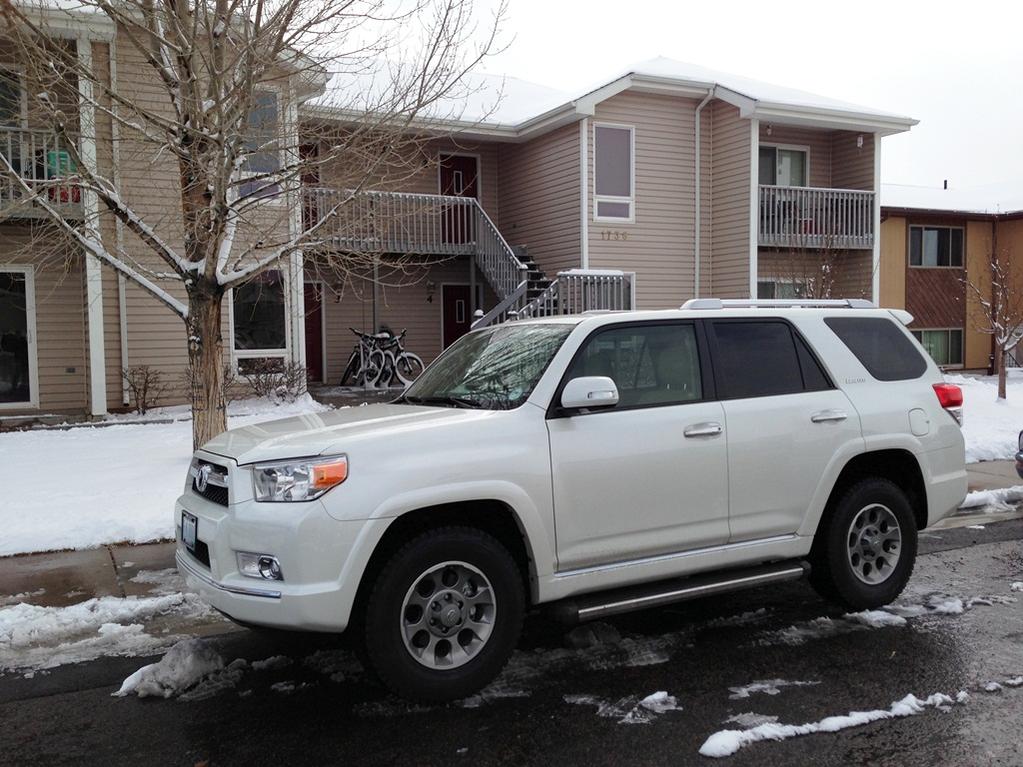

The snow is finally here! Took the truck to the tire shop this morning and put on the Blizzaks with the FJ wheels I bought couple weeks ago, everything fitted nicely, nothing special was needed.
Just want to share this with you all, and for those of you who weren't sure if a TE or FJ wheel would fit on your LEs, here's the answer and it is a YES!

I was considering getting a set a few weeks ago but couldn't visualize them on BP. I actually don't like them - but if you do, that's all that counts! I bet they look great on Mag Grey though.
I'll keep them this way this year and I might try some different color coatings next year.
BP is great coz it always looks cleaner than what it actually is, yea... I know... I'm lazy :biggrin2:
