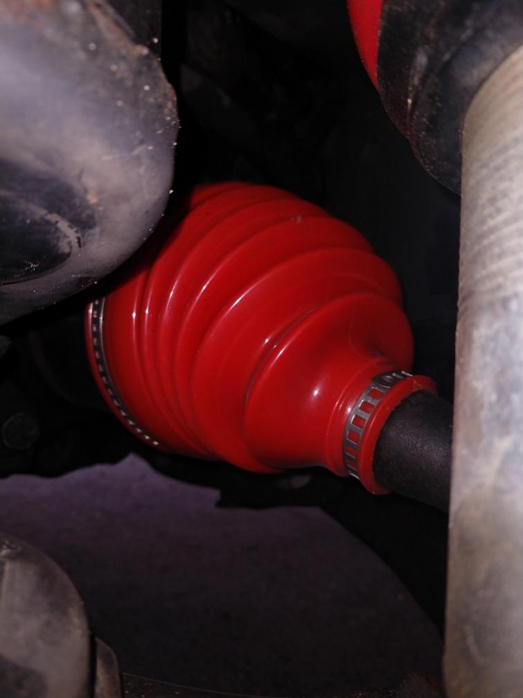

Well the passenger side exploded as well, so got some new silicon inner boots on now. Think the driver side just had some really bad burping as there wasn't a noticeable tear (but it was pretty old), passenger side had a small tear. New boots for both to just be done with it.
