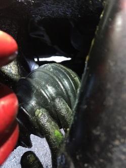

Afraid I'm looking at the same thing. Front right CV is sprayed with liquid. Not on any of the other wheels. Just had a 3" lift done a month ago.

From the look of the pic, I'd wager his boot is torn. After a lift, they usually fail one of two ways. The new angle causes strain on an old and less pliable boot and the inside boot tears at the narrow end at the juncture of the thick shoulder that the clamp goes onto and the main part of the boot. The second way they fail is the new angle causes the boots ribs to rub together. When they rub together it creates friction and the boot tears. Analyzing the pic, it looks like his boot tore due to friction between the boot ribs.

Well, instead of a bunch of conjecture here, the member from Post #26 needs to simply examine his boot to see if it's torn. His doesn't look like a burp. His looks like it threw up.

After researching around a bit, I agree they are likely torn from the change in angle. No noises or general disturbances noted yet. Have read about some people letting them go all through winter like this. I probably won't do that but good to know I've got a little time cushion before I will have to have it fixed.

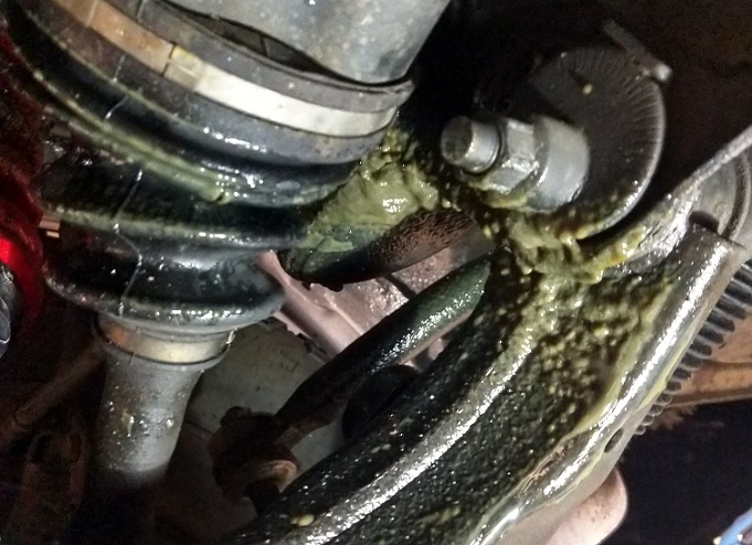

Gave it a good cleaning, and a few days later it was sprayed again. I'll get in there for a close look today and post a picture if I can.
Finally looked closer.

Ok just got in there for a closer look finally. The wide end seal seems intact from what I can see (I could be missing something small up close to the clamp though). Wondering if it could be an extreme case of the burps...maybe just need re-clamped/tightened up.
Picture for reference. The narrow end looks ok (and dry).

Did you check all the way around the boot? Might be easiest to jack the affected side tire off the ground and spin the wheel while looking.
