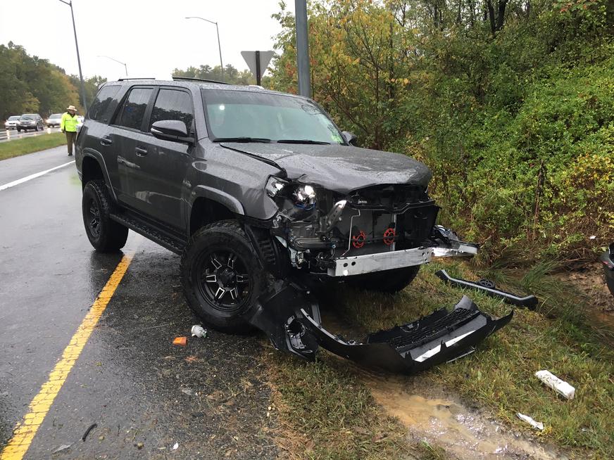

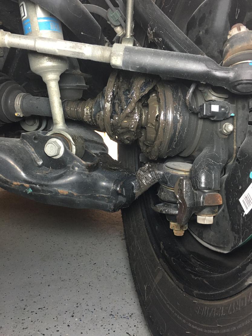

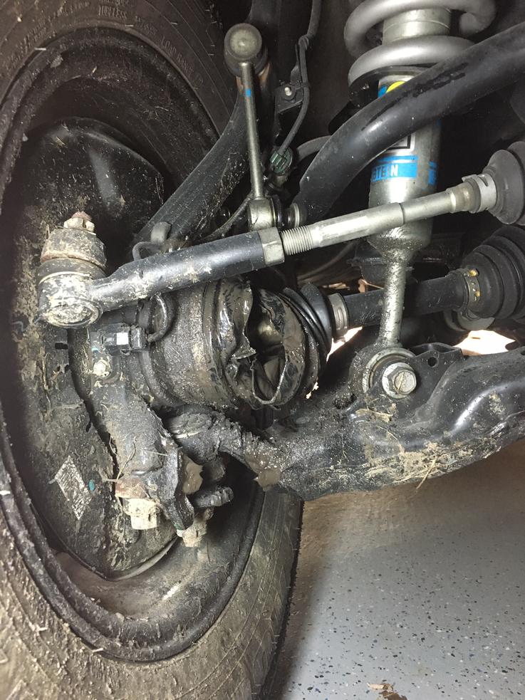

Cool, thanks again! The only thing that worries me a little is the axle itself might be damaged/bent. 6 months ago it was in a front-end collision thanks to some guy high on PCP... Yeah, sketchy. This is all speculation because my wife was driving and things don't quite add up, but here's my guess. I'm thinking the front passenger tire took most of the impact because the knuckle clearly nailed the metal stopper on the lower control arm and caused an error code (steering angle exceeded) and blew out both outer boots. In fact, the cv grease that got on the sidewalk of the tire completely at away at it while sitting in the body shop for over a month.
So instead of replacing both CV's, they just replaced the outer boots and now all of a sudden I have a leak on the inner boots. Could be coincidence but is there a way to test if the axles are in fact damaged? Maybe a vibration is causing the leaky boot? Truck drives fine and no issues in 4WD that I can tell.
Here's the aftermath...

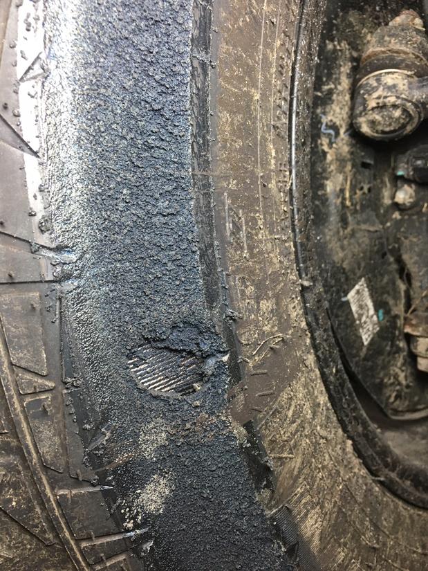

Tire damage supposedly from the cv grease... Never seen this before and to me it looked like the tow truck guy towed it ass up and something was dragging against the inner sidewall... Definitely looks like friction damage to me, but Im no mechanic

Wow! I'm glad she was ok! I'd have had them replace the whole axle tbh. I don't know how to test it though without taking it all apart. I'd say that something is definitely not right but idk. That is the crappy thing about accidents. Unless you really know the people doing the work, you just are always wondering. I'd ask someone in the business you trust (if there is one) for a second opinion.

you got hit that hard and had visible damage to the CVs and the insurance company didn't replace the axle?
it's good that toyota replaced the boots, but i would really push back on the insurance company about this. did the PCP guy's insurance cover this or did you file through your insurance? If their insurance gives you a hard time, you can file with your insurance and let them deal with the other insurance company.
In my opinion, the CV's weren't damaged in the accident. I've never seen anything like that before and my wife said she barely felt the impact. Also, the airbags didn't go off so either the angle was wrong, or the impact wasn't very severe.
I think the tow truck driver towed it incorrectly for 30 miles which would explain the damage to the inside of the tire sidewall. I honestly can't think of any other explanation. But to your point, I agree that the CV's should have been replaced. If it starts leaking again, that's what I'll demand.

Oh, missed this part. He didn't have insurance and the plates on his truck were stolen. Huge mess... Good thing we had uninsured motorist coverage. State Farm has been great every step of the way. I think this is just one of those unforeseen circumstances that I have to deal with.
