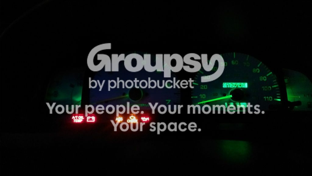

I have a 98 and have two hotspots behind the climate control. the lights still show up green because of the panel i guess. did anyone do anything to get rid of the green?

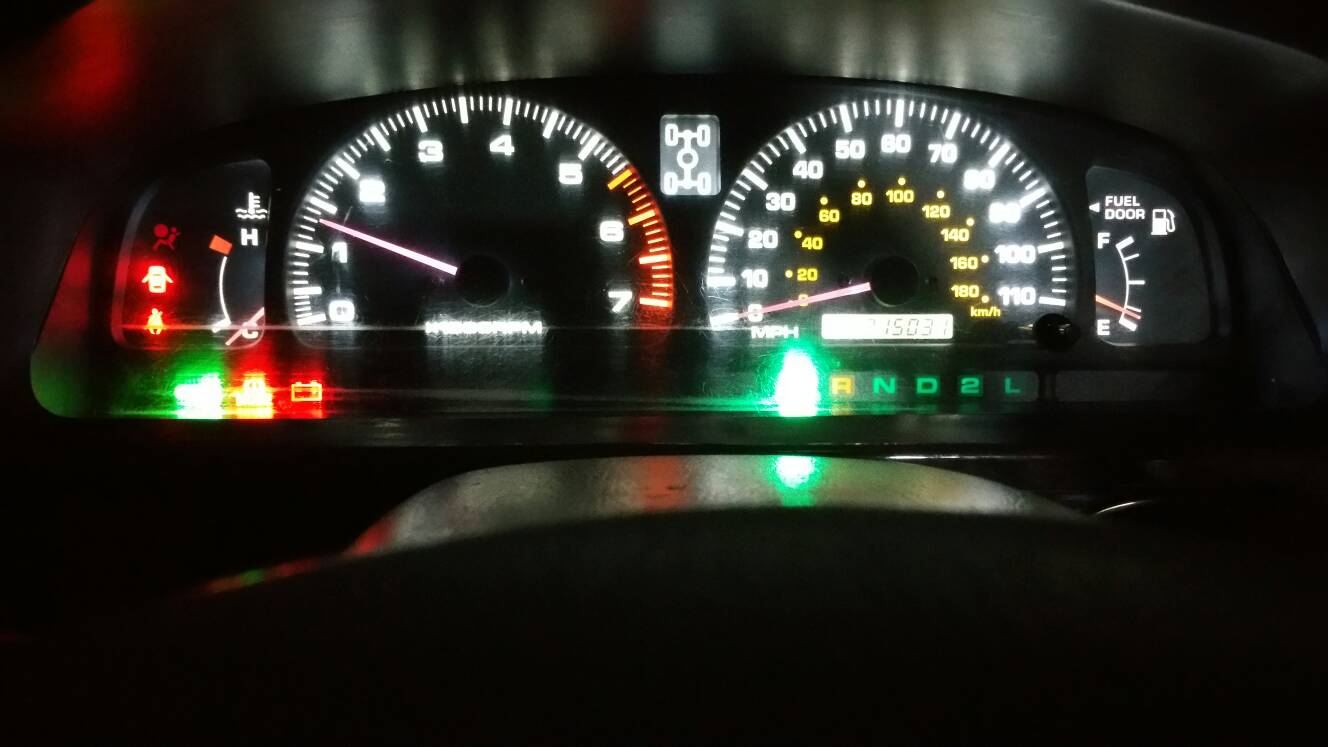

I'm not super happy with the gear shifter illumination either. Curious, which color did you use? I went with blue and purchased the 3 smd 360 degree viewing angle and wonder how much of that light energy is wasted...

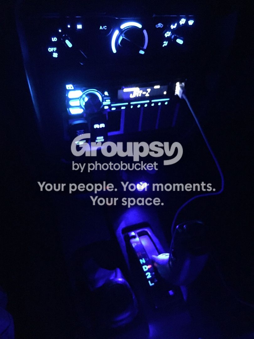

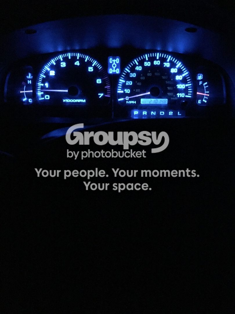

Sorry for multiple posts, especially because I'm new, but in case anyone is wondering, here is how the blue came out. Hard to see the gear shifter light(or lack there of) with the other led out of the power outlet but...

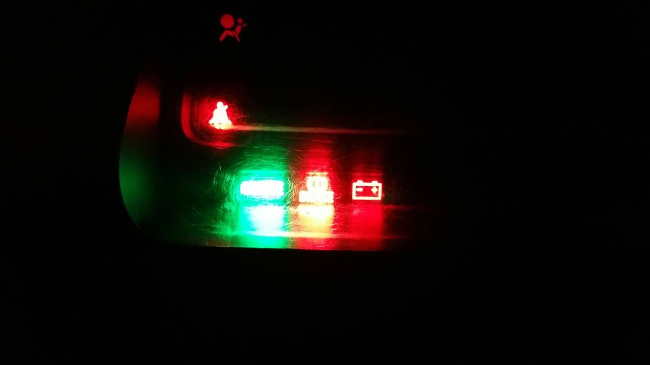

That blue looks sweet! I ordered same bulb but in white. I might purchase a 30 degree bulb to see if that helps. Also I am having another issue. My cruise control light is constantly on. It's dim when my cruise control isn't on and goes to full brightness when turned on. Is this something I did wrong? My battery light is doing the same thing but I have no way of testing to see if it's really on or not. My scan gauge says 14v so I assume my battery is fine.
[MENTION=10169]TheDurk[/MENTION] do you have anything on this? I'm at a loss on this one.
How did you get the transmission lights blue? Mine have the green overlay and I couldn't get them white.

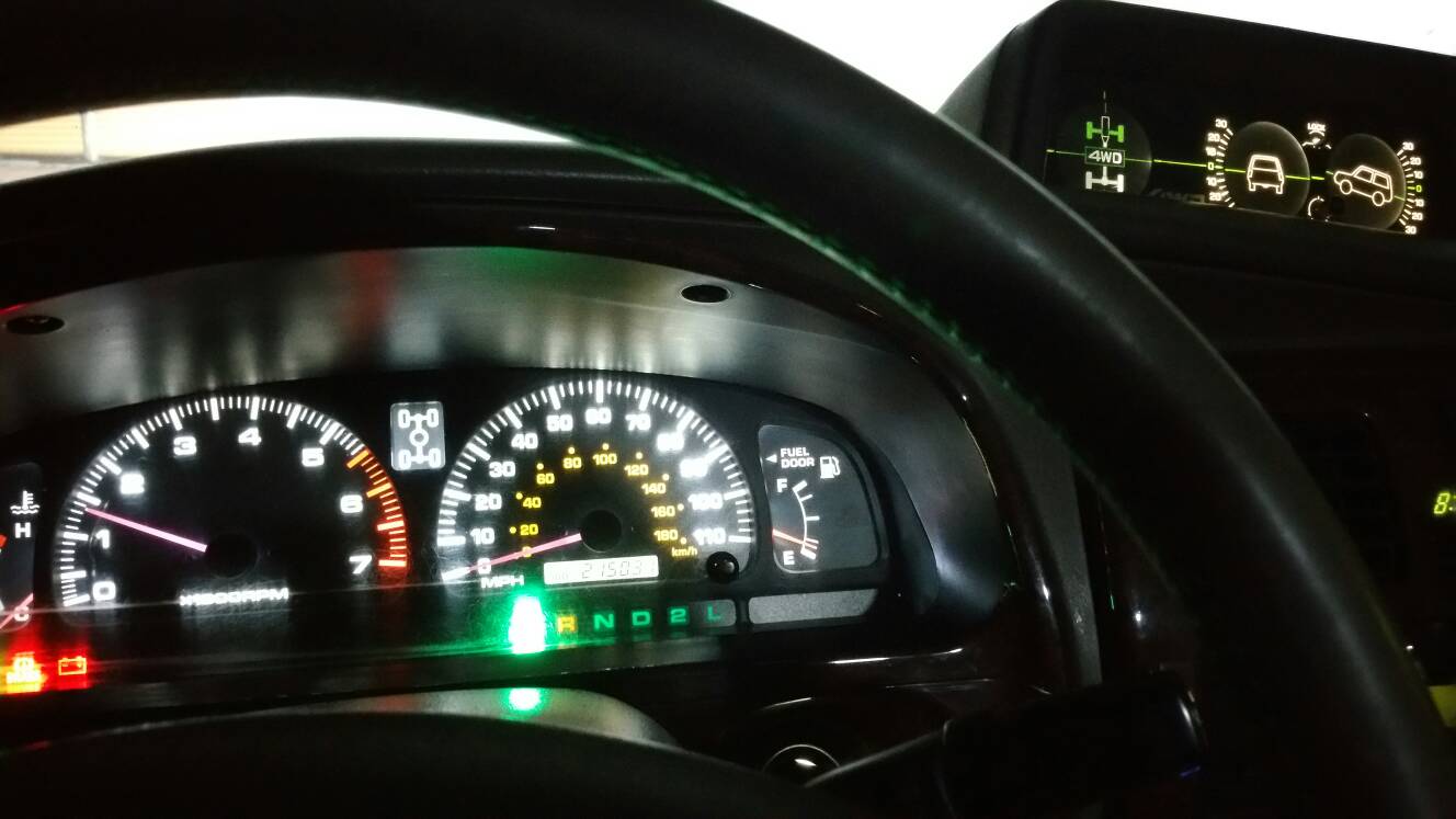

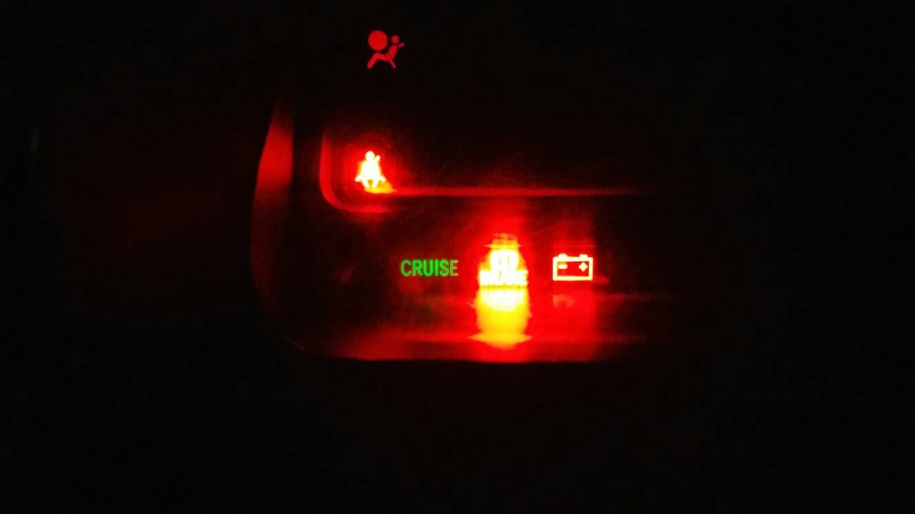

Here's my problem. Sorry for crappy pictures they are from my phone. You can see the lights just not what they say here's cruise control off
And here is when cruise control is on
Also in these pics you can see the battery light on. Not sure why this is happening but if I can fix I may just take these lights out. Other then that here is the overall look

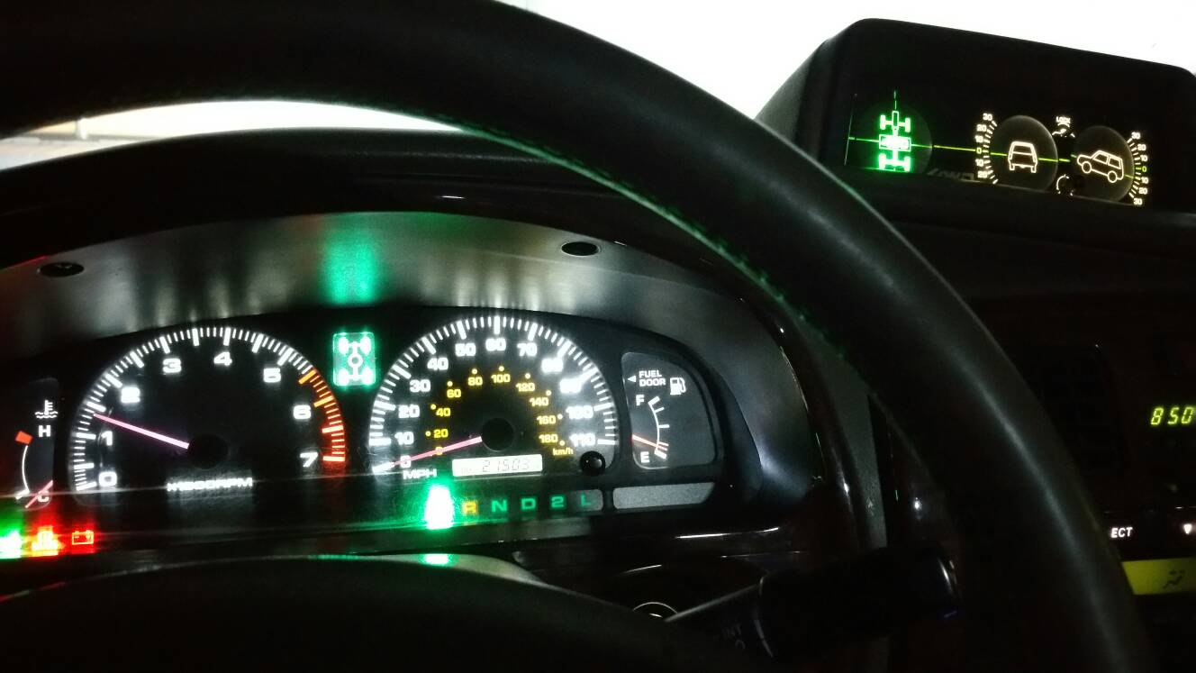

And thanks to theDurk here is my inclinometer hooked up without 4wd activated and then with it activated
Came out great I couldn't have done it without your help. Thanks again theDurk and mstudt!

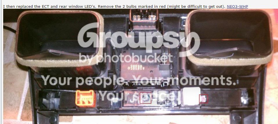

How on earth did you get your defrost/ECT button to light up so brightly? Due to the shape of the LED base and the indirect way it is lit, mine is super dim compared to the rear window switch using the same bulb. I'd also like to replace my climate control faceplate due to yellowing. That might distract from the hot spots that I got even with the more expensive 3 LED bulbs I got.
I'll have to check it out later, mine might be dimmer as well and the quality of the photo might make them appear to be the same. There are definitely some inconsistencies in the lighting in all of the gauges and buttons.
Any chips in the tubes that lead to the buttons will also cause the buttons to become dimmer as I'm sure you can imagine. I'm trying to think of a better way to transfer light to all of the controls but it's hard to do so with the way that the system was designed.

I think the 02 has slightly different gauges than yours (not super knowledgable here). I didn't do anything special, just popped in the three #24 bulbs. I'll look at my dash tomorrow to see about the greenish overlays.
I'm taking a shot in the dark here, but could it have anything to do with the increase of white back light? Does it still happen with that bulb over on that side of the dash in? I'd pull it out and see if it still happens. Hopefully I didn't sound like an idiot!
Ha no you don't sound like an idiot. I thought the same thing at first but when I pulled the cruise control bulb the light went completely away. Even with the white bulbs in.
One thing... I don't see the yellow highlights you are mentioning in the post about the ECT and rear window LEDs.

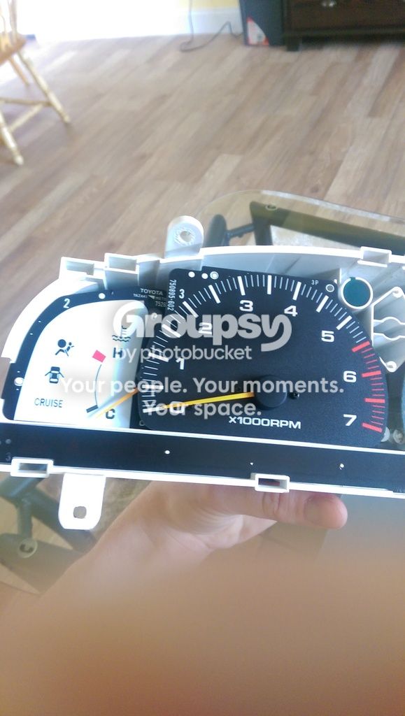

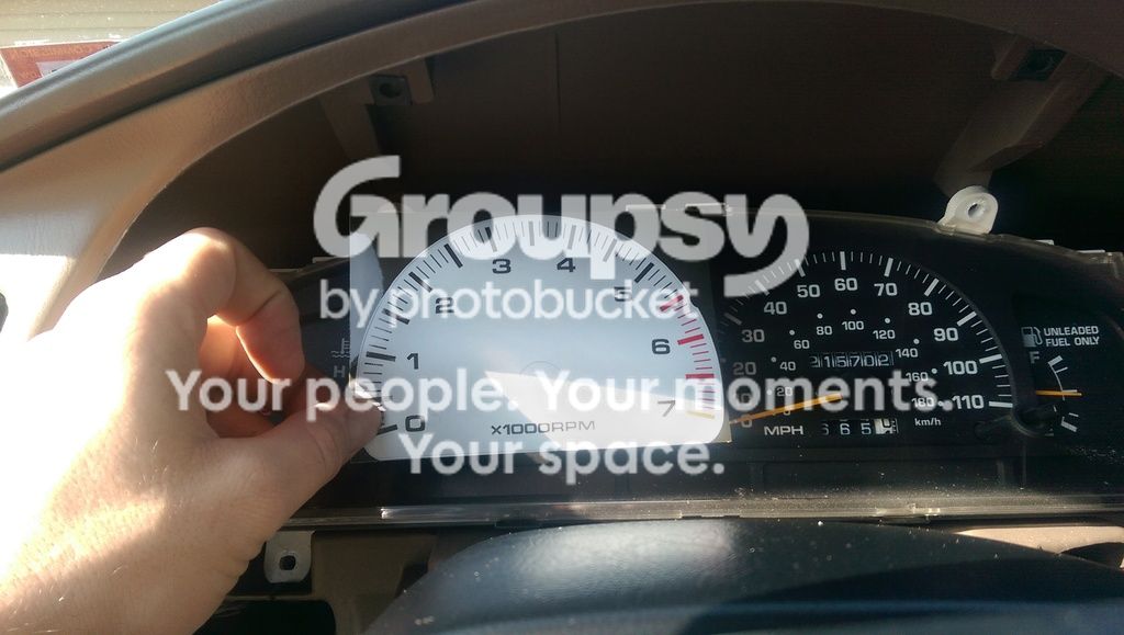

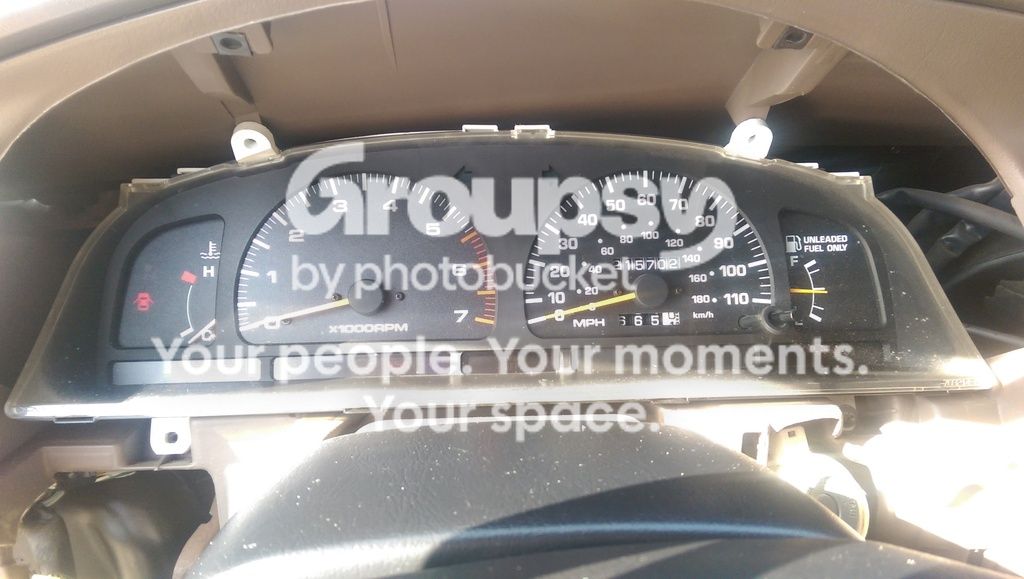

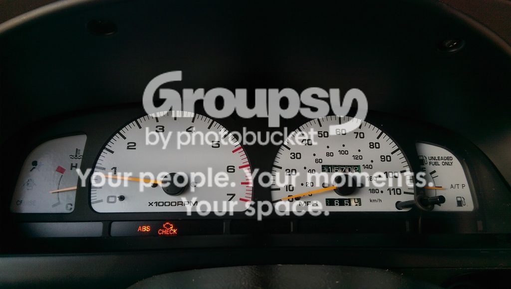

Installed a white face overlay. From low range Offroad.
For some.odd reason the RPM section is dark. Idk why
I thought about doing that overlay until I saw pics of it. I think you have to be pretty accurate on the lay down to let the light through. not entirely sure.
