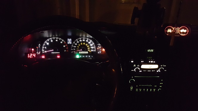

Also, does anyone have a picture of all red LEDs in the gauge cluster/center console? I have always liked red lights on the interior.

When I get back to my truck I'll measure and send you a pic. I love them. Got the whole cab upgraded to led. There's a thread somewhere that I posted pics in.
Those look almost identical to the ones I bought on Amazon from CuteQueen, or whatever the silly name is. The light output is a night and day difference(pun intended), but it is a very tight fit inside the light housing. If the color was a tad warmer, it would be nice, but it's also nice to be able to see everything inside when you open the door at night.
