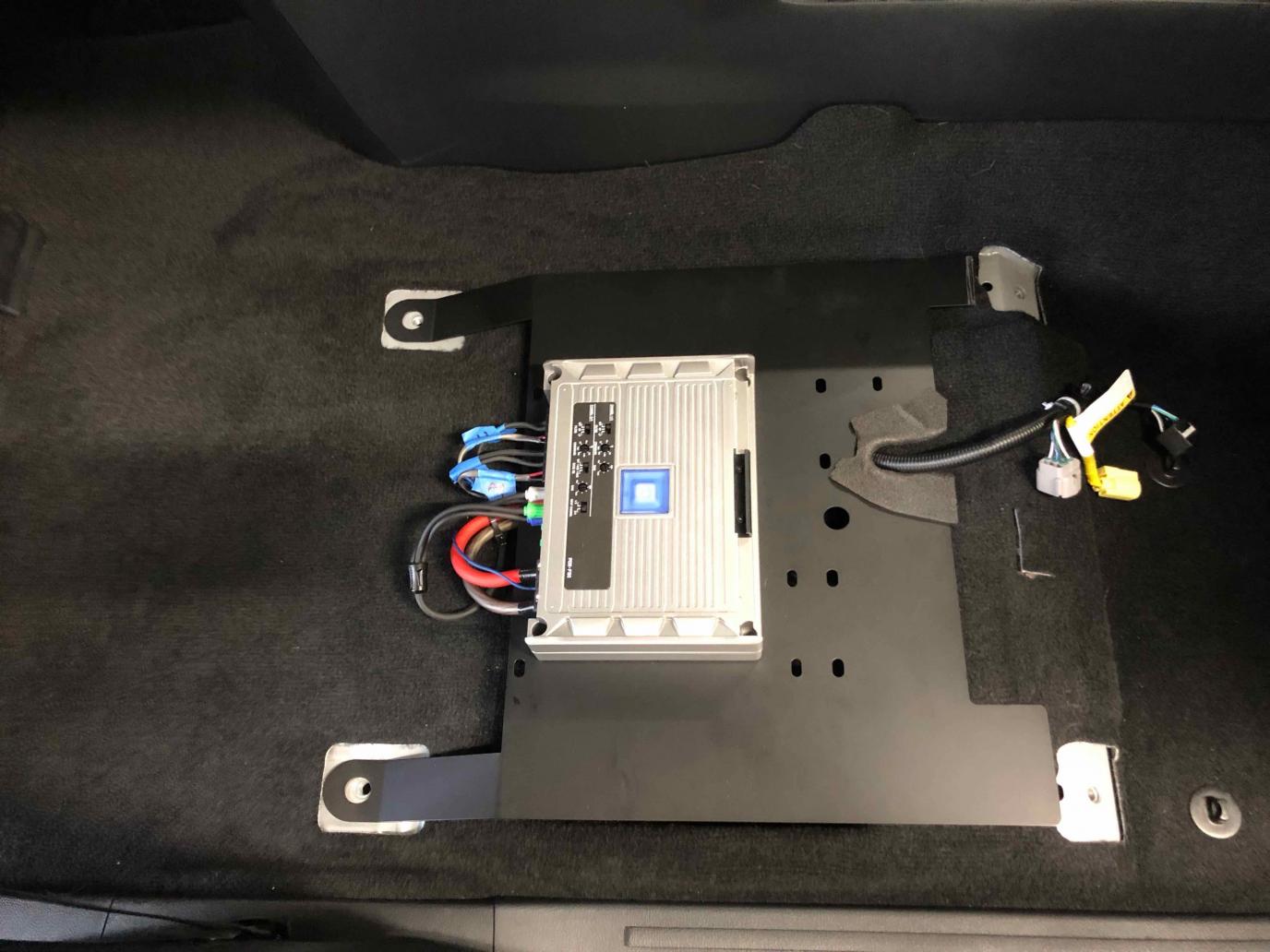

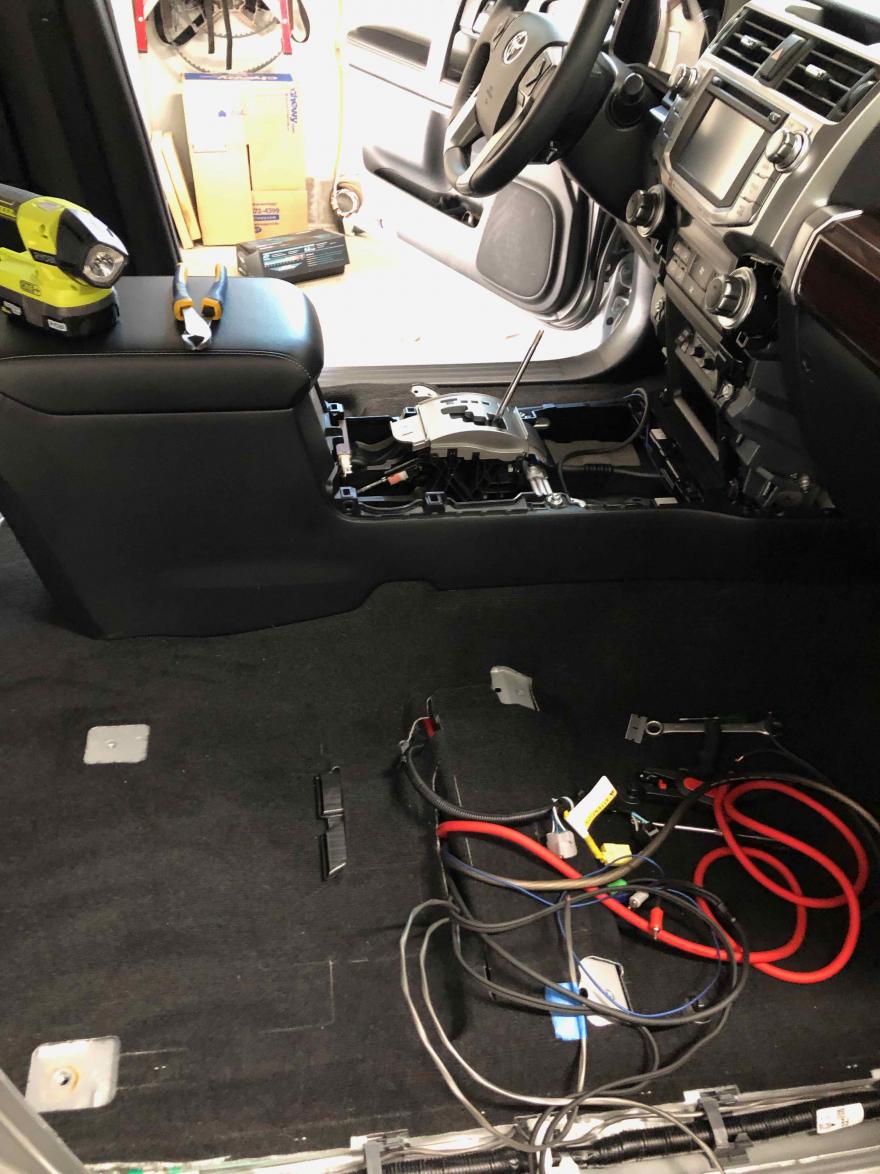

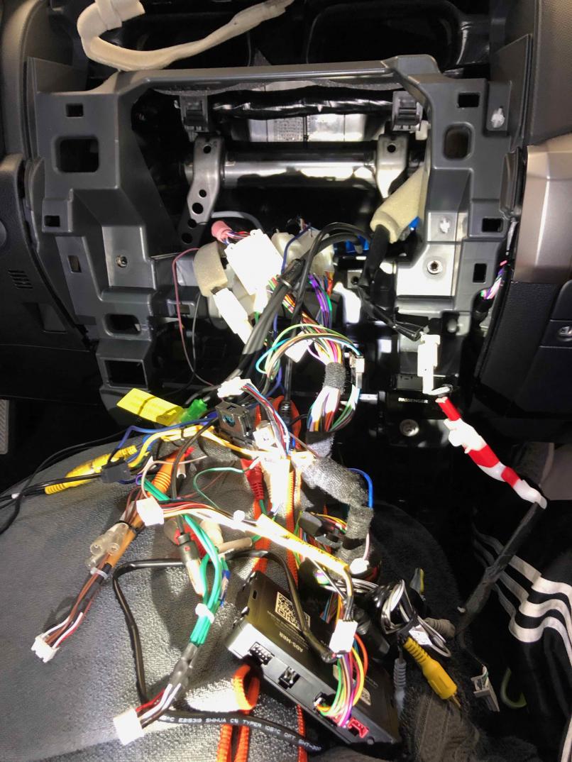

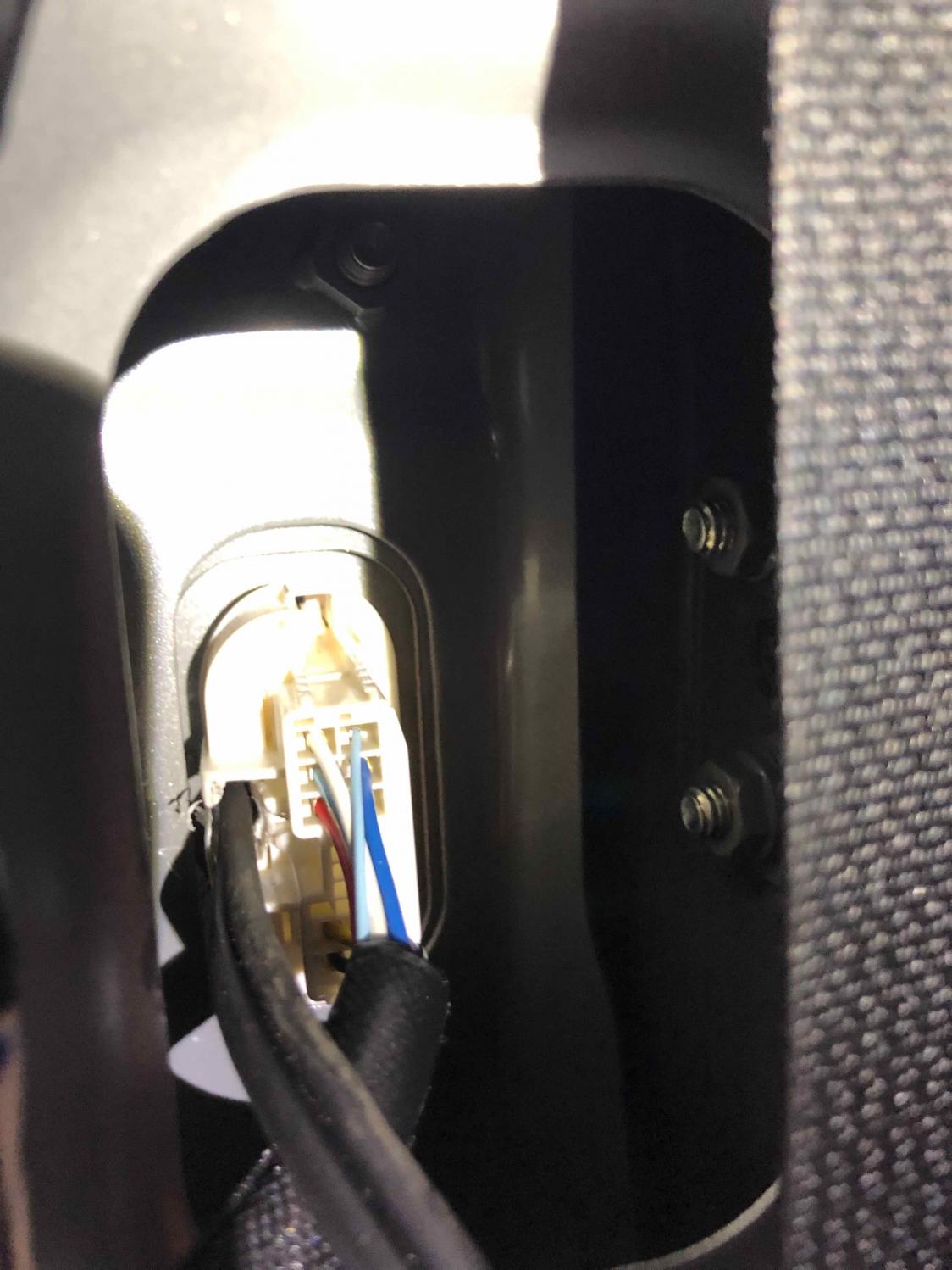

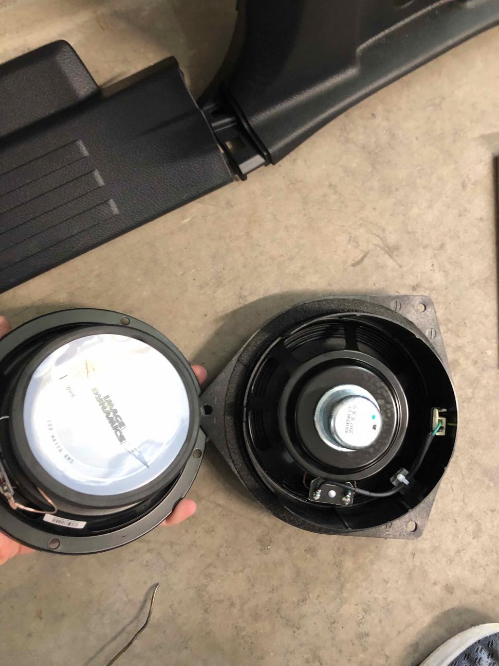

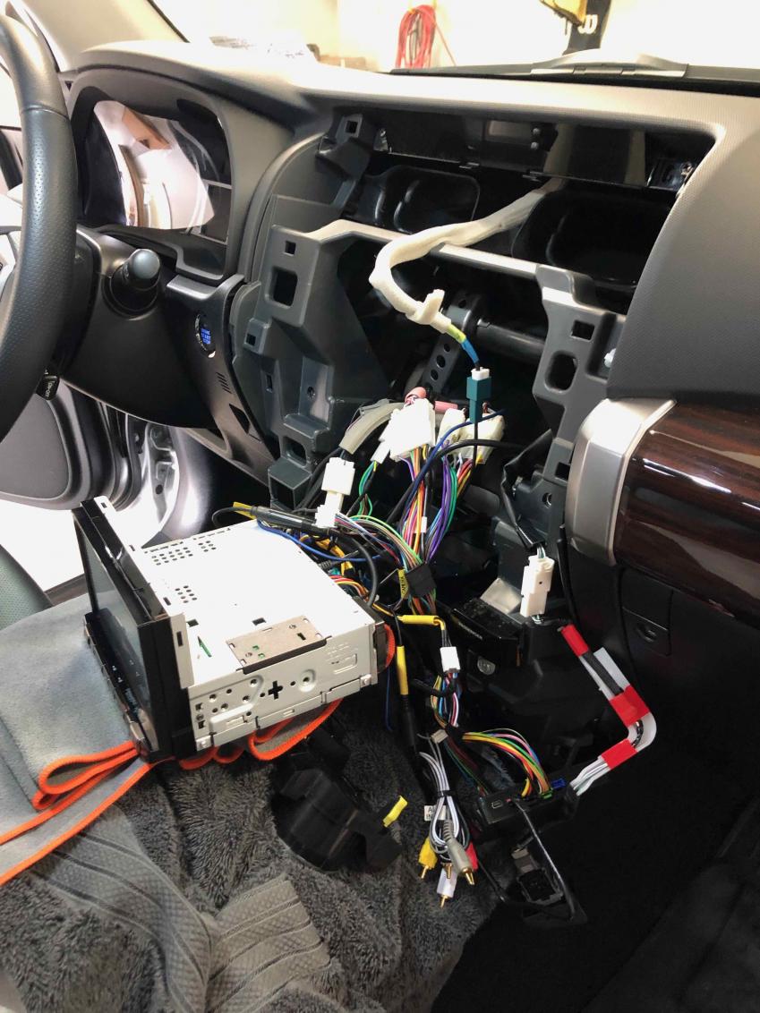

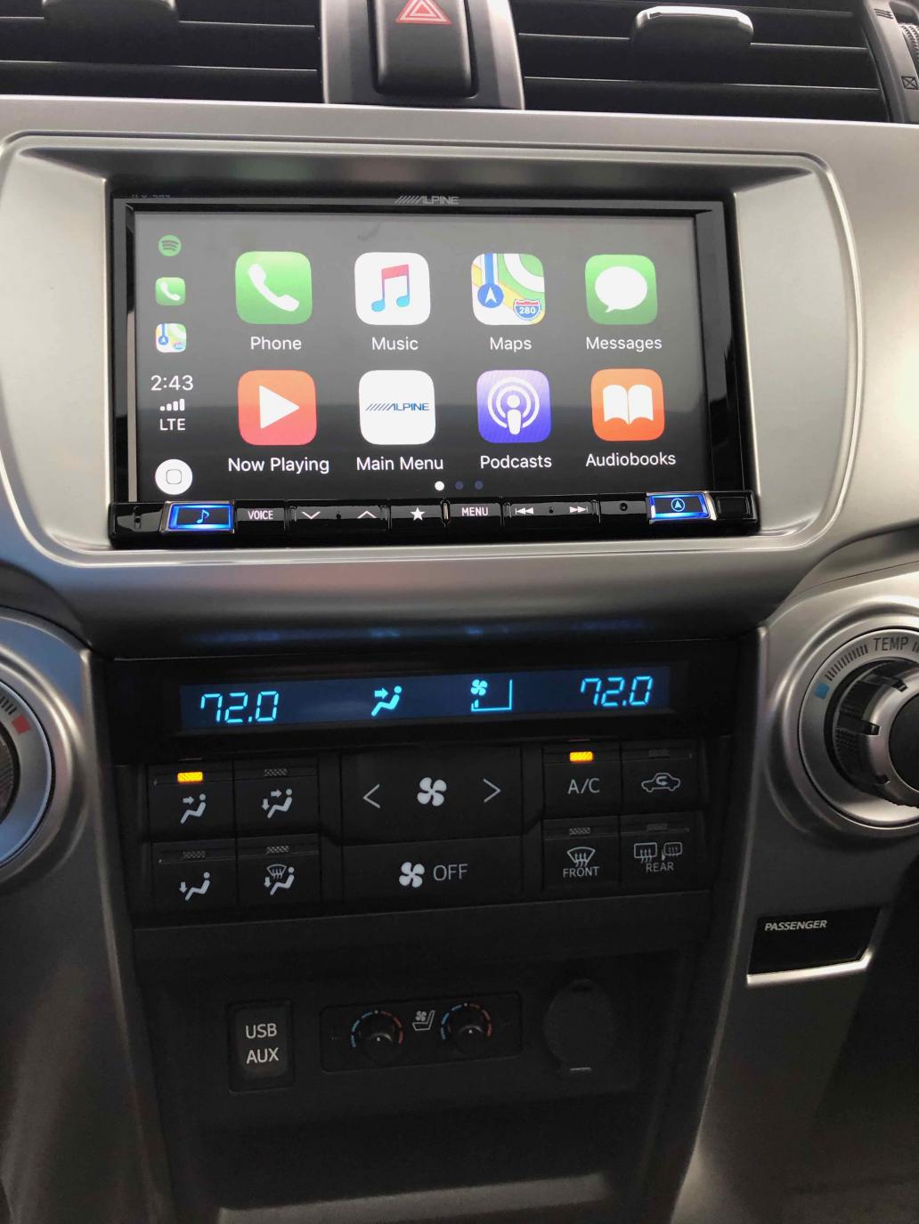

Finally done and I'm beat.
Took me about 4 days. Doors a solid 2 days with running new wires through the B-pillar...carefully drilling through the plastic plug and then fish the 14AWG speaker wire to the new speakers. The front doors were a bit easier fishing the wires through the rubber tubing.
The idatalink module albeit great features/functions is a $itch to cable up and stow away. I paid the extra cash for crutchfield to make the ready harness. They only thing they messed up was not providing my remote wire to the amp. They had it all taped up and zip tied. Had to under a few inches of tape and tap into the blue/white to run to my amp.
Used TacoTunes speakers front and rear plus their amp rack that I had to slightly modify.
Everything else came from Crutchfield. Love their tech support and used them to troubleshoot my rear camera.
Overall, sounds terrific. Love Apple CarPlay. I'll be on Advil likely for a few days. Hats off to those that do this for a living. Although I enjoy this type of work, it's a bear routing everything. I've got my fill of mods for at least a few weeks or more.

Holy hell, I admire your patience! The end result is perfect though. What made you choose the ilx207? I keep going back and forth between a couple of Kenwood excelon units. I definitely want Android auto, don't care if it's wireless or not since I usually keep my phone plugged in. Can't decide on a DVD unit or just multimedia. I'm definitely happy with the JBL speakers in mine, but the head unit Toyota uses is well beyond its sell-by date (especially.considering what they have available in other vehicles!)
Thank you. Healing up nicely. Small cuts on hands are still a bit annoying.
On my Tundra I did the AVIC 8400NEX. The wireless CarPlay was nice, but I had to reboot (ie: restart the truck) the radio at least once a week because it would freeze up or I would loose steering wheel functions.
This time I went with the Alpine. One of the big reasons...form factor. The amount of cables/harnesses with the idatalink module plus the RCA cables make it a bear getting it all behind the radio without crimping a harness. The half size in the rear made it easier to get all the wires behind the radio. I looked at the ILX-107, but I really enjoy HD Radio and the 107 doesn't have that.
I added a USB for my unit to an empty blank by the rear window button. I use a 6" lightening able from that new port into the cup holder where my phone is. Looks nice with the short cable and the rubber cub holder keeps my phone held in. I use the cup holder in front of the USB/AUX plug for my water bottle now.
Bluetooth streaming works great as well. Sometimes I don't plug the USB in and the sound is still great. There are a ton of custom tuning details on the radio. I just use the "Rock" EQ preset and it's fine for me.

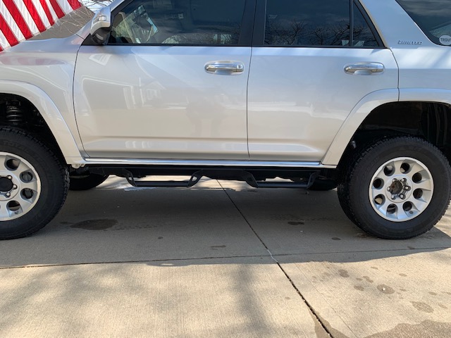

So far..
Blacked out most chrome with plastidip/wrap
Tinted windows
17" TRD Pro wheels with 265/70/17 KO2
Bug deflector/window visors
RAV4 mirrors
aFe intake
Thule aeroblade crossbars

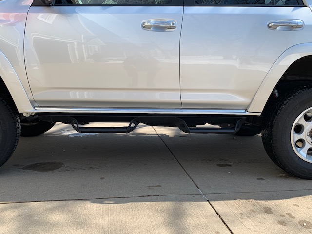

I recently completed the rocker panel mod. Thank you [MENTION=65614]Antman[/MENTION] for your instructions. They helped me a lot. I have more pictures of the process that I can post later if anyone is interested.

All of the chrome on the grille was dipped, as we're the emblems. Wrapping would be tough especially around the fogs like you said. I used wrap for the chrome on the sides (by the windows and at the bottom). As far as the emblem on the back, I think the dip is your best bet.
