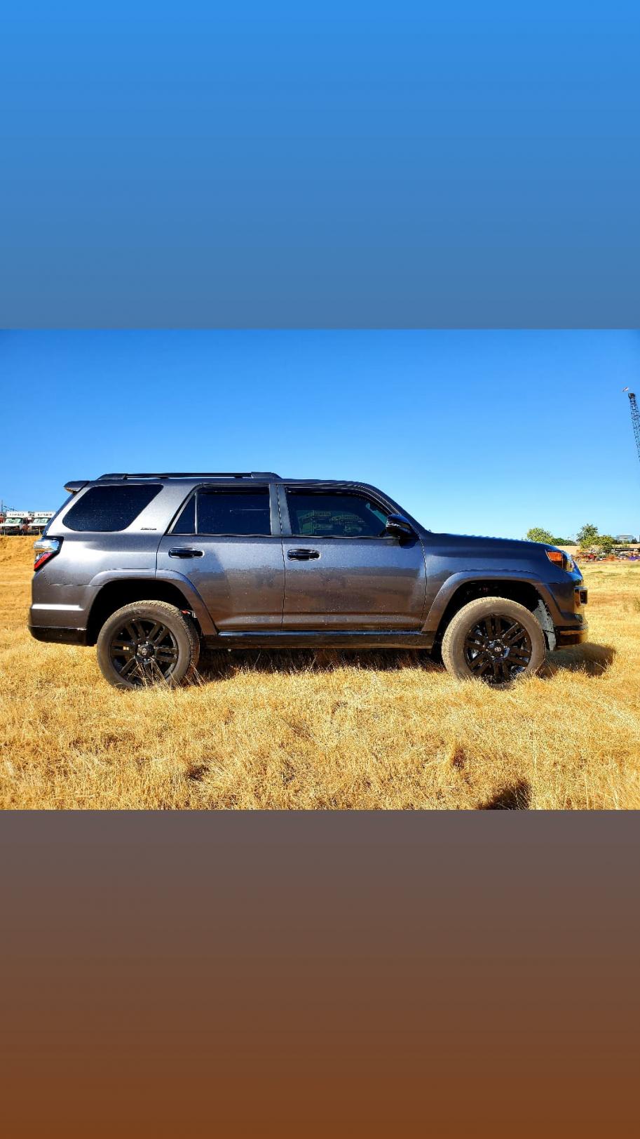

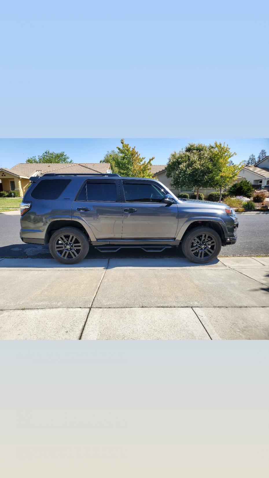

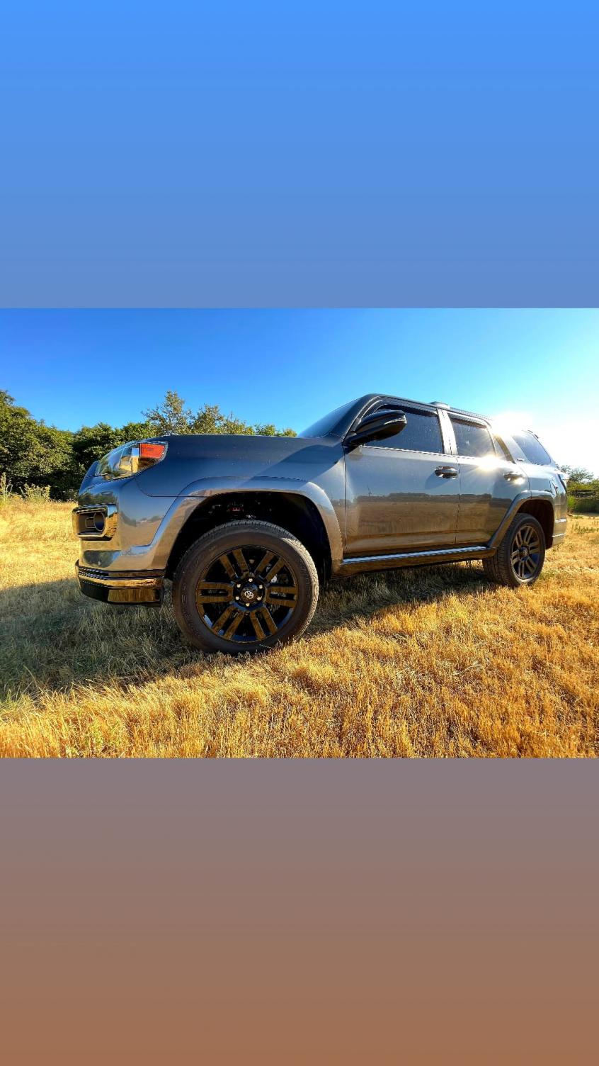

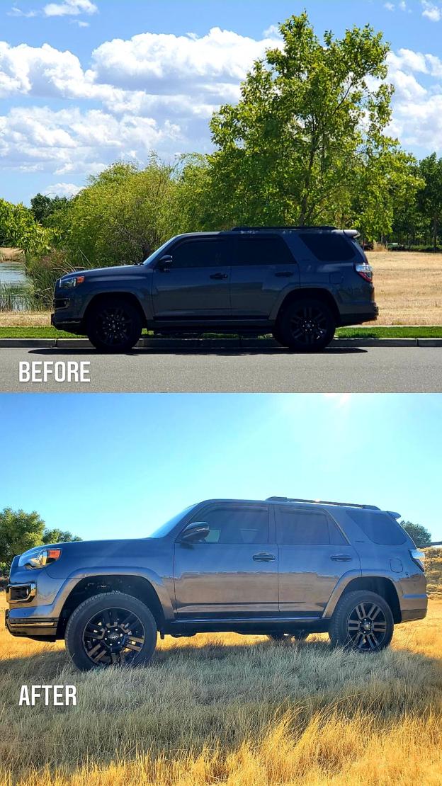

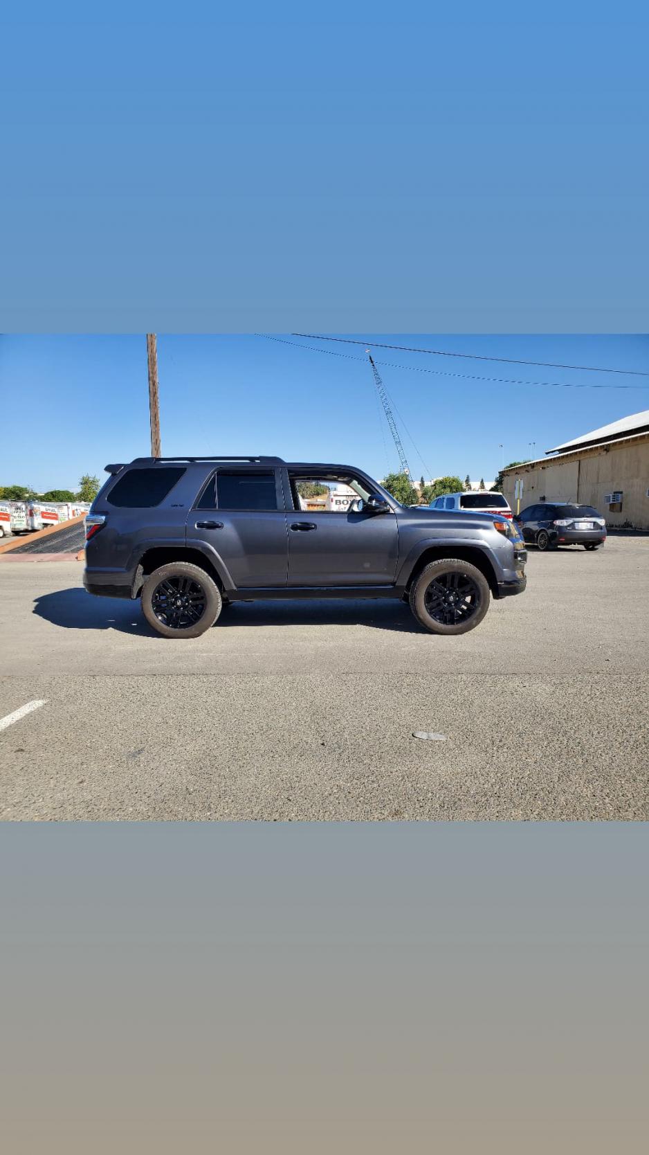

New to the group and T4R fam, just got a '20 nightshade LE back in September. So far all I've done is tint, clear bra, and now a leveling kit but I'm in love with it! Waiting on my Gobi stealth rack that will come in next year... now thinking about TRD pro rims and swapping out the grille for a TRD pro grille. I can't find anywhere to buy the TRD pro grille that fits my LE.
Leveling kit: Rough Country 2" Lift Kit for X-reas

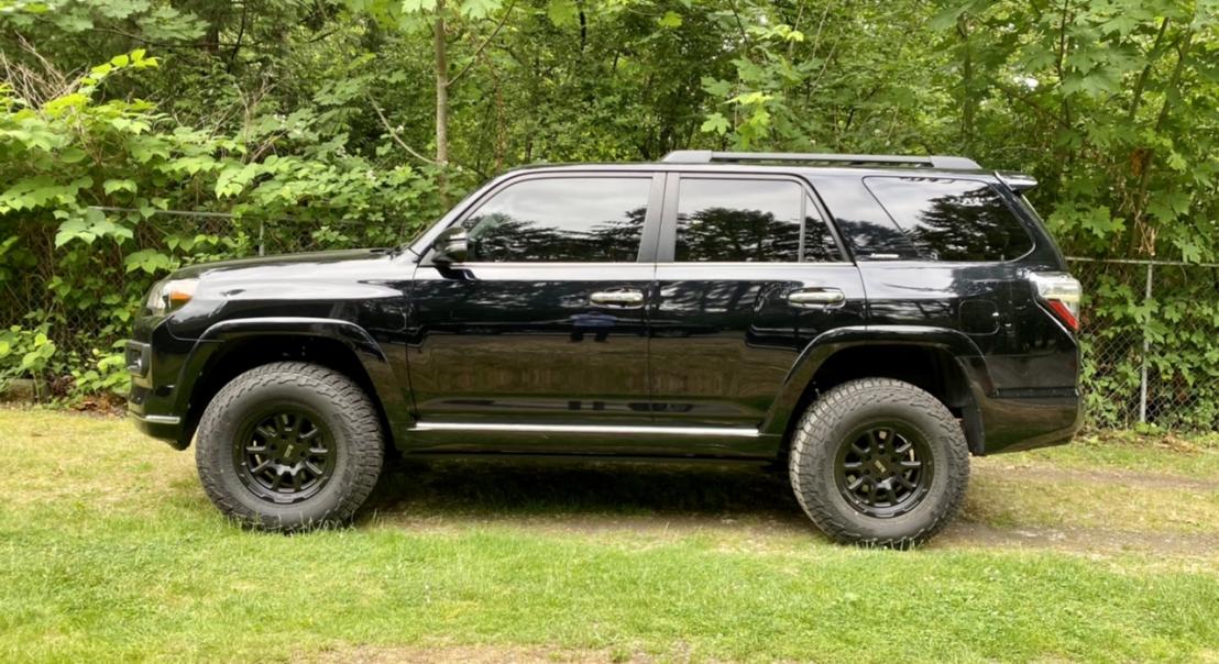

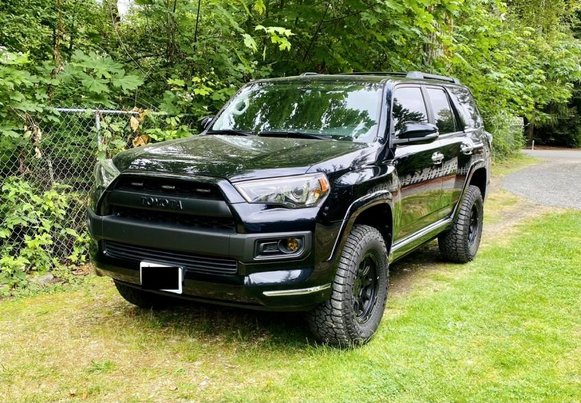

The current state of things. I think I’m going to slow down with the tinkering for a while now.
