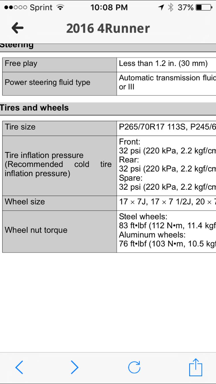

While rotating my tires today, I stumbled upon an interesting issue in the FSM.
One section of the FSM calls for a torque value of: 97 ft-lbf
Another section of the FSM calls for a torque value of: 83 ft-lbf
And finally the owner's manual calls for a torque value of: 81 ft-lbf
To the lay person like me, it seems like ~97 ft-lbf might be a bit overkill since the studs don't really look any thicker than passenger car studs? I recall most of my hondas and toyotas with similar diameter studs being ~80ish ft-lbf...
Personally I've always torqued my lug nuts to ~84 ft-lbf on the 4runner and called it good, but I'm curious about how tight you guys like to twist yo nuts?
According to my manual based on steel or aluminum wheels.

I got new tires a few weeks ago and happened to notice on my invoice that they torqued my alloys to 85 ft lbs. Do I bother re-torquing to the manual recommended 76 ft lbs or just leave it at the shop tightened ~85 ft lbs? I read through this thread but still not sure sure if + ~10 ft lbs is going to be considered "too tight" for the alloys even though it seems that in the past the recommended torque was higher.
Also I'm aware that my uncalibrated torque wrench might put me near the same value as what the lugs are currently set at lol :eyebrows:
Just leave it.
