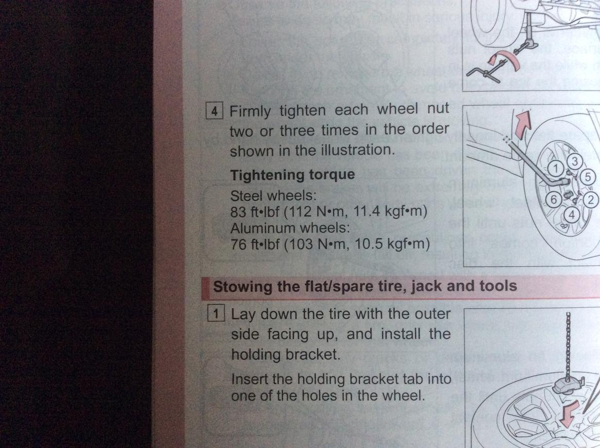

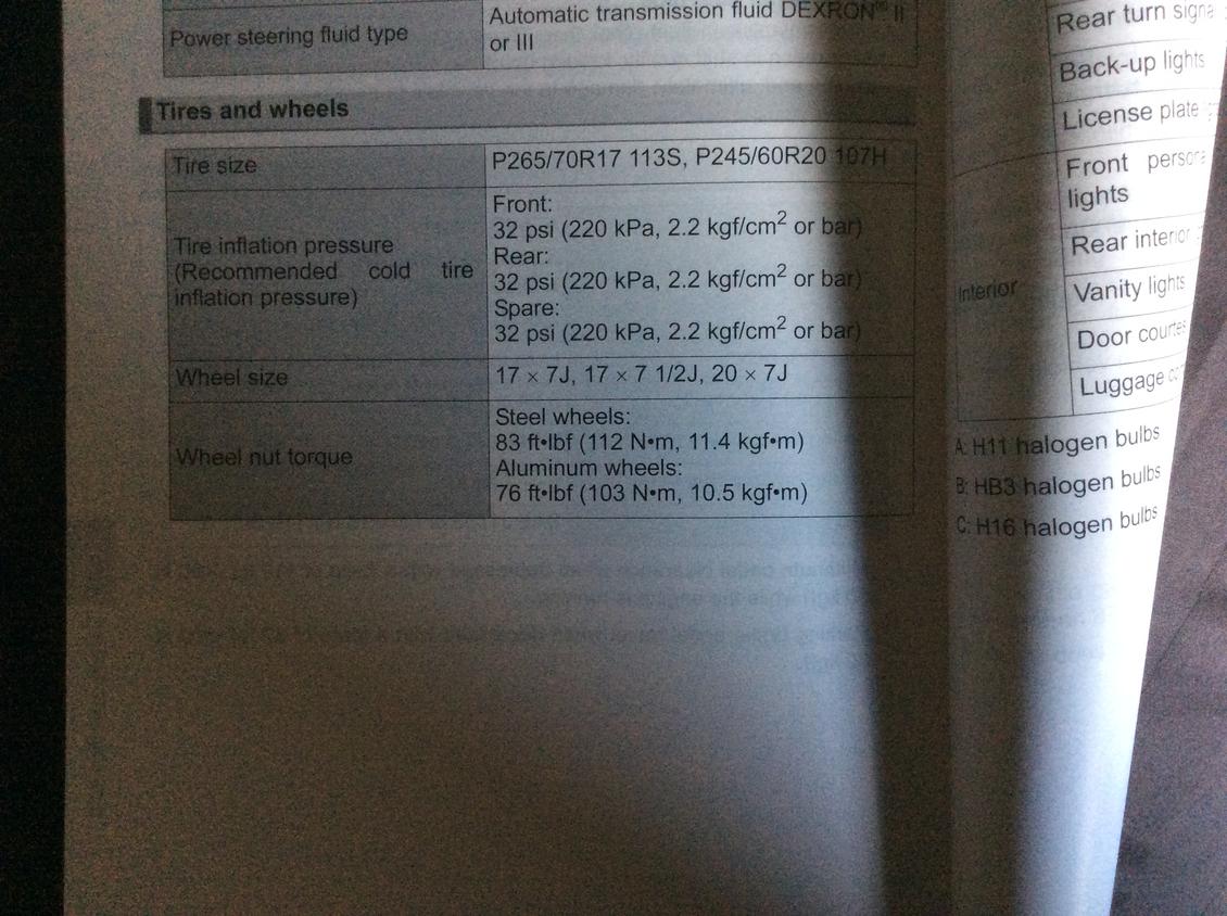

While rotating my tires today, I stumbled upon an interesting issue in the FSM.
One section of the FSM calls for a torque value of: 97 ft-lbf
Another section of the FSM calls for a torque value of: 83 ft-lbf
And finally the owner's manual calls for a torque value of: 81 ft-lbf
To the lay person like me, it seems like ~97 ft-lbf might be a bit overkill since the studs don't really look any thicker than passenger car studs? I recall most of my hondas and toyotas with similar diameter studs being ~80ish ft-lbf...
Personally I've always torqued my lug nuts to ~84 ft-lbf on the 4runner and called it good, but I'm curious about how tight you guys like to twist yo nuts?

81
My owner's manual shows 81. I checked after my last two free rotations from the dealer to find a few too loose and a few very tight.
