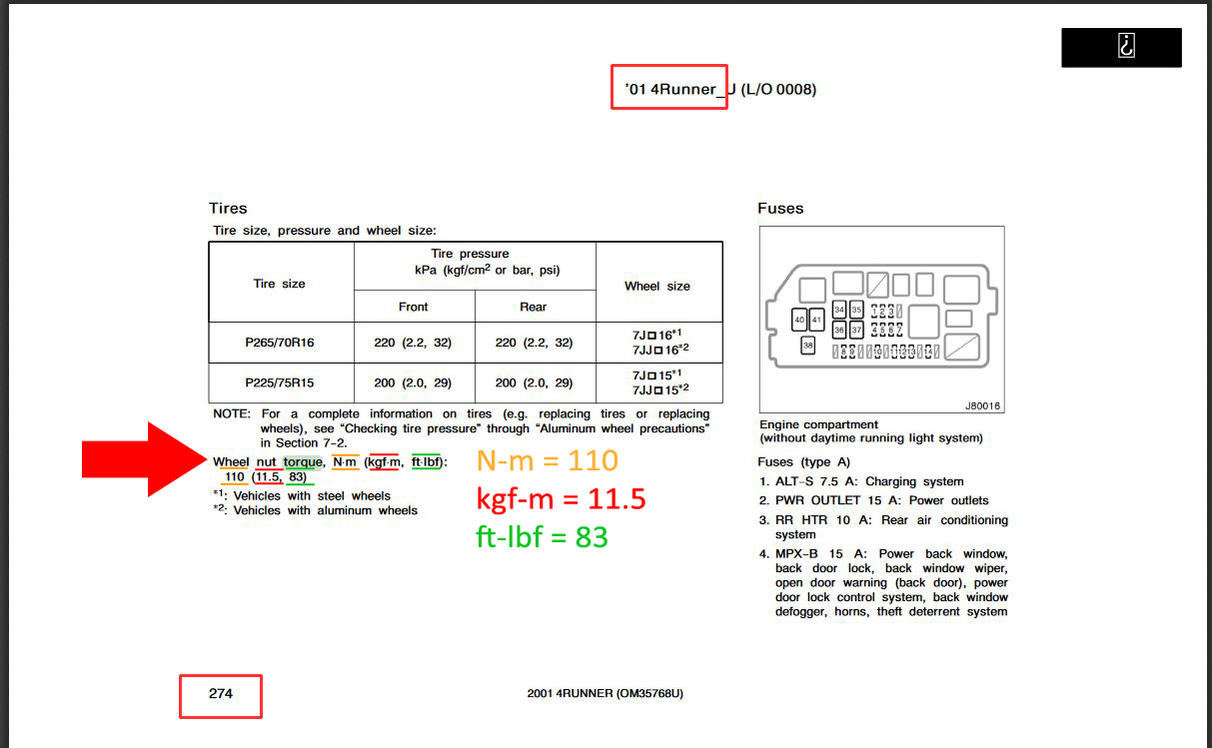

While rotating my tires today, I stumbled upon an interesting issue in the FSM.
One section of the FSM calls for a torque value of: 97 ft-lbf
Another section of the FSM calls for a torque value of: 83 ft-lbf
And finally the owner's manual calls for a torque value of: 81 ft-lbf
To the lay person like me, it seems like ~97 ft-lbf might be a bit overkill since the studs don't really look any thicker than passenger car studs? I recall most of my hondas and toyotas with similar diameter studs being ~80ish ft-lbf...
Personally I've always torqued my lug nuts to ~84 ft-lbf on the 4runner and called it good, but I'm curious about how tight you guys like to twist yo nuts?

FSM for my '01 4Runner Alloy Wheels says 83ft lbs.
