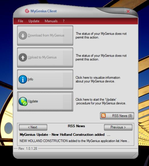

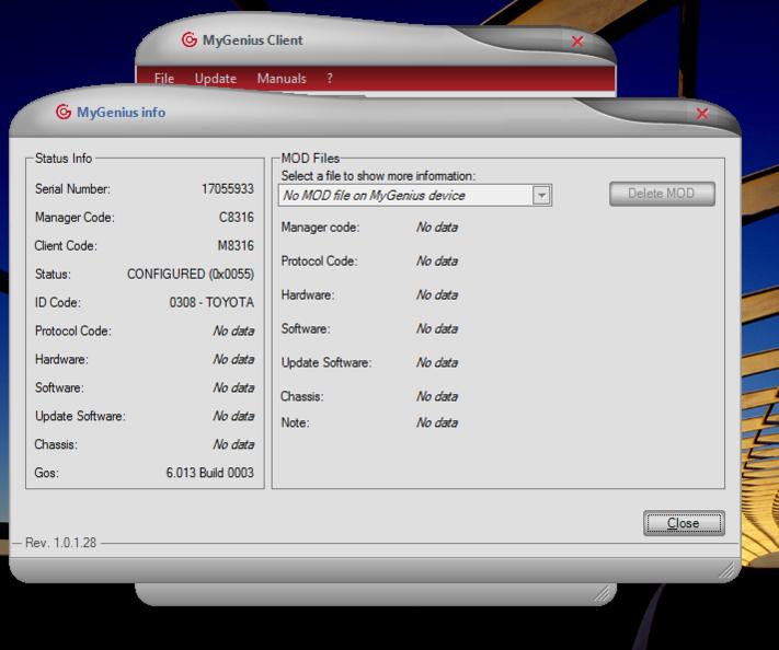

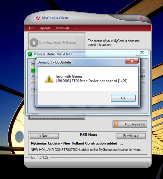

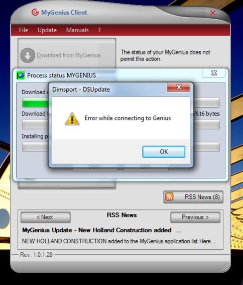

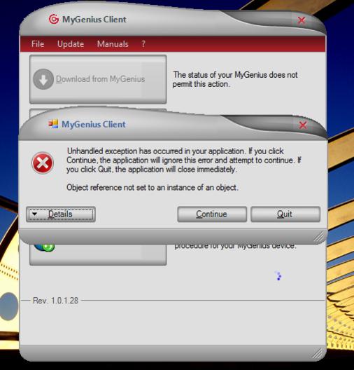

I think something is wrong with the handheld. I've tried installing and updating everything on another computer I have with the same results. Did this several times also.
Its quite frustrating that I can't get someone to call me from magnuson, but they only want to communicate through emails. I sent them another email with the above pics.

Yea, sounds like there is either a problem with your computer or the hand held itself. It should be able to communicate and upgrade the firmware via the last button in your pic. It gets complicated with drivers, different versions of Windows and all that going on.
I had no issues, but I know that does not help you. I would poke around in device manager and see if it shows any errors....

I installed the software on a windows 7 computer and one with windows 10 no difference. I did get a email back from mag that wants me to send the ecu and handheld to them.
I replied back asking to speak with someone on the phone before I do this. I'd honestly like to try a different programmer first before I send the ecu to them partly with me being in hawaii. Yes, I can overnight it and mag will pay for it, but still.
When you first plugged in the handheld on your computer are the download and upload buttons able to be clicked or were they also grayed out saying "The status of mygenius does not permit this action"

I think the buttons were disabled.. But I was able to connect and upgrade the firmware.
After I downloaded my file, the appropriate buttons were enabled.

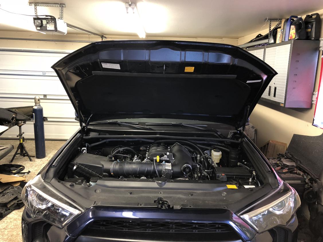

Got everything finished. Now just gotta wait until end of the week for my ecu to get back from magnuson.
