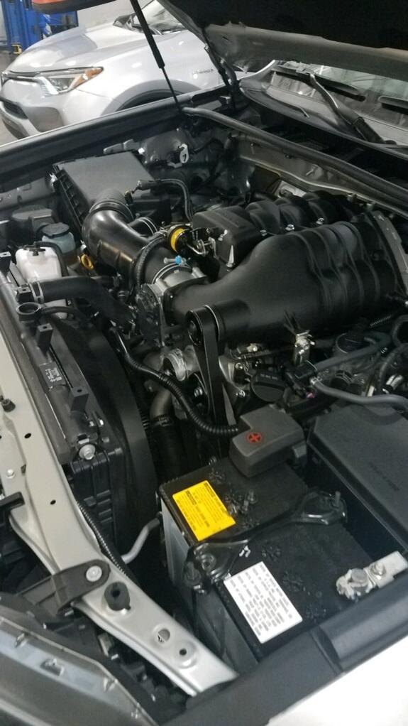

I should be able to tell next week when I get delivery :)
It's on an new 2018 LE and the dealership is finishing it up today and then they are putting on my lift (keeping stock tire size and it's only a 2/1.5 mild lift).
I will agree with others that have an S/C...I don't plan on tramping on it from a stop. I had a 2011 Tacoma with the TRD S/C and it became the truck that I should have kept... I never stomped on that one from a dead stop either, nor did I go deep into the throttle during a shift. Hoping this setup exceeds my expectations because my 2011 was really great and I kick myself for not keeping it.
