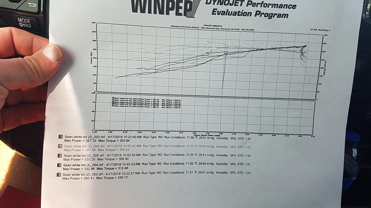

Still no solid dyno on paper, other than the one I saw from Magnuson... Can I see some more lines please.

I totally agree with what you are saying, dyno numbers are only worthwhile for the same car on the same dyno with similar weather (temp, humidity, etc.) with before and after results. That is so you can compare the delta. The truth is looking at someone else's "after" dyno doesn't really tell you anything.
Looking at that graph, one does have to wonder why there is so much variation in just a few minutes. Did this include tuning between runs? The total difference between run 2 and run 6 are +47.07 HP and -33.3 lbs/ft. If there was tuning involved, I think I would want to go back to the tune that was on during run 4. There you are looking at a difference of +52.45 HP and -26.25 lbs/ft.
Look at the chart. Run 6 was some kind of error and abruptly stopped at 4500rpm, which is why the very low HP number. If you look at the timestamps, run 6 was actually the 1st run
Run 6 was the last run actually according to the time stamp. Run 2 was at 10:22 AM and run 6 was at 10:53 AM. I can't really tell the graphs lines apart from this picture so I'm not sure which run had the weird loop in it.
BTW, they aren't in order. You have to look at the file name.

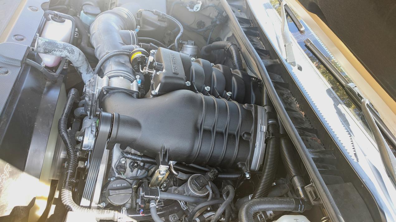

I've had my kit installed for a couple months now. Overall very happy with the large bump in power. It is significant but also won't quite take your breath away. There are a couple of downsides that bug me, one is likely fixable, the other not. When accelerating really hard from a stop, it is fairly easy to have the ECU react to exceeding a transmission torque limit and cut power. It is quite dramatic. It feels like the throttle get simply disconnected from the pedal. You drop to very low power output for a significant period of time. No, "drag racing" type activities are not the norm for me nor why I bought the kit. That said, I had no idea this could be an outcome of the kit. It is surprising that the protection of the transmission seems so conservative. AFAIK, there is no easy (or probably safe/advisable) fix for this.
Secondly, in hotter temps (San Diego, inland So Cal) and typically when stuck in stop and go traffic, I experience a rough and slightly wandering idle. Magnusson said to take it to the shop that did the install for some "logging". I need to have my mechanic get some dialog going with a Magnuson tech.
Anyone else experience and/or resolve either of these issues?

I don’t know about the other issues, but your first one sounds like you just need to turn the nannies off prior to driving wot. My tundra will do that a lot of I don’t turn off the nannies (which I do every time I drive it).

I have the same first issue but haven't experienced the heat issue. I just don't drive it enough, especially in traffic to have noticed so I'm not saying I don't have that issue, I just haven't noticed it yet.
Unfortunately, nannies have nothing to do with it. I have this same issue and so does everyone else with this kit. I spoke to Magnuson about this and they told me it has to do with programming Toyota has in the ECU that they cannot modify. It is a setting that cuts torque to prolong the transmissions life and cannot be removed or removed.
Havik; Unfortunately said:
Understood. Then it’s the torque management. The Tundra just started getting tuning support to remove or dial the TM back. It’s certianly been a hindrance.
I talked to Dustin @ DAP a while back about tuning. He was very optimistic about it l, but has zero time to work on it. Hopefully someone else will step up....
My 4R will remain N/a for now :(
no issue with my URD kit. WOT at stop, and it goes..
The issue with first gear is torque mgt in the ECU trying to protect the drive-line for longevity it kills timing and closes the throttle when it thinks too much multiplied tq is being applied. Similar thing happens on shifts. I've only seen it in first gear.. maybe a tad in second.
I would not say it is impossible to calibrate out or dial back... but they are not going to want to remove it for obvious reasons. It should in theory keep the drive line together. It bothered me at first when I was just playing with the truck being stupid. In real driving situations it never comes up for me.
Rough idle is something I have never experienced even in 110* traffic.
No, my post must have just missed your post. Magnuson told me it is a setting in the ECU that can't be modified. Unfortunately, it affects all 4Runners.
something i've been thinking about.
URD kit has upgraded fuel pump. says not to WOT below 25% fuel due to chance of lean out conditions. Is everyone sure it isn't magnuson programming that is choking?
I would think that at WOT from a stop, there is a good chance the SC will be asking for more fuel then stock fuel pump can provide.
100% sure that is not the issue. It can be seen on logs. AF is perfect. Throttle closes timing goes to nothing. No knock....
Now can the fuel pump go lean in some scenarios... possible. But what they are experiencing is torque management.
Fuel pump changes are a double edge sword.. you often end up with pickup and cativation issues on low tank conditions. There is always give and take with each modification. Hot fuel is also a big factor. The more you pump the hotter the fuel gets. It's complicated for sure. I think a pump booster might be a smarter solution.. but not sure if the Toyota pumps run at constant voltage or not.
The engine typically has less load in lower gears BTW...Max load and fuel demands will be in 4th gear. But the driveline sees the most stress in first gear from torque multiplication.
I would guess the URD piggyback would eliminate torque management by ignoring the ECU signals. But you have to wonder how it manages shifts and protects the driveline in other scenarios. Shifts are a big deal. so hopefully they got something for that, otherwise the transmission is not going to last.
