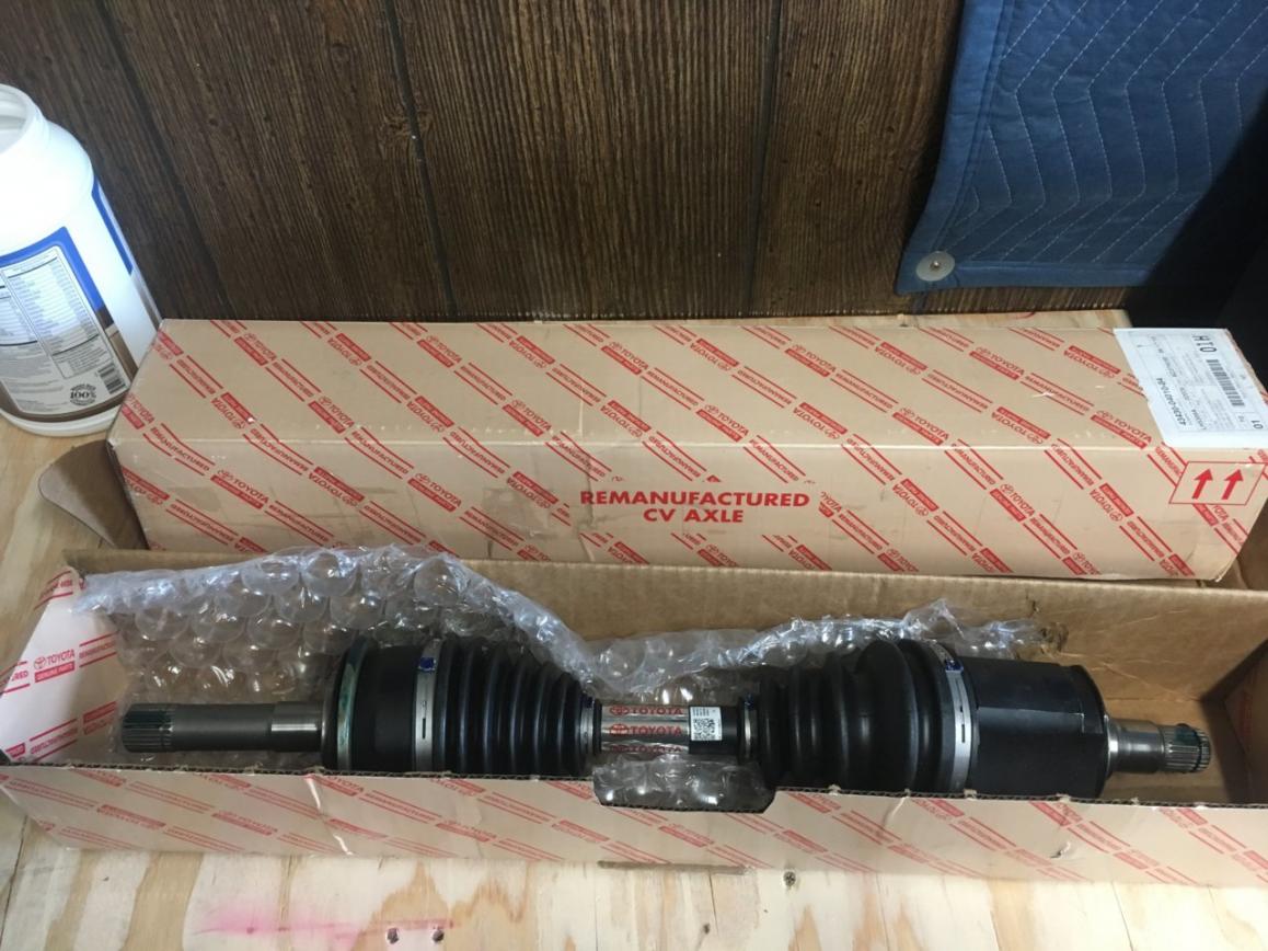

Now I'm re-committed to manual hubs. I'm in the middle of regearing to 4:88's with Harrops front and rear, when I'm done with that I've got reman OEM CV axles and a Sonoran Steel diff drop ready to go in, and 255/85r16s ordered. Thanks everyone for your input!
They're beautiful...
