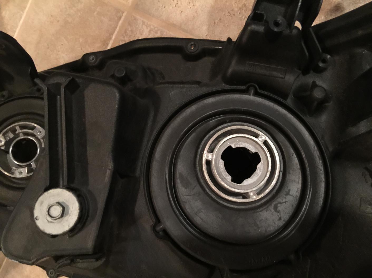

Yes I have.
You'll have to drimmel the hole out to make the ID much larger, then shave the rear shank off so you can get enough threads out to get the lock ring on.

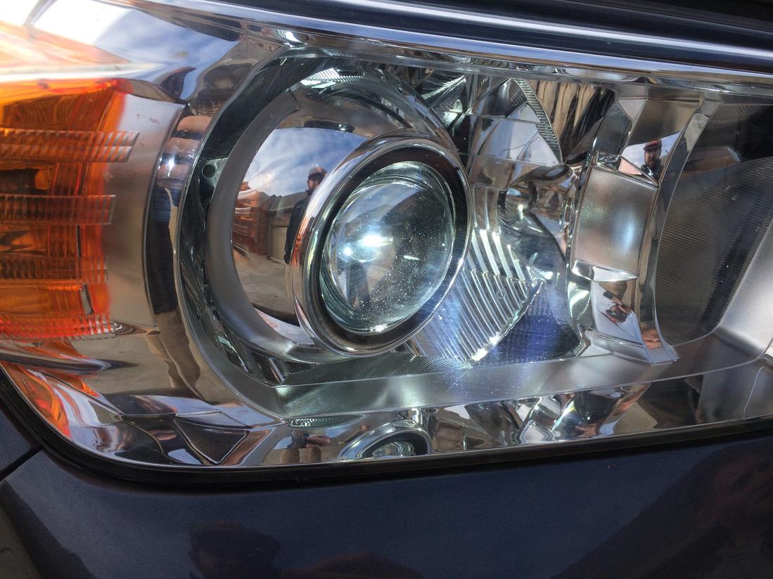

Yeah, I've done a bunch of retrofits to tacoma headlights(D2s mini and FX-Rs). I just wanted to get a game plan going before I tackle the retrofit. I did a set on a 3rd gen last week and we had to shave off some to make every thing fit and just wanted to see if it was similar.
I needed to carve out the back of my reflectors by 1/2" or so around the bulb socket and then cut in a new key way.
I'm in the process of cutting, so from what I understand I have to bore out the inside and shave down the lip?
I had to take mine down to the red line
image_zps5215e4f3.jpg~original
Thanks! That's what I figured. Does the lremauning lip after the red need to be trimed or will I be good with just removing up to the leer line? Also how did you align them since there is no tab for the T washer?
IIRC, I had to take out about half of the thickness of the raised rim bit, and then I cut a key way at 6 o'clock (bottom) for the alignment washer
