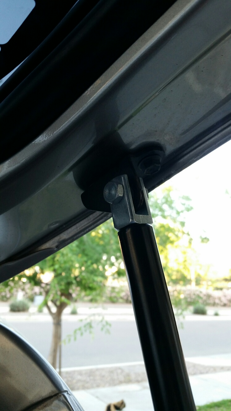

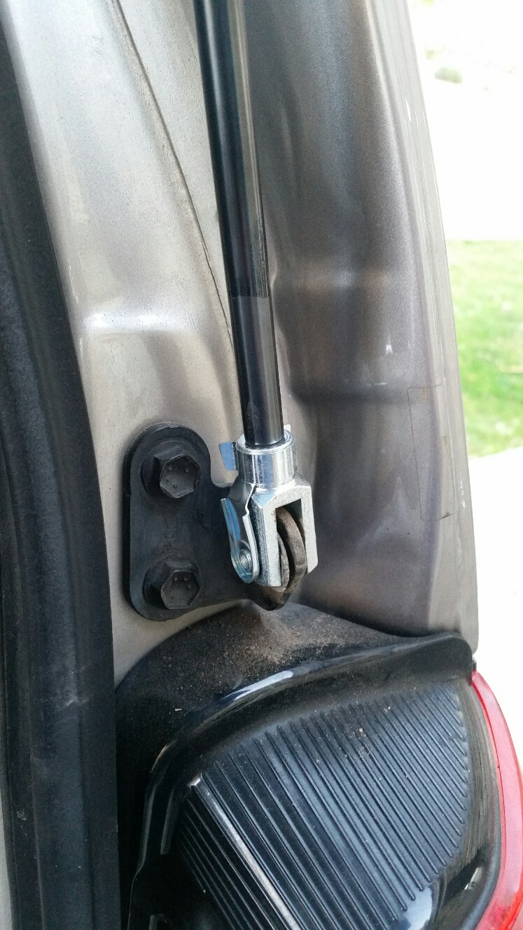

Installed new lift gate struts in both 4runners today. The old ones would hold the back open if you lifted by hand... but in winter, it would fall on your head.
http://www.amazon.com/4286-1996-2002-Liftgate-Lift-Supports/dp/B00SHZK0EQ?ie=UTF8&keywords=4286%20toyota%204runner&qid=1458917374&ref_=sr_1_1&sr=8-1
Total cost was $28 shipped per pair.
Pros:
- Dirt cheap! I could buy quite a few of these sets vs a single OEM set
- Good reviews
- limited lifetime warranty
- Plenty of lifting force. Rear gate actually lifts itself once you start to open it
- Will lift the gate even with the rear window down
Cons:
- Included hardware is cheap / zinc coated steel
- Lower install pin is nice / quick to install. Upper bolt attachment is a universal type fit that uses a bolt vs a pin. The con is... ugly and afraid it will rust after the zinc is worn through. Did I mention they were cheap and work? :reddance:

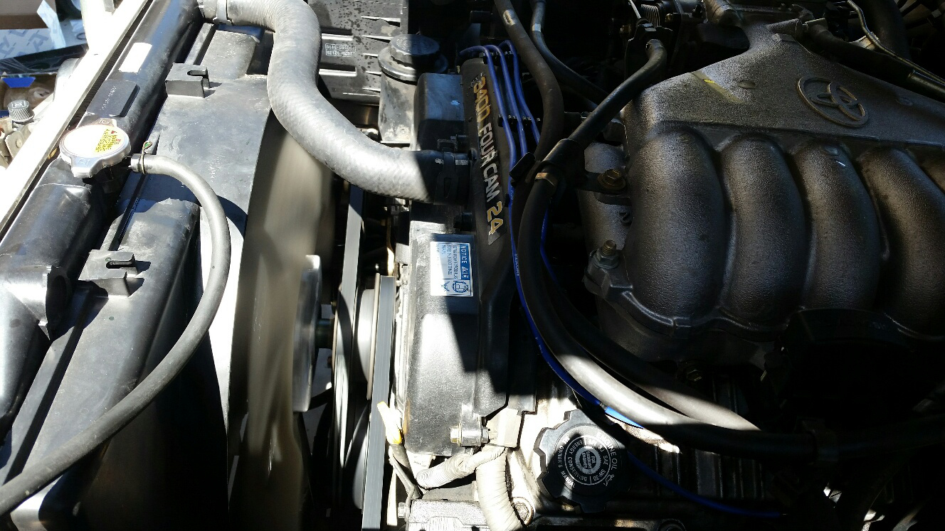

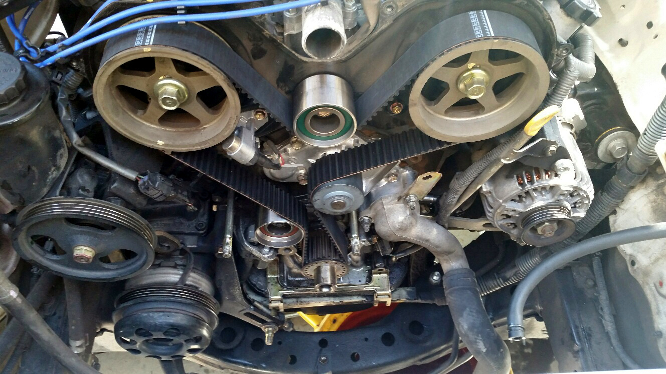

Knocked out the timing belt Saturday on the white gunner. Was not in a rush / 3.5 hours worth of work. All part numbers have been previously listed - but what was changed out for new during this process:
- Gates timing belt kit
- Gates belts
- WP, Tstat and rad cap (new rad a few K ago)
- Fan clutch + fan assembly (blade assembly)
- False waterpump / fan idler
- Crank pulley
- AC belt idler pulley

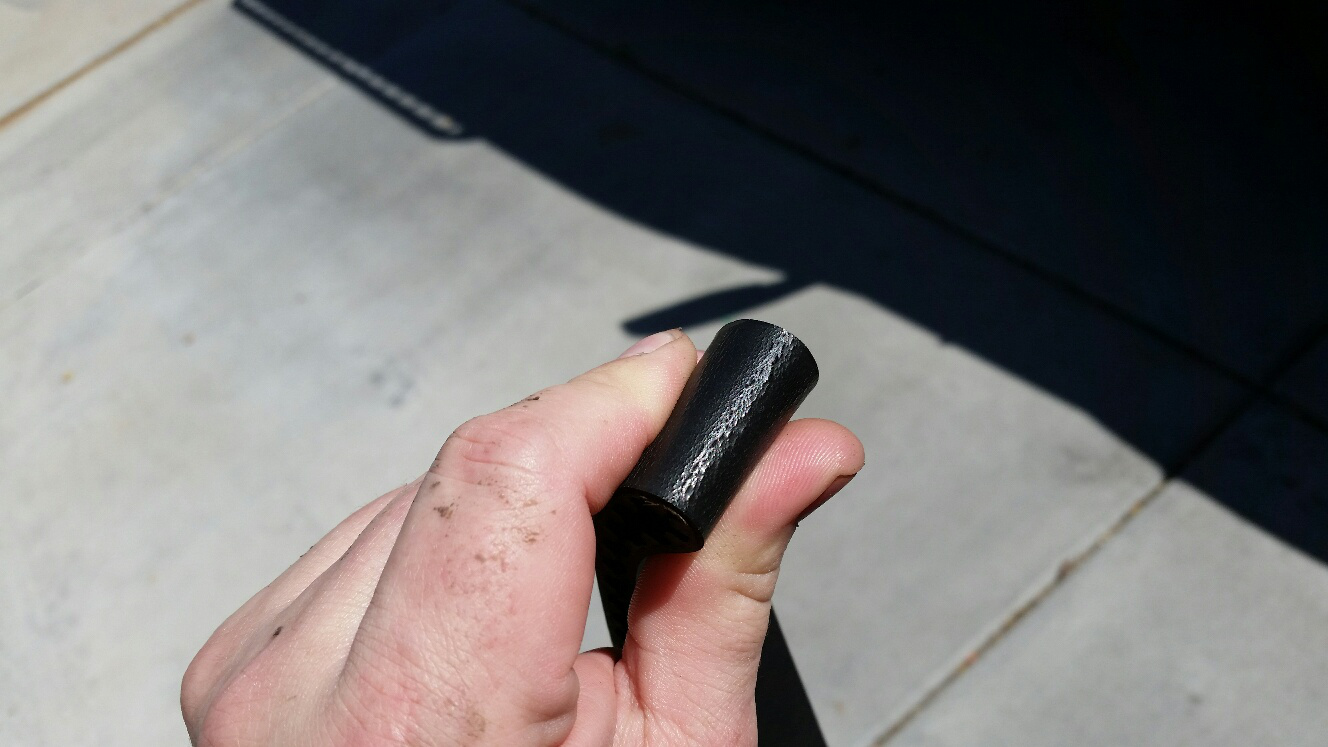

- Oil Dipstick o-ring
- Made sure to open all heater lines prior to draining coolant

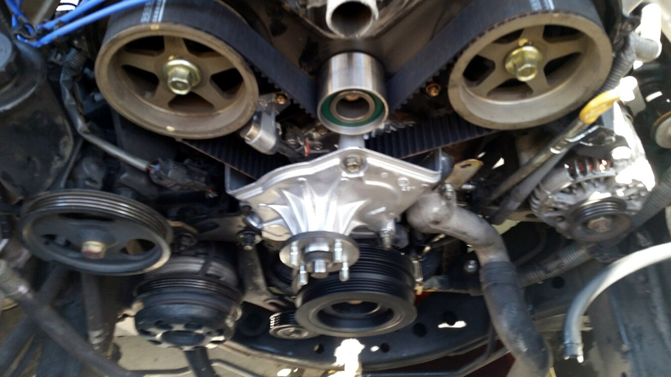

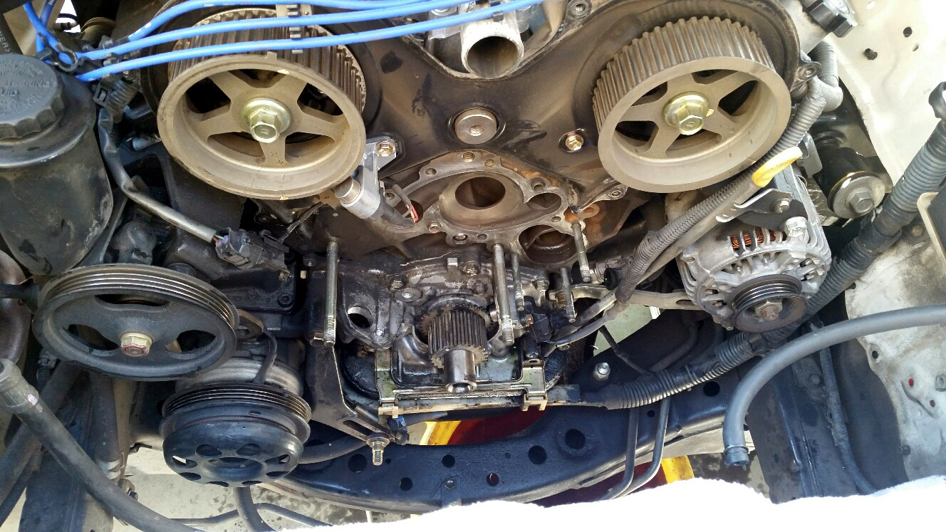

Just a couple random photos of the work.
Looks pretty dirty but most of the black was just belt material that had come off over time. And the oil dipstick o-ring was leaking / will clean that later.
New belt, WP and such in place.
Almost done. Can see the new pulley, false WP / Fan idler
Purring like a kitten - runs smooth as glass!
Old belt was definitely due. Starting to show surface cracks on the outside edge AND on the teeth of the belt, the kevlar or aramid fibers were starting to shred in a few place as the rubber hard worn off to the point it was getting down to them. Car was not at risk reliability wise YET, but I would not have trusted this belt more than 20K more miles at the most.

Now, I'm definitely on the newbie side of things, but I just finished rebuilding my heads and doing my TB/WP and associated bit, but I did not replace either my crank pulley, nor my fan clutch + assembly. I'm at 105xxx, is this something I should consider getting? I've used all OEM parts so far, and I wanted to do it right the first time. Engine sounds great, belts might need a little adjusting though.
Also, false water pump/fan idler?
Appreciated
At 105K, NO need to change out the fan clutch, crank pulley or fan idler (aka false WP). Those are more like 250K mile service items. Fan clutch can exceed that too but that is my personal limit on these items.
For most parts, buy Aisin brand (same as OEM toyota) such as water pumps, fan idlers, fan clutches. For belts, I use gates as they are simply excellent and meet or exceed OEM quality. Otherwise go OEM or Denso when possible.
Gotcha, thanks for the info.
And you're right, I could've done it cheaper and gotten the same quality of product. I just didn't know enough to make those choices, and for the layman it's hard to mess up if you just go OEM

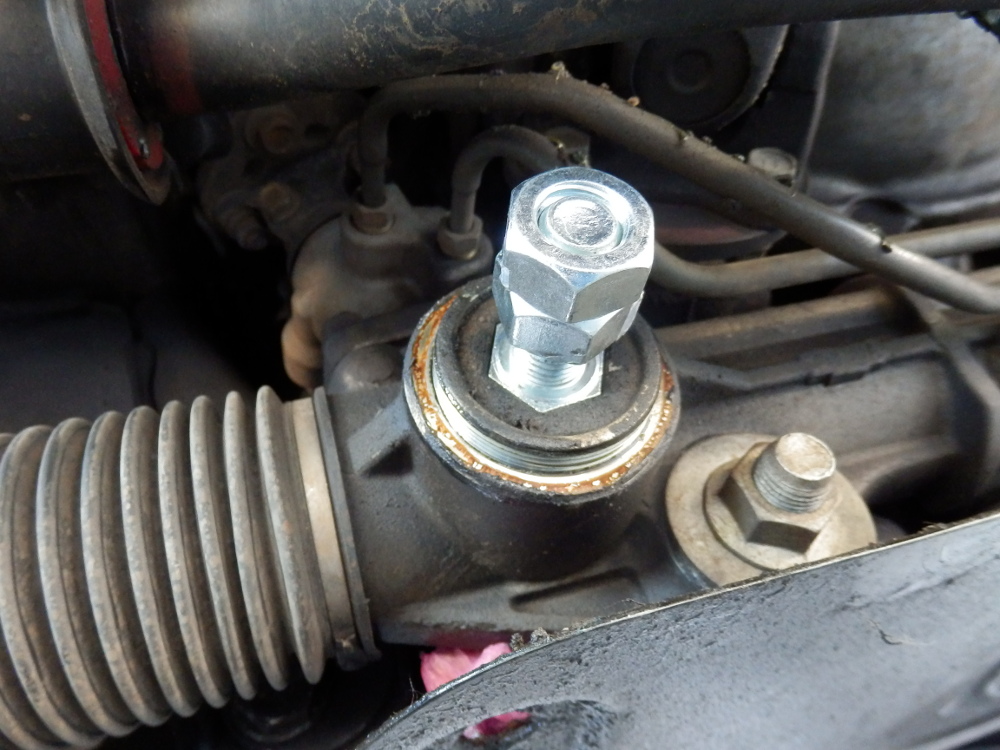

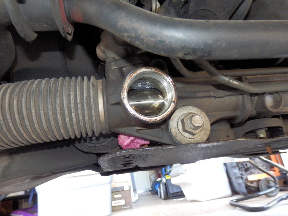

Post I made in the steering rack thread:
Wife is not home so I checked my guide bushing. All was excellent condition :)
Observations:
- I checked the default torque spec that my guide cap was sitting at by loosening the lock nut and setting my torque wrench to 18ft lbs as outlined. I was VERY surprised to find that I was able to rotate the threads well over a full turn, maybe more before reaching 18ft-lbs. This is on a rack that was not making any noise or having issues.
- I tried a second torque wrench to verify the spec and sure enough, 18ft lbs was very tight and bound the steering quite hard the further you turned the wheel. No chance of it returning to center.
- The rack bar is tapered to a centering point. This helps the rack return to center. So if you torque dead center at 18ft lbs, the spring is fully compressed. When you turn the wheel, the guide cannot back off and it binds. I did not try torquing to 18ft lbs when the wheel turned full lock one way or the other - then backing off as described, but I imagine it may work fine.
- When tightening the cap, you can feel when the cap makes contact with the spring and gets tighter and tighter. At a point, you will suddenly feel the back cap make contact with the guide - fully compressing the spring. This is WAY before 18ft lbs. At this point, I backed off 1/8 turn or maybe a tad more so I knew the cap / guide had a little bit of mechanical clearance.

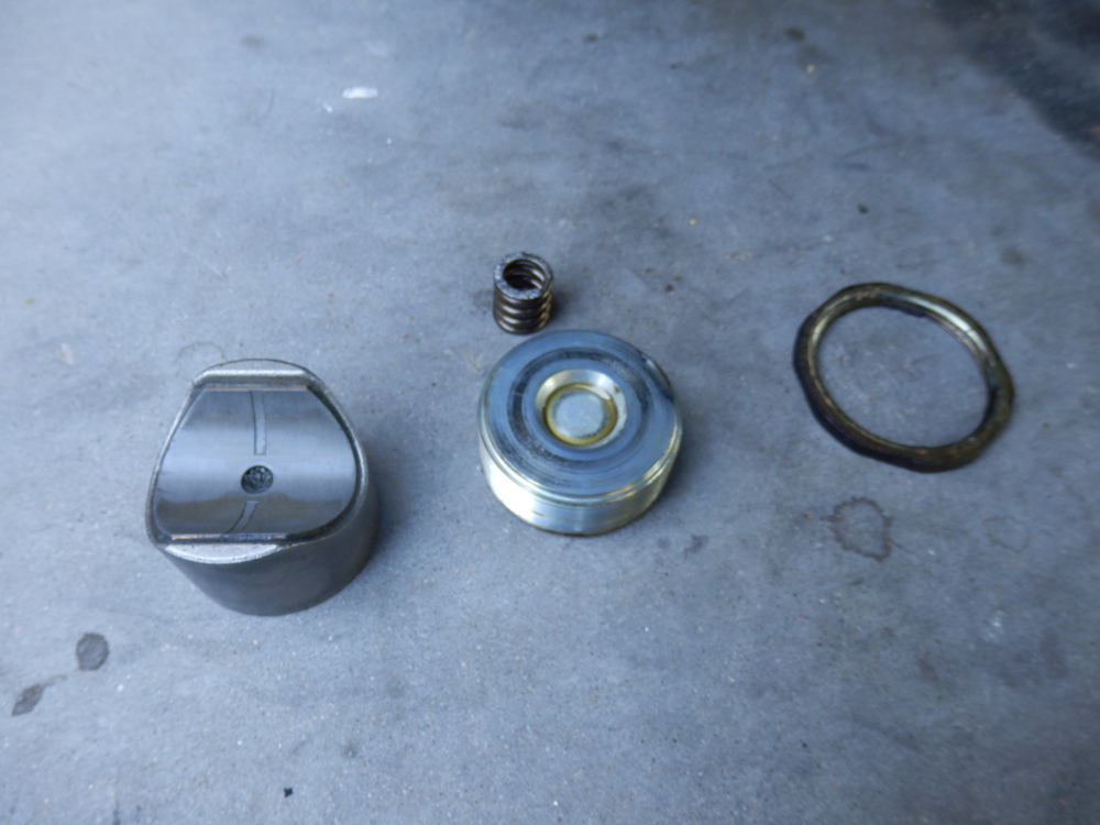

- At 240K miles on my 4runner, the guide had virtually ZERO wear. The actual mating surface is copper or brass with a coating, very similar to a crank or rod bearing. IMO with an 01-02, there is no need to buy replacement parts. I may change my opinion if I find wear in the wifes 02 tomorrow.
Jhelms quick instruction guide for the rack guide if you have an 01-02 or if you purchased the new style guide
- Turn the wheel 1/2-1 turn to the left (VERY IMPORTANT - DO NOT MAKE THE ADJUSTMENT WITH THE RACK CENTERED)
- Loosen the lock nut
- Use whatever tool you have to rotate the large hex cap clockwise until you feel it bind
- Back off of that setting 1/8 to 1/4 turn. This should get you on the money or close. Back off a little more if steering feels to tight
Oh... And the feel? Very nice and tight. Maybe a tad to much as the wheel is a little slow to return but I am good with it. Now I hope the clunk goes away with the wife's :)
My little ghetto tool made from an M16 bolt and two M16 nuts. Head is a perfect fit.
Guide Removed:
Guide at 240K miles:
Why do you want to turn the steering wheel a half to full turn to the left before making the adjustment to the guide cap? Just wondering because I didn't see it mentioned in any of the instructional threads.
Because there is a centering spot (low spot) in the metal on the rack. This helps keep the car pointed straight when the wheel is centered. If you torque and set with the wheel centered, when you try to turn the wheel, it will bind hard. If you turn the wheel and set things as I stated / it will be dead on the first time.
You will read in other posts about people having a hard time getting it right / binding / re-setting over and over. If they follow my guide - it is a 1st time setup.
