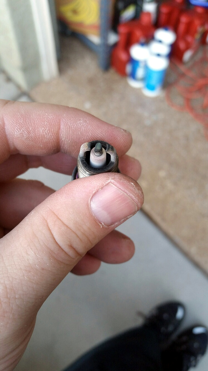

Changed the stock plugs and PCV on the silver gunner today. The stock plugs were shot at under 50K miles and also look to be running a little hot but just barely. Not bad at all actually. Changed them out for 1 step colder BKR6EIX-11 AND TE66 plug wires. Purrs like a kitten now :) Sorry friends, I am NOT a fan of stock dual ground plugs. They function fine, but I like to change my plugs every 100K miles - not at twice that rate. Even on a wasted spark system like our 5vzfe that eats plugs (reason for dual grounds / plug fires double the amount in wasted spark), iridium LASTS. And yes, it has been proven on the 5vzfe. Anyone that says different is just spilling what they have read over and over and does not have the facts. Had countless customers running a fine wire in these motors and also put a LOAD of miles on my own 98 limited running iridium / fine wire.
On another note, some tard face installed a generic PCV valve in the silver gunner and mixed up a vac line / pcv line that goes to the throttle body. Ran just fine but glad I caught it.
Old dead plug:

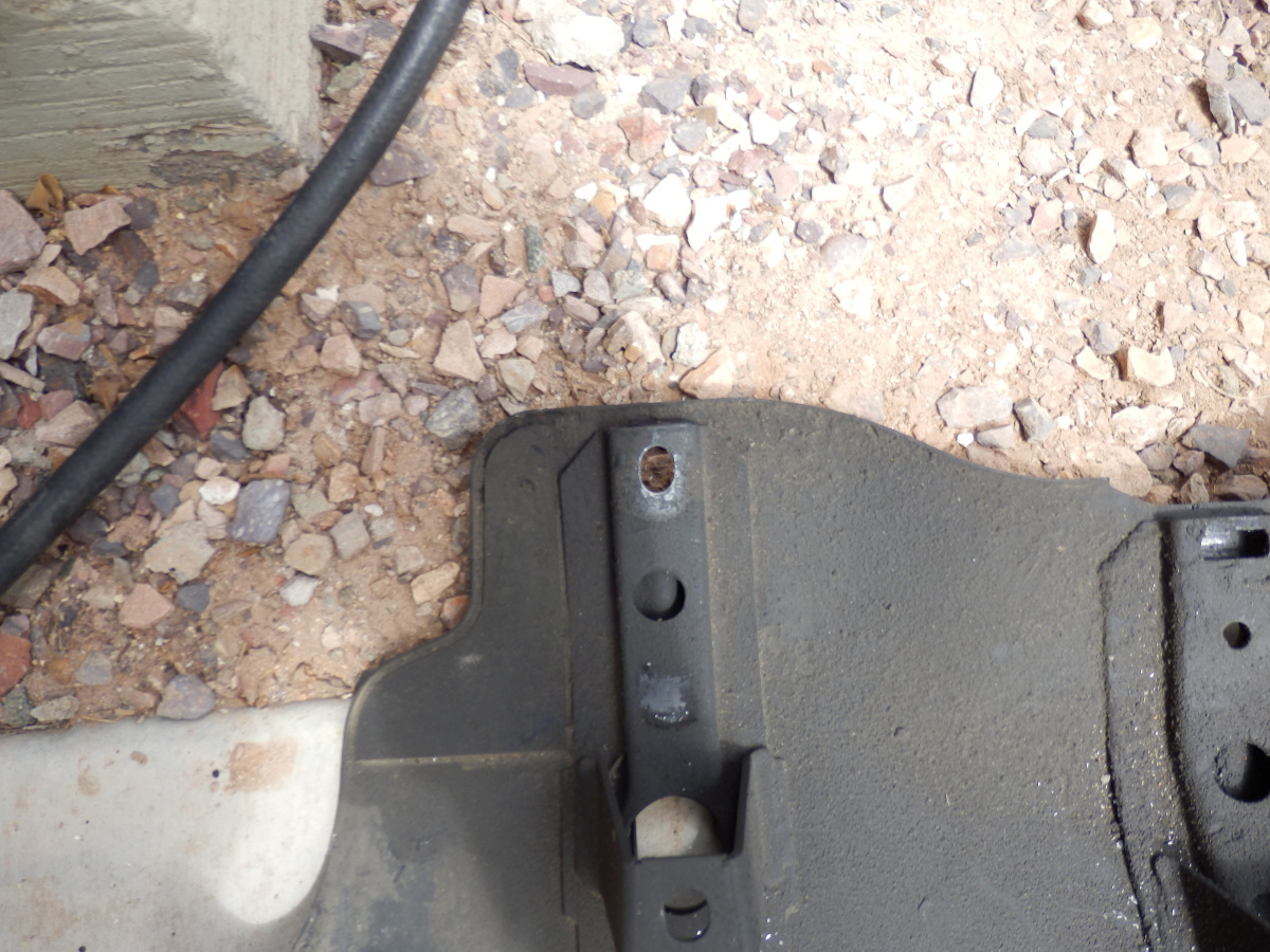

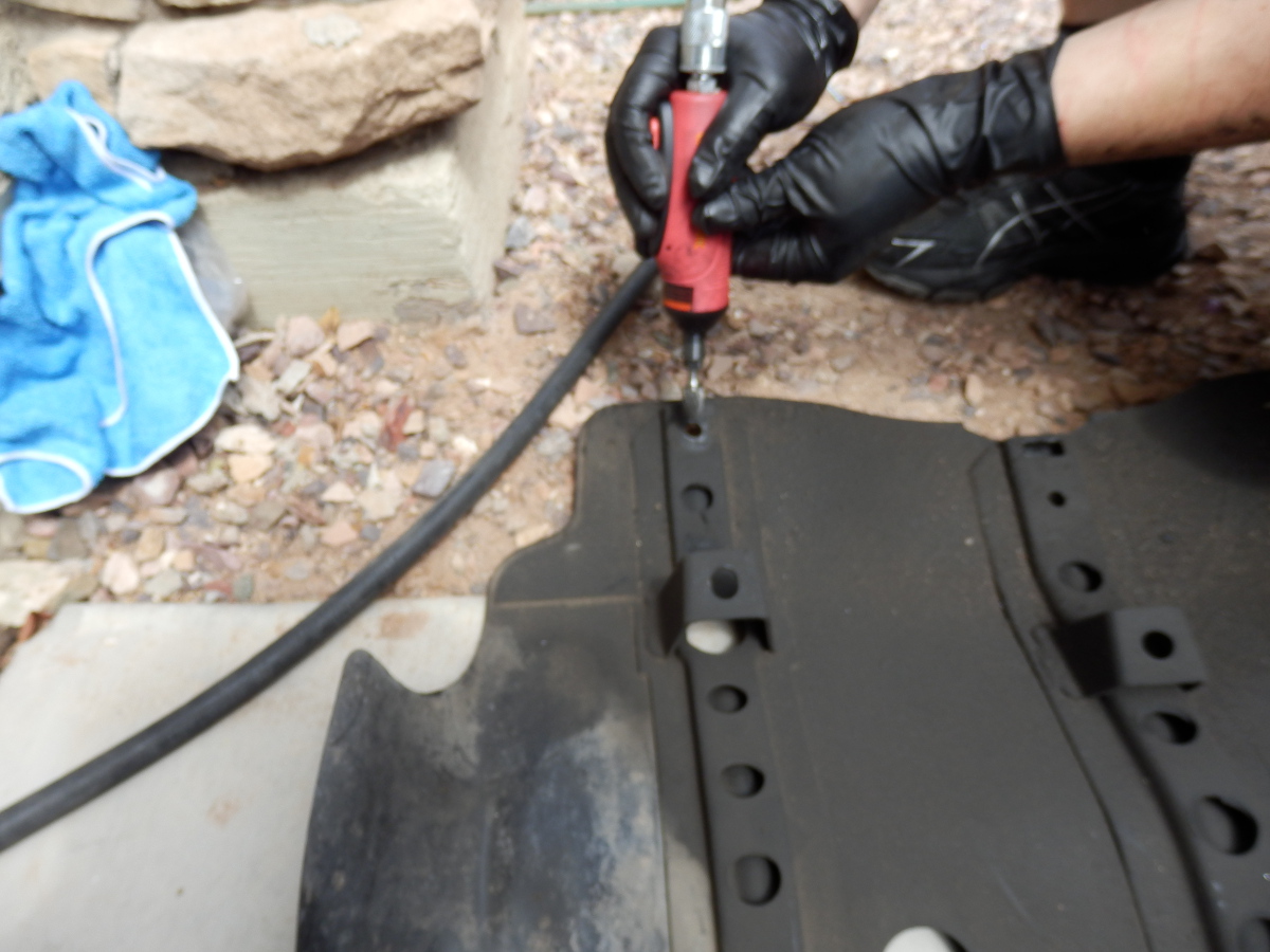

5. Use a carbide bur or file to elongate the bolt holes on the rear of the front skid plate
6. Install proper METRIC bolt / washer combo. My stock bolts went in fine and I did not need extended ones.
You can see the shiny aluminum 1" spacer here...
Blurry pic - youngest boy was my camera man today. Using a bur, I elongated the holes quick and easy.

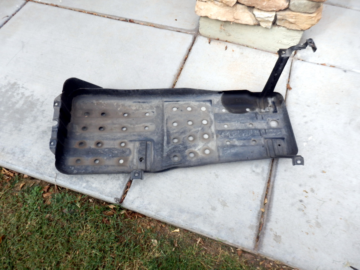

1. You need to get the gas tank skid plate off At the front of the gas tank, closest to the front of the car, you will see three 12mm bolts. Take out the outside two bolts only at this time. DO NOT TAKE OUT THE CENTER BOLT. Gas tank will likely smack ya in the face :)
2. Located all of the other bolts holding on the skid plate. Should be 3 more in total. The tall arm sticking up in the air, also holds a bunch of fuel lines and wires with a little clip. Yes it is a pain in the rear to get out and lower it.

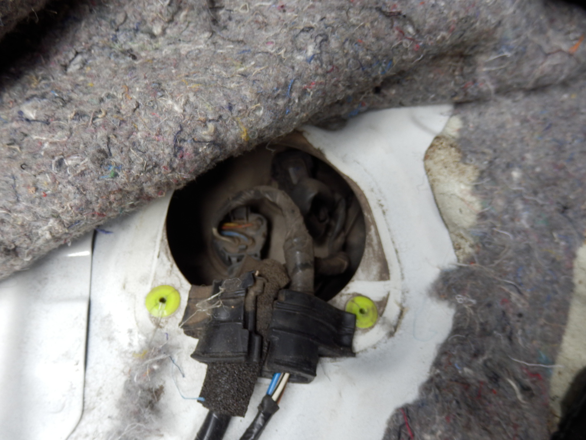

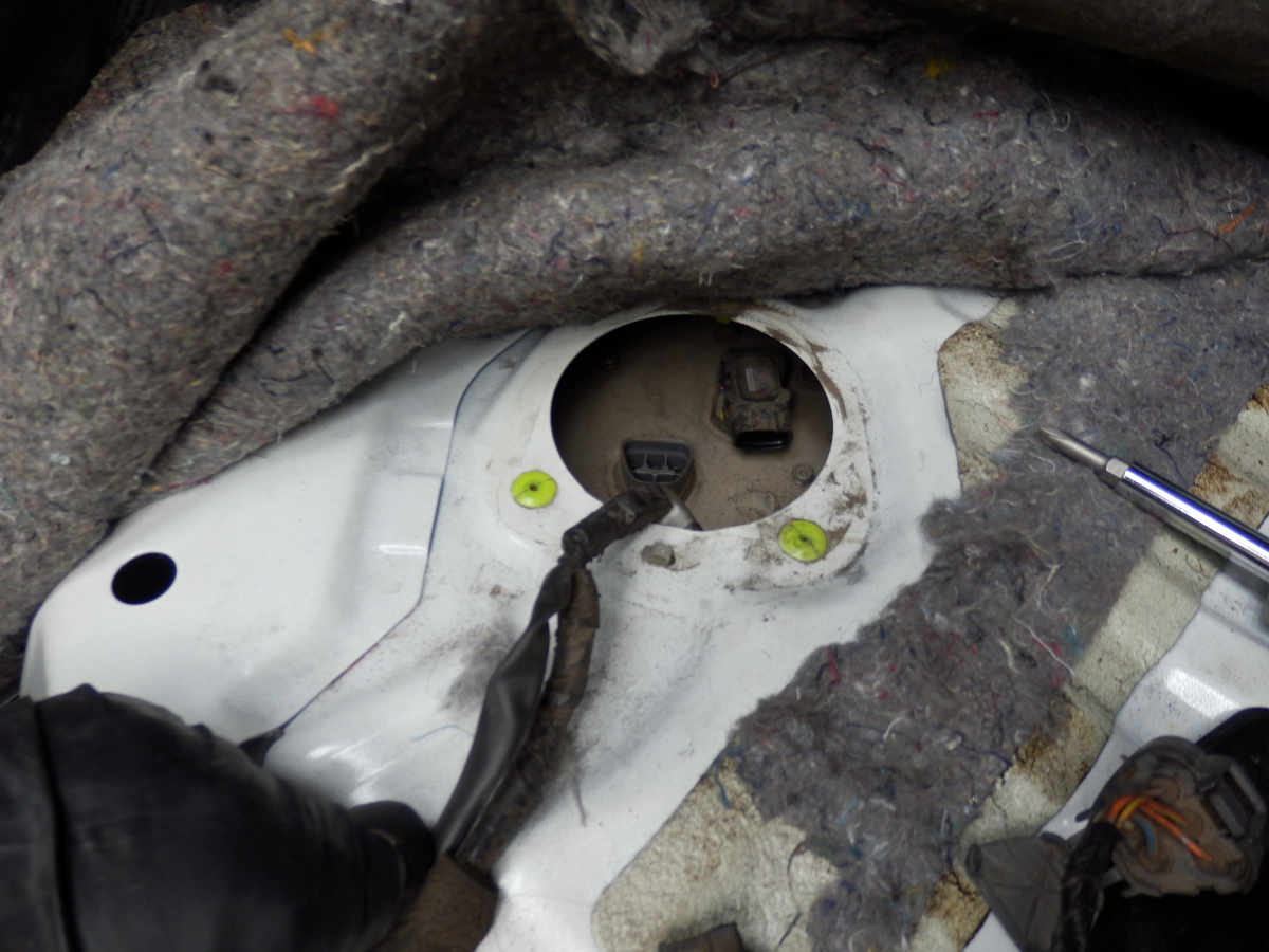

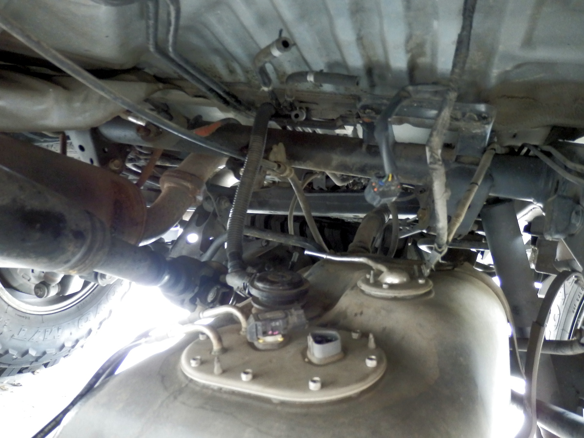

4. Under the drivers side, back seat... there will be a black cover with three phillips screws. Take them out and take the cover off to expose the fuel pump connections.
IMPORTANT: Once you take off the connections, set them aside and try to start the car. Let it keep cranking for a while if it does not start to relieve fuel pressure in the lines

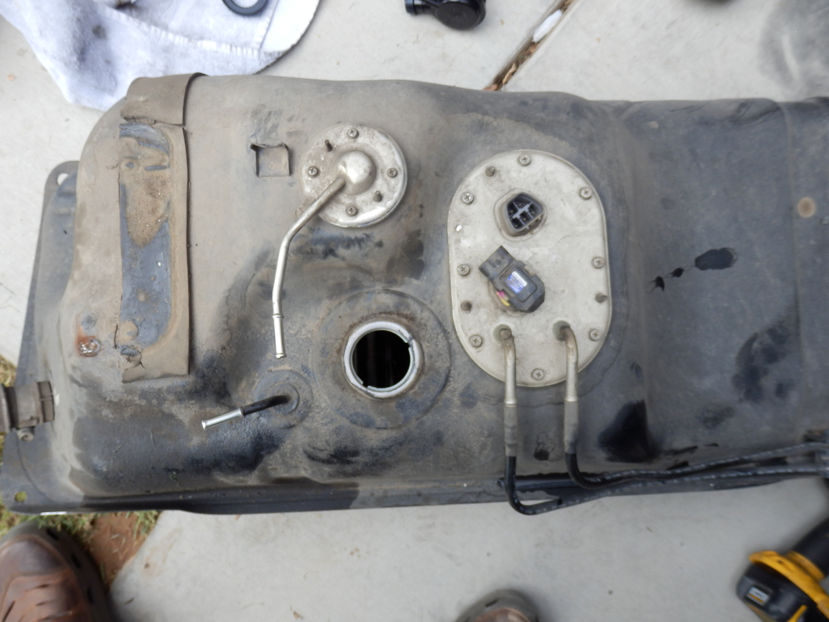

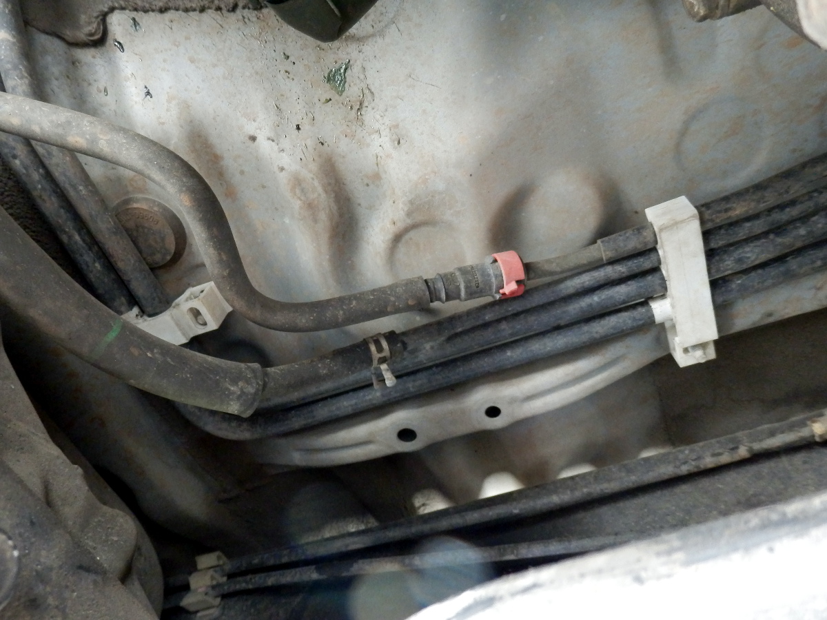

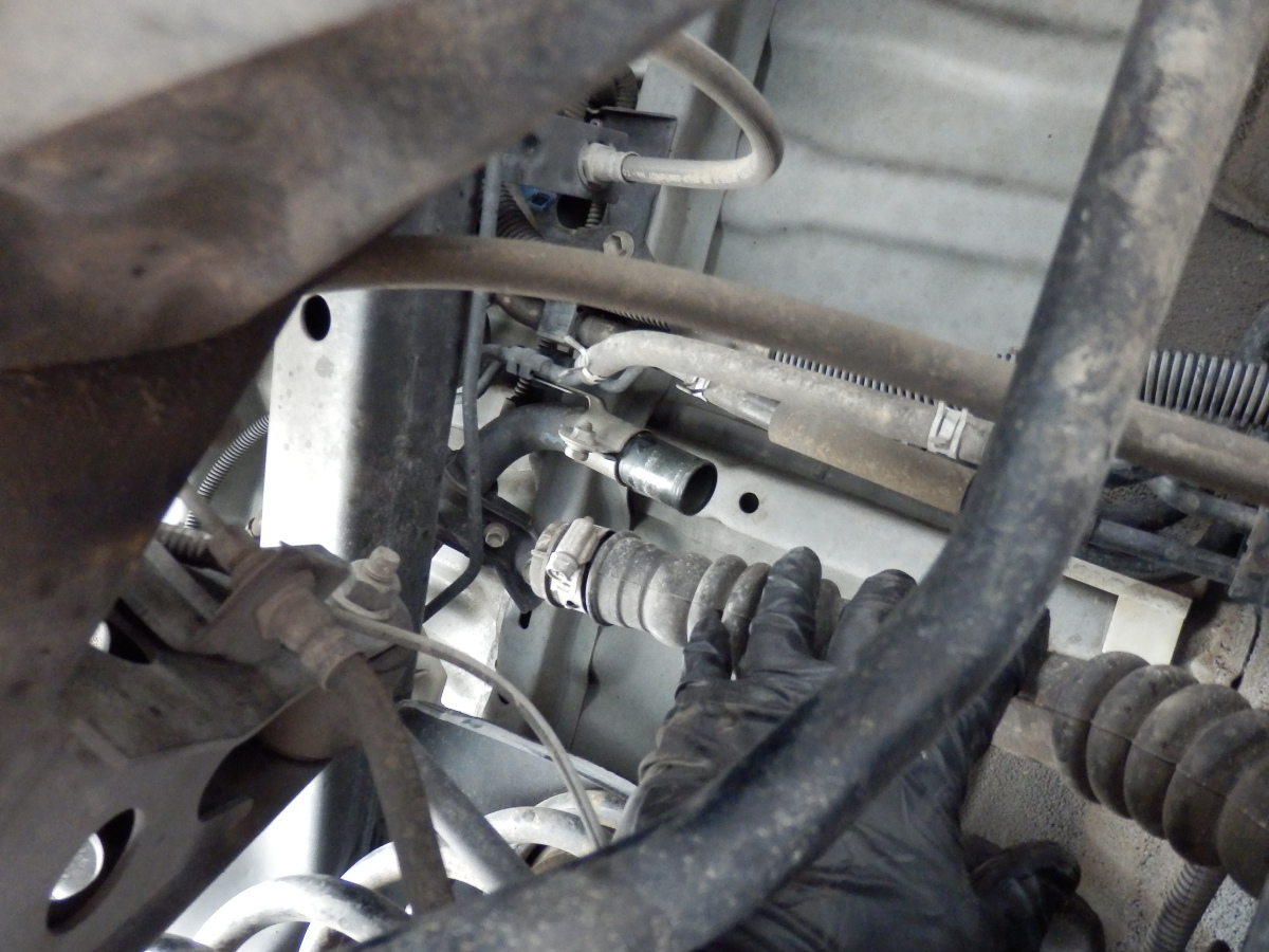

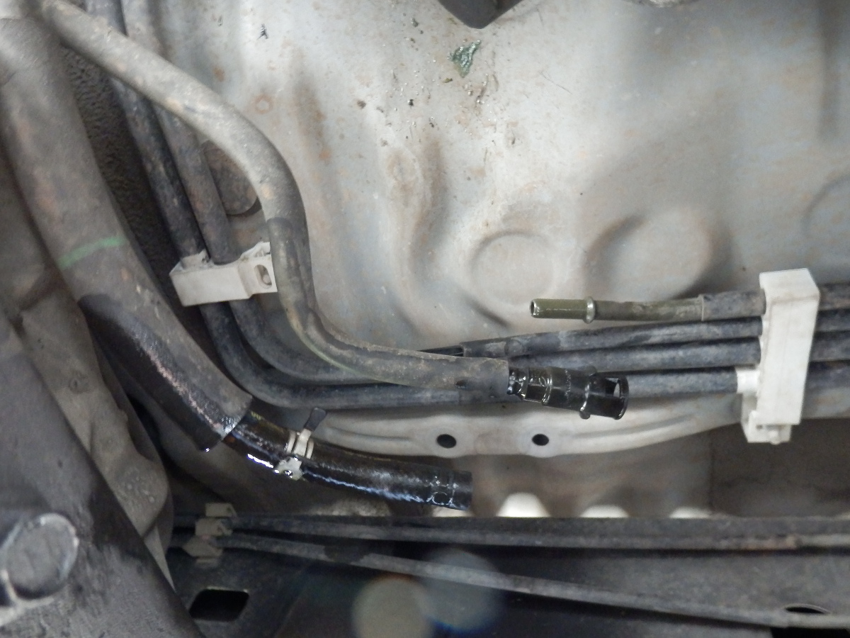

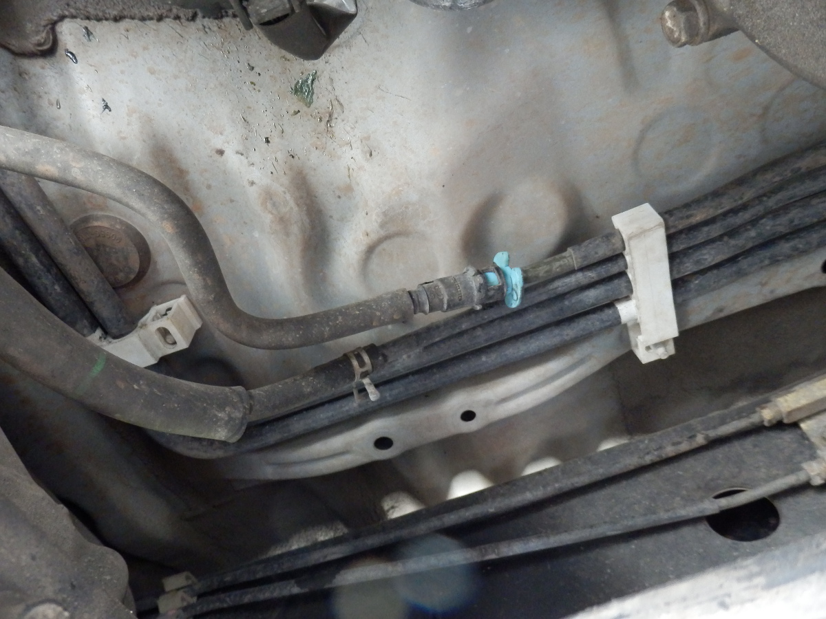

5. At the front of the tank (towards front of car) Locate the feed and return line going to the fuel rail. The line with the red clip is the feel, the other with the clip is the return. Remove the red clip (it is split in the middle and with force, you can pry it off). Then insert a fuel line disconnect tool to remove the line. On the return line, simply pull it off after compressing and sliding the clip back. Fuel WILL pour out of these lines for a little bit. Make sure your face is not under them. Have a towel ready.
You can see the fuel line disconnect inserted

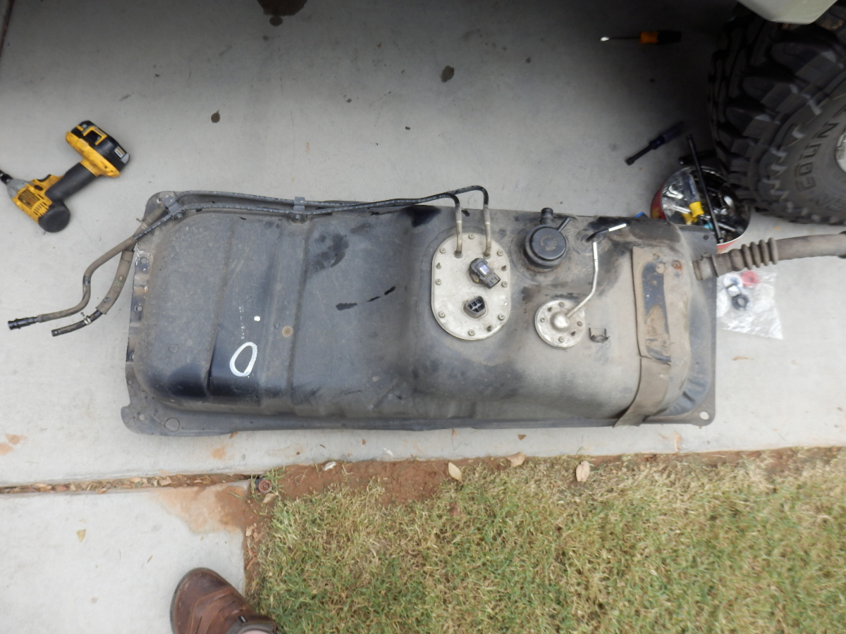

What you end up with

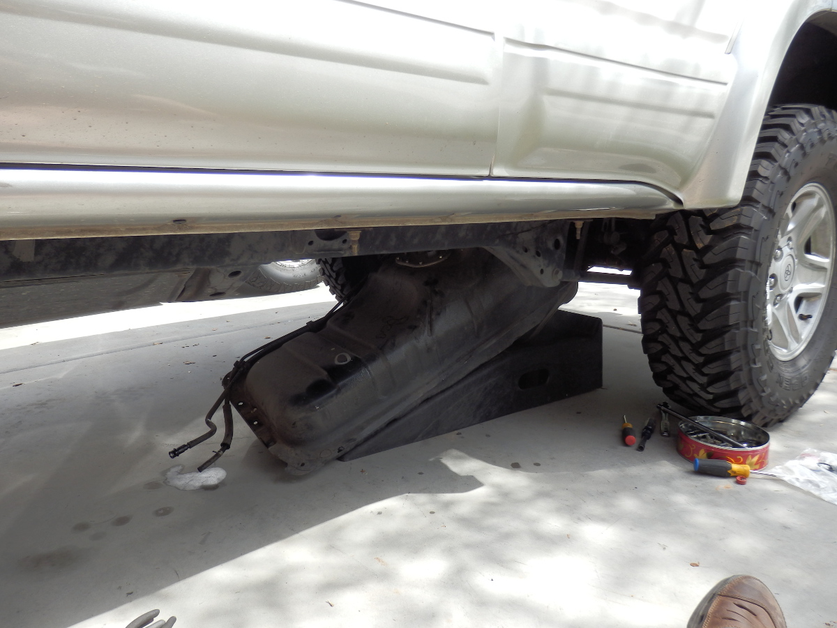

6. Go ahead and take out that front bolt. I use a car ramp to support the tank as it starts to come down. At this time, remove the cotter pin and strap pin on the rear gas tank strap to let the tank down further, letting it sit on the car ramp (pics of the ramp later - I do not have pics of the pin... somehow forgot to take a pic of it) Disconnect all the fuel lines and pry the stupid weird connector off the check valve thing. Have to use a flat head and it is a pain.
Part 2 in a moment :)

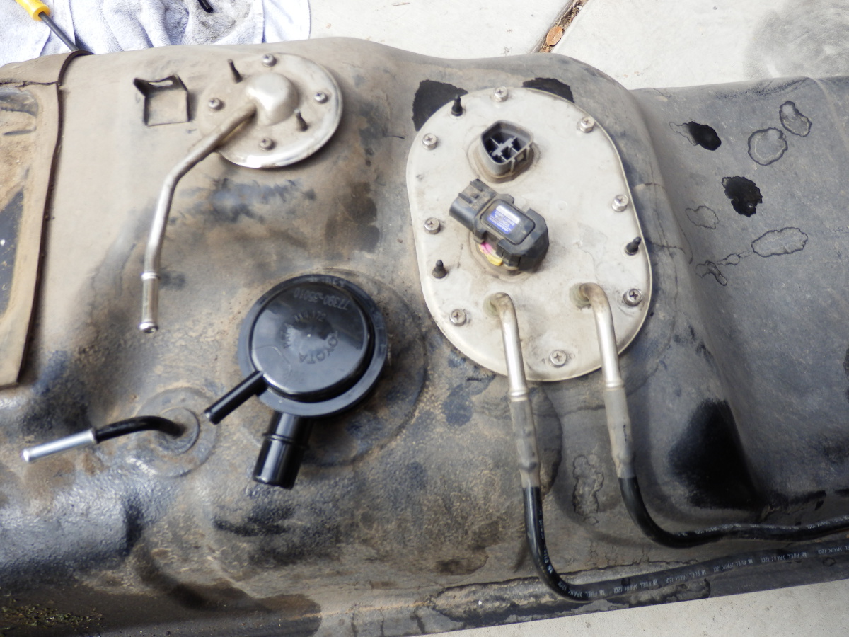

7. SWEET, slide the tank out from under the rig

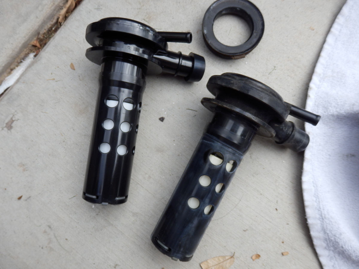

8. Photo of the new check valve vs the old.
9. Pull straight up while twisting and you can get the old check valve out. Remove the check valve grommet at this time. Put in the new grommet and check valve in reverse order.

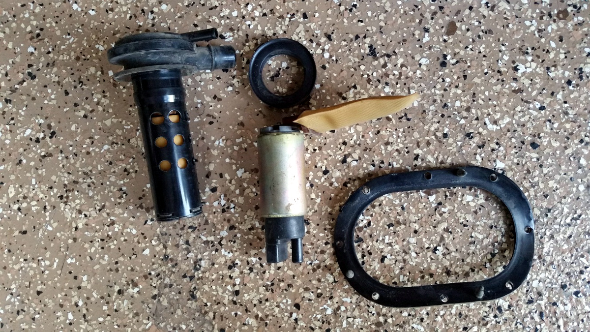

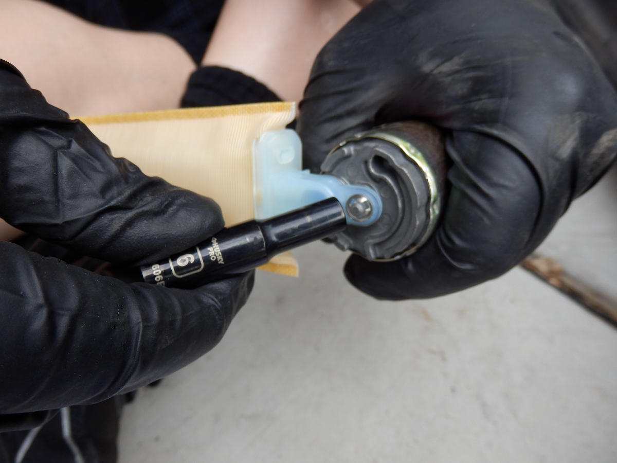

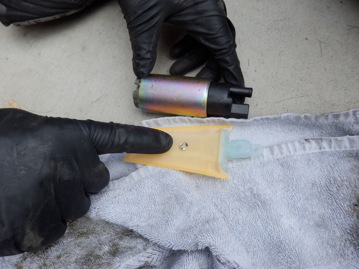

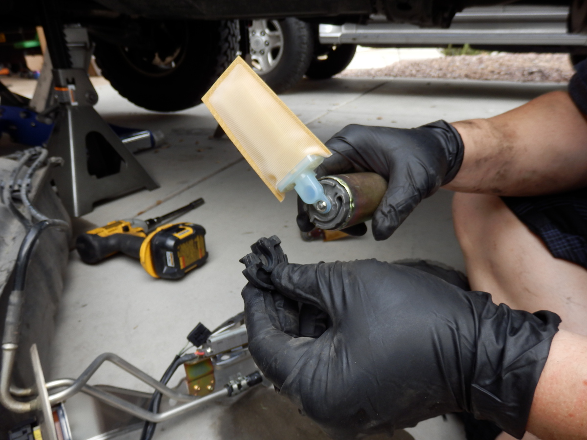

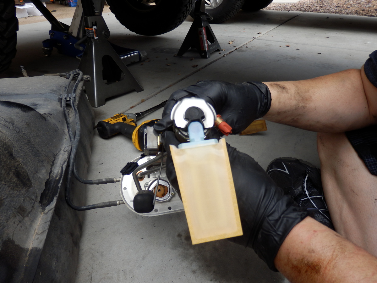

10. Assemble your new fuel pump. All you need out of the denso package is the sock, round press on clip and the pump. Use a 6mm socket to press the clip on the pump which secures the sock to the pump.

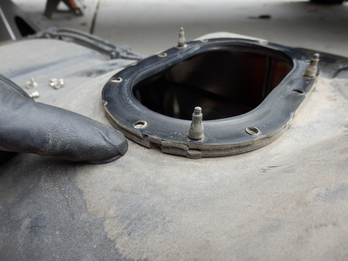

11. Remove the 8qty of 8mm bolts securing the fuel pump assembly and the level sender unit. Takes a little twisting and angling to gently remove the assembly. You should have also bought a new gasket as your old one will be weathered and cracked. (parts numbers in previous posts)

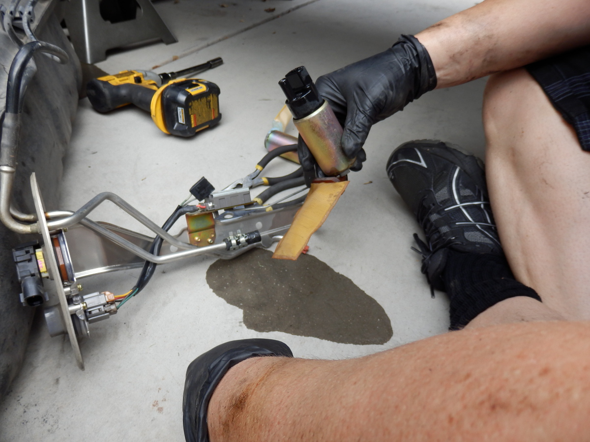

12. Once you have the sender out. Remove the old fuel pump by unplugging it, and sliding the clip up the fuel hose. The bottom of the pump will slide out from the metal bracket and you can pull the pump free.
13. Re-use the rubber cushion that goes under the pump. At 230K miles, this one was in excellent shape so no need to replace. Fuel hose was also excellent shape.
Slide the new pump into the fuel hose and with the rubber cushion on the bottom, slide it back into its bracket.

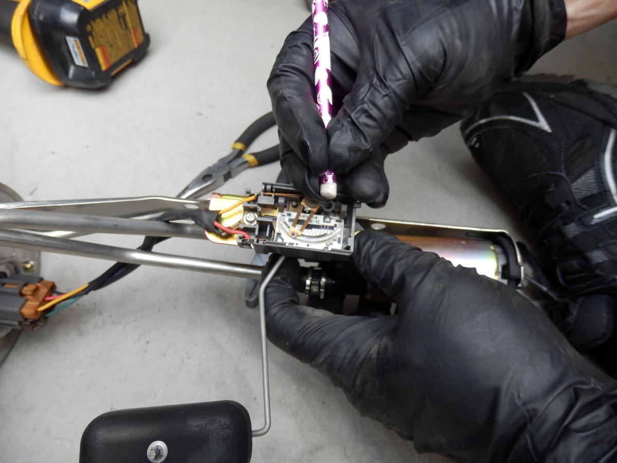

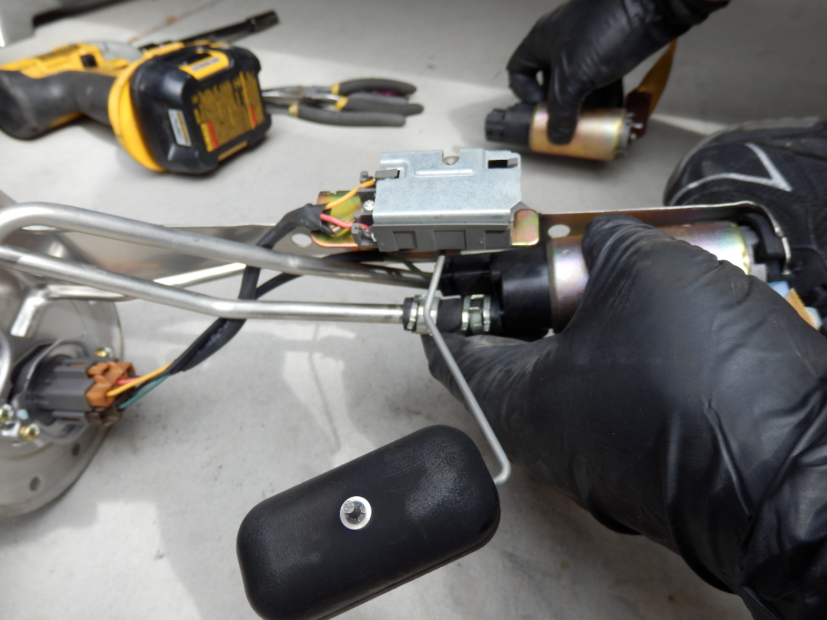

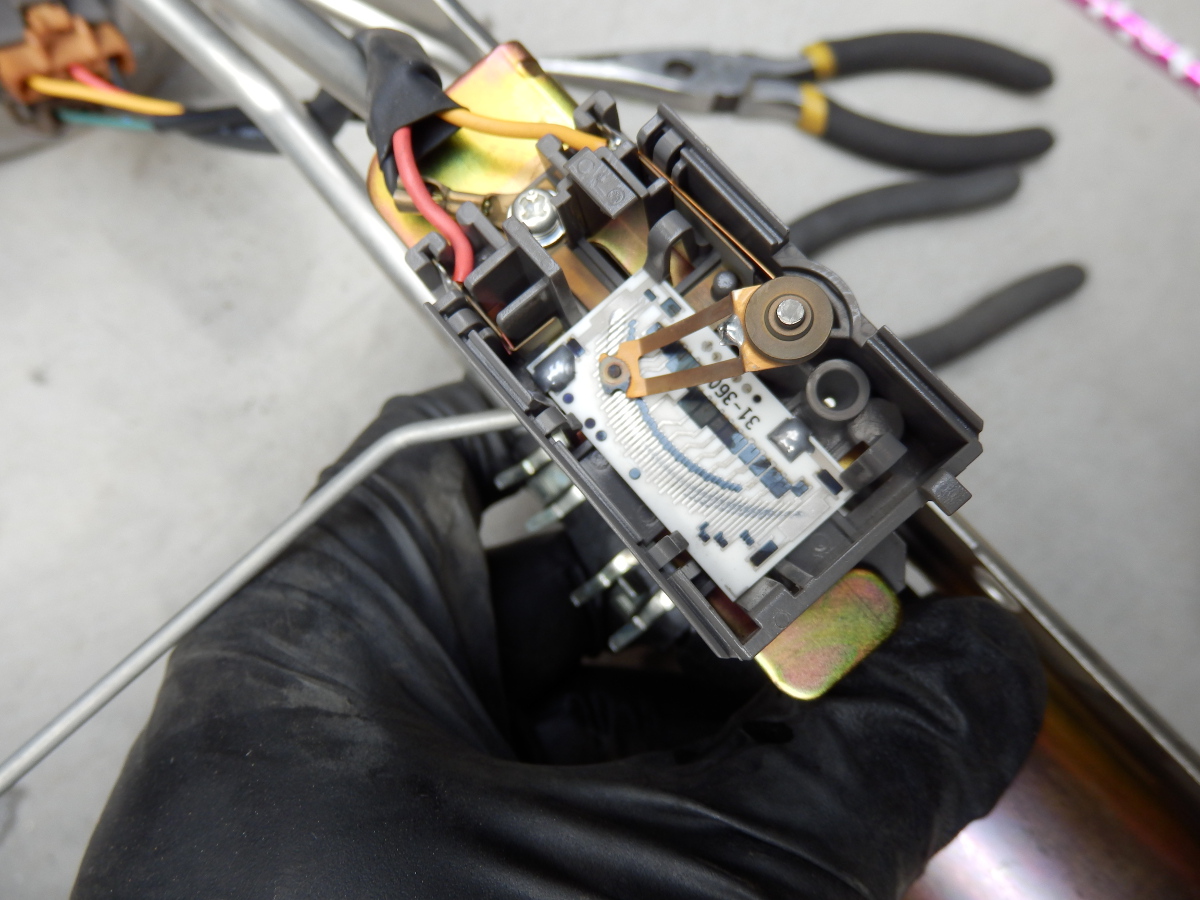

14. Now take a look at the sender. It is the silver box with the float attached to it. Slide the cover downwards and it will expose the contacts internally.
15. Take a pencil eraser and clean all of the silver contacts so they look new again. Make sure the little sender arm is making good contact with the traces on the pcb you just cleaned.
Once clean, she will look good as new.

17. Ah the photo of the car ramp. Use the ramp so that you can slide the tank back up into the car at angle. The ramp makes it easy. Connect up the big hose going to the check valve first (if the tank is close to empty, the hose will help support the weight of the tank which does not weigh much at all without fuel)
Next, get the rear strap under the tank and re-connected. It is a tight fit but you now need to connect up all the fuel lines back to their proper places. Forgot which goes to what location? No worries, they will line back up to the right ports and are all the right length to plug back into the right ports.
Once everything is plugged in and good to go. Secure the front bolt, re-attach the filler hose with the 10mm socket and re-install the skid plate.

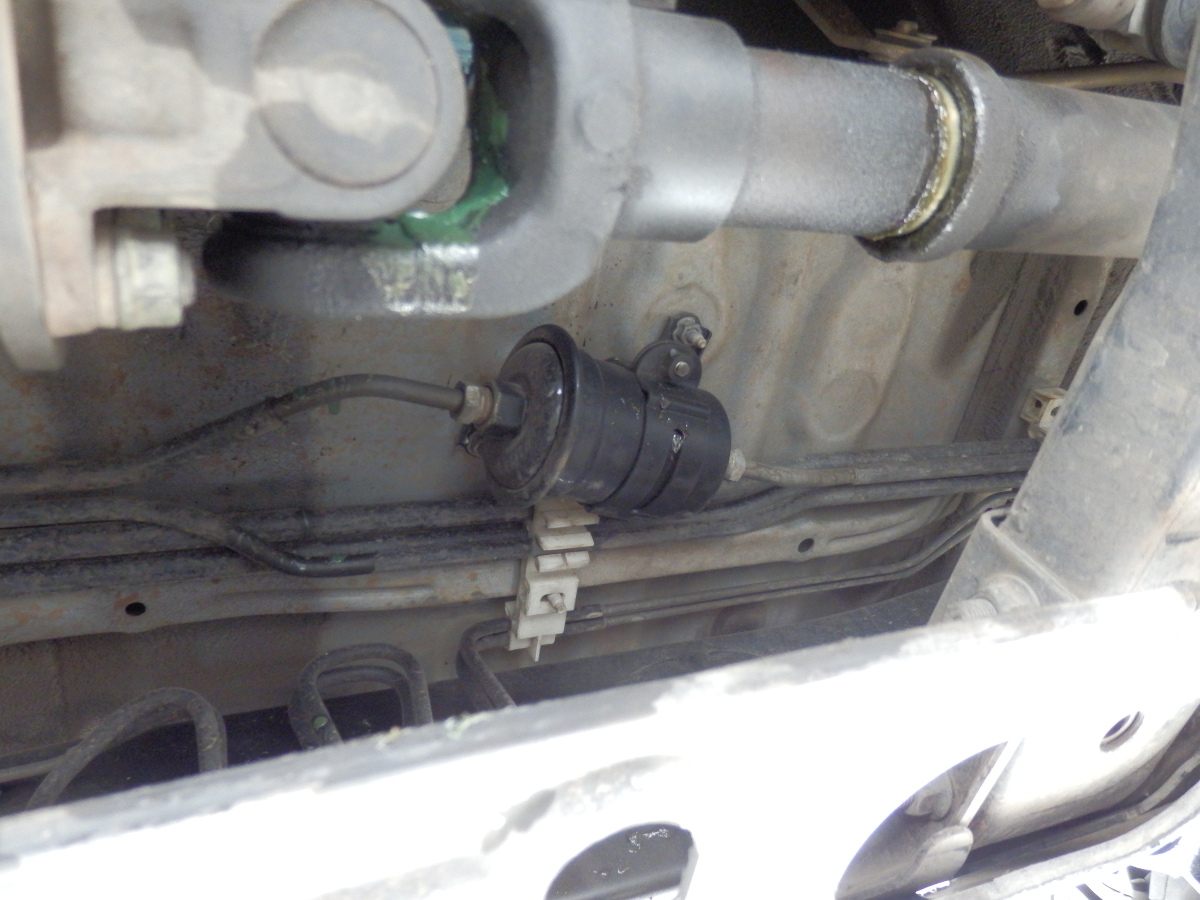

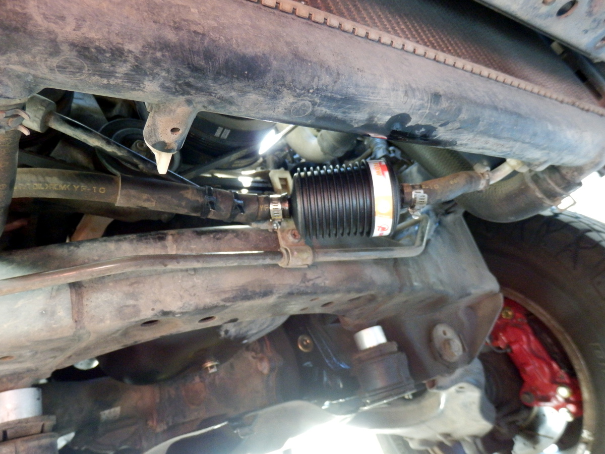

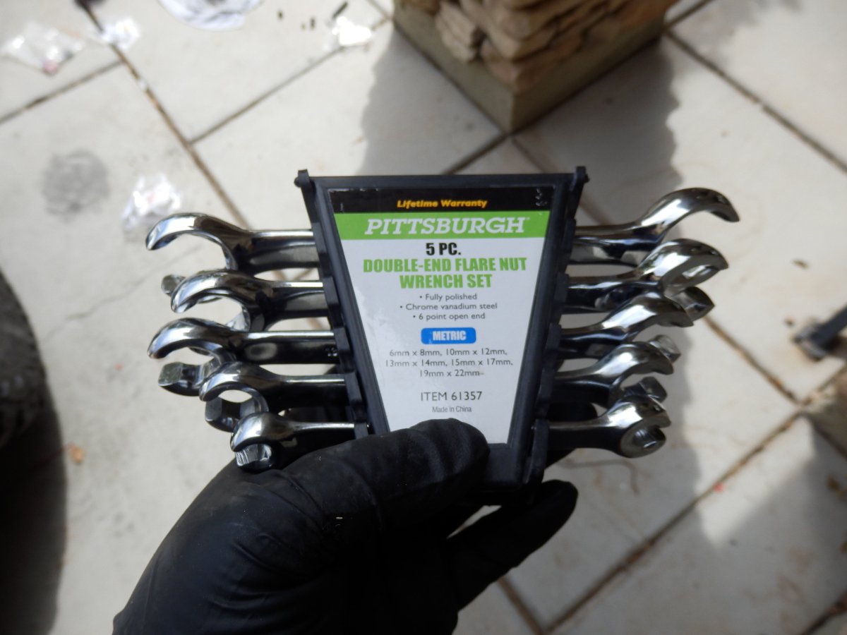

Next little addition.. change your darn fuel filter...
1. Get a quality filter.
2. Use ONLY flair end wrenches to disconnect the fittings from the fuel filter. Do not be a tard and use a box end. You will likely just round off the hex ends. I use these cheapy ghetto freight flair end wrenches and they have been great! FUEL WILL POUR OUT OF THE FILTER FOR A BIT! Have a towel ready to go as it makes quite a mess.
3. Just a photo of where the fuel filter is, under the drivers side of the car. There is a 10mm bolt that clamps the fuel filter in place and it is facing the wrong way. It can be a pain, but loosen the bolt so the old filter slides out.

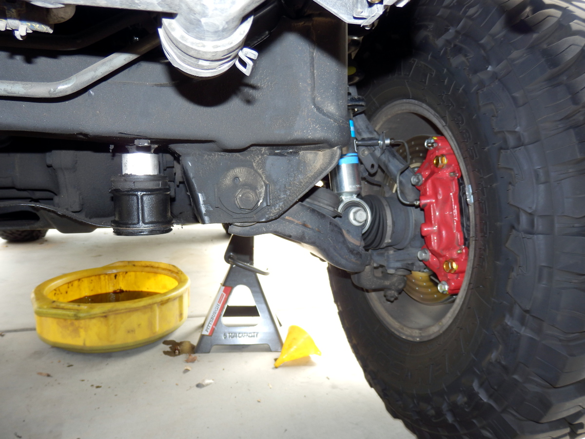

I advise you have new front swaybar bushings ready to go. You will need to take off the swaybar mounts (not the end links) so the bar will drop out of position to drop the pan

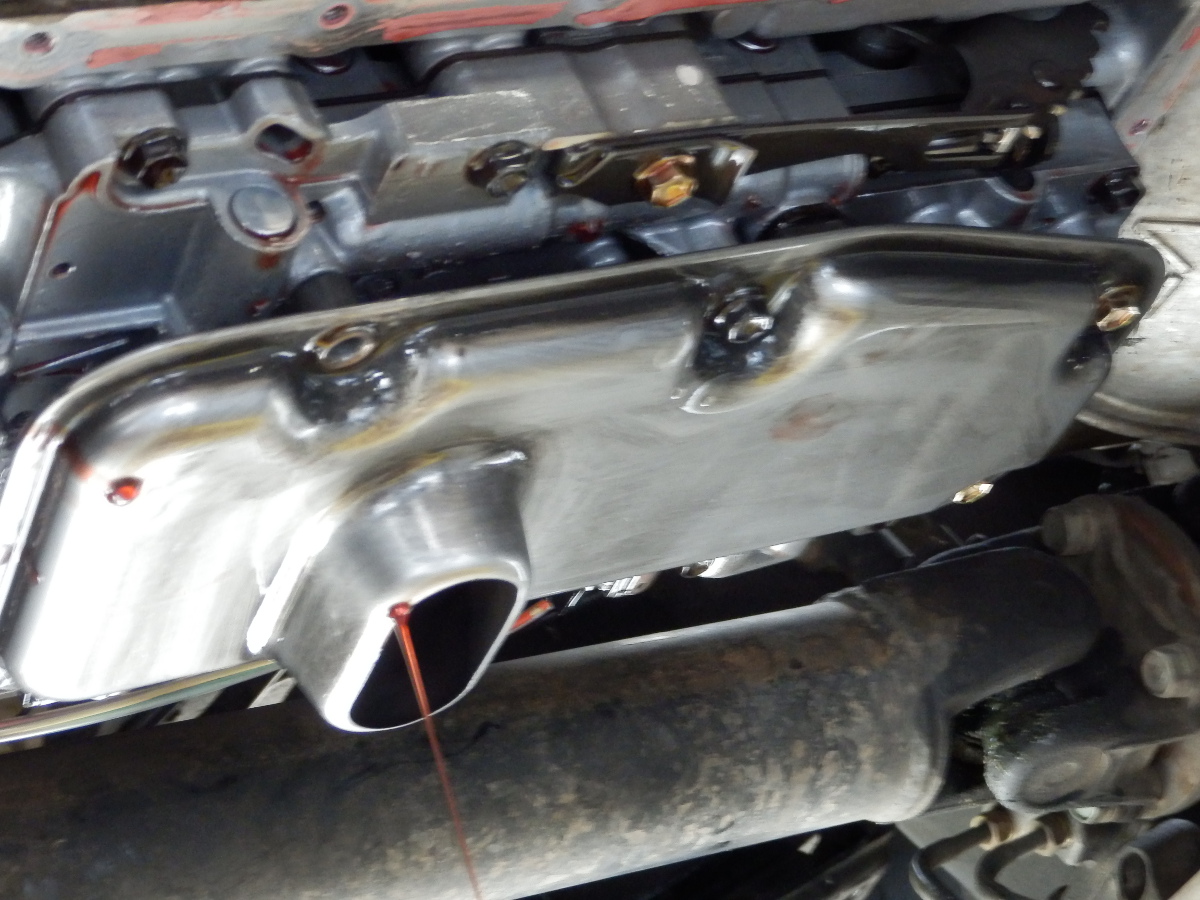

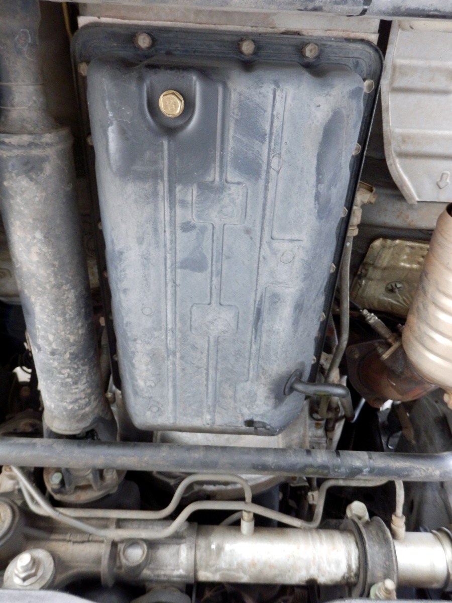

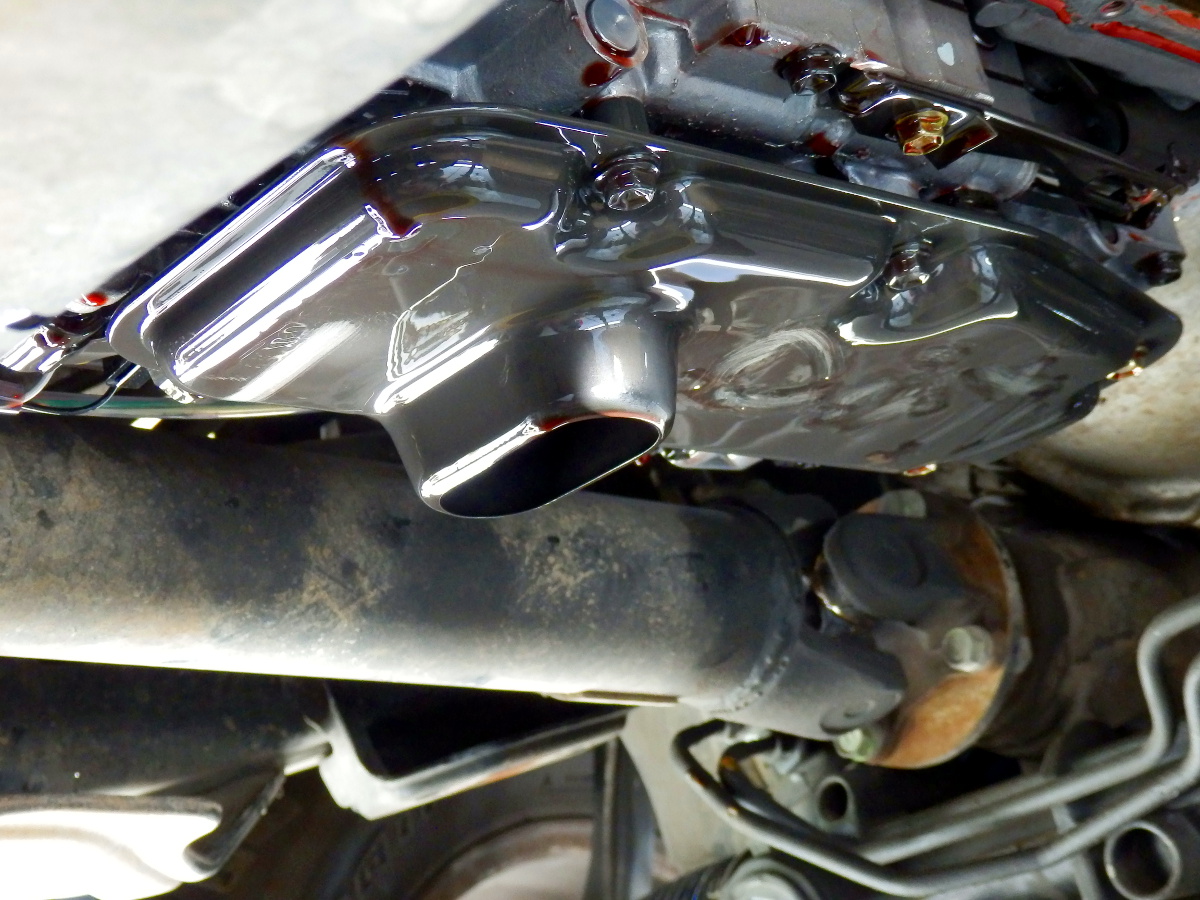

This is your tranny pan in the below photo which is held on by what seems like 40K 10mm bolts. Take all the bolts out and then take out the tranny dip-stick. Next, remove the 12mm bolt holding the dip-stick tube to the engine.
At this point, your pan will be stuck fast to the bottom of the transmission by the silicone gasket material that seals the pan to the bottom of the transmission. Use a small flat blade screwdriver at the back of the pan and use a rubber mallet to force it between the pan and the transmission. You will hear the silicone tearing and the pan coming loose. DO NOT twist the screwdriver or pry with it, as it will damage the mating surfaces. Just tap it in and no damage will occur.

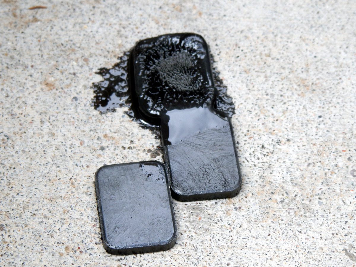

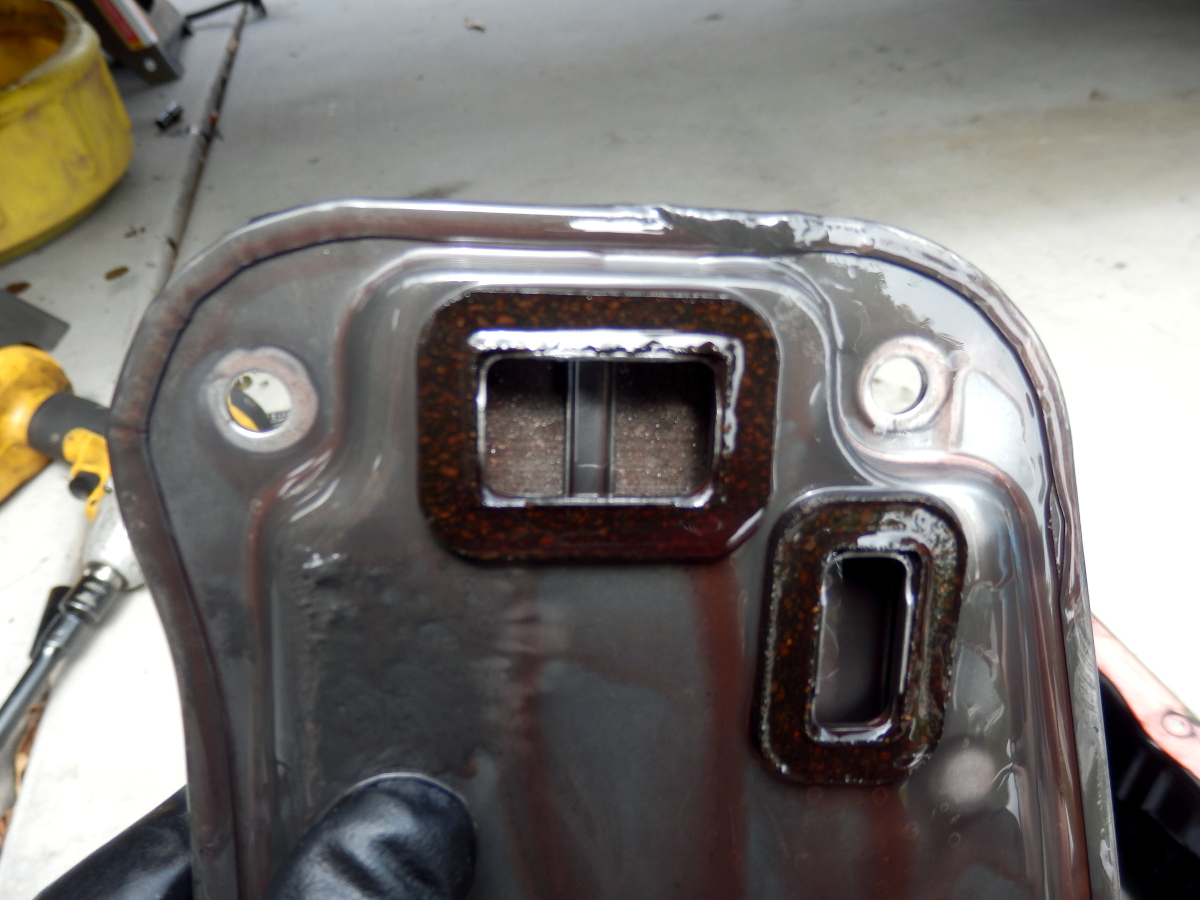

Take a look at your strainer. You will see a lot of particulates and even some metallic glitter on the screen. This is NORMAL unless it is super thick and caked on the screen... There will also be a lot of blackish sludge type goo on the metal of the strainer. If you re-use it, clean it all off back to new.
If you clean your strainer, hose it down good both inside and out with engine de-greaser. Let it sit for a bit and then heavily flush it out with a garden hose. Yes a hose. Put that sucker on full flow and flush / reverse flush the filter through all holes over and over. If done right, the screen will look clean as new. Just shake out the strainer and all water will come out. Let it sit in the sun for a bit while you do other things so that all drys out.
All clean

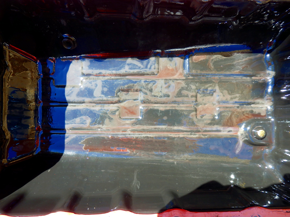

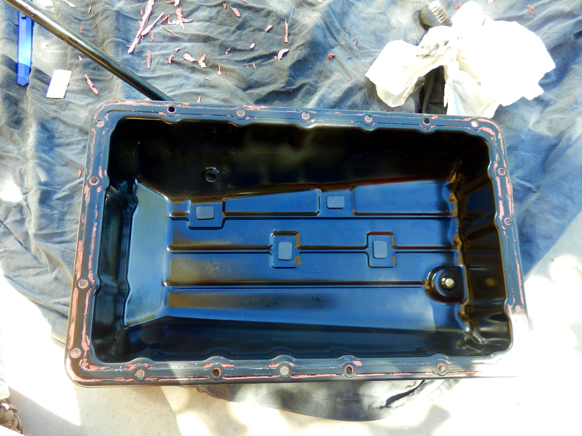

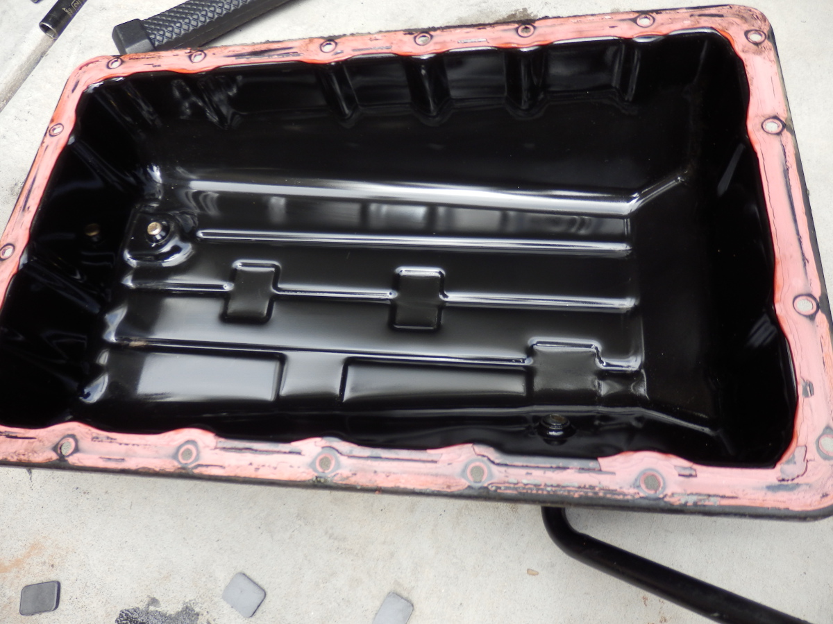

Now, have a look inside the pan of your transmission. It will not be super clean and some nastyness may have settled in the bottom, Especially around the 4 small magnets that just sit in the bottom. Remove all 4 magnets and clean then off. The two lower ones in this photo have been cleaned and the top one has not been cleaned. This is pretty normal for 230K miles. Not bad at all actually. See the 4 rectangle indents in the pan? Your magnets need to go back in these positions to be effective.
Also, wipe out your pan until it is spotless. See all that pink sealant? Now the sucky part, you have to use a razor blade to remove every single bit you can. Then take a steel wire brush and clean even further. The actual mating surface should be totally silicone free.
Did not get pics of the next steps as I was worn out and hands covered in yuk so did not want to ruin the camera... But it is simple.
- Once the pan is as clean as it gets - silicone / sealant free, use a clean rag and 91%+ rubbing alcohol to take off all fluid or oils off the mating surface of the pan
- Clean the mating surface of the transmission with a flat razor. The 4wd drive shaft gets in the way but it can be done. Once all the silicone is gone, use another clean rag and scrub the mating surfaces so they are dry and free of fluid.
- Use either a rubber gasket or a my choice, transmission pan sealant. I use specifically 81180 permatex auto transmission gasket maker. Stuff works great! Have used it for years when servicing autos and never an issue.

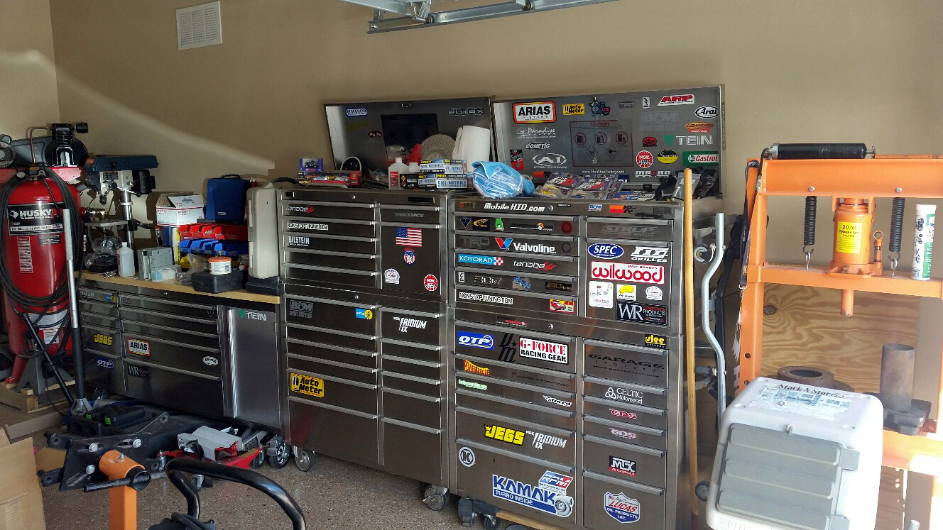

Took a photo of my wall of GET-R-DONE. The boxes may not have much depth as my old snap on boxes, however that is the point. Maximize usable floor space. Overall the bench and two boxes measure more than 13 feet. Will be purchasing at least two more of the benches and one more of the boxes for the next shop.
My old shop was multiple times more awesome... but she will rise again mid next year when I buy a new place :) Lots more gear than I am showing off here - cannot wait to get the new place rolling.
Woo. Nice tool boxes. :) I'll be looking for a place in the next 6-months or so, hope to start building a more robust garage. Will probably start with large toolbox, air compressor, bench.

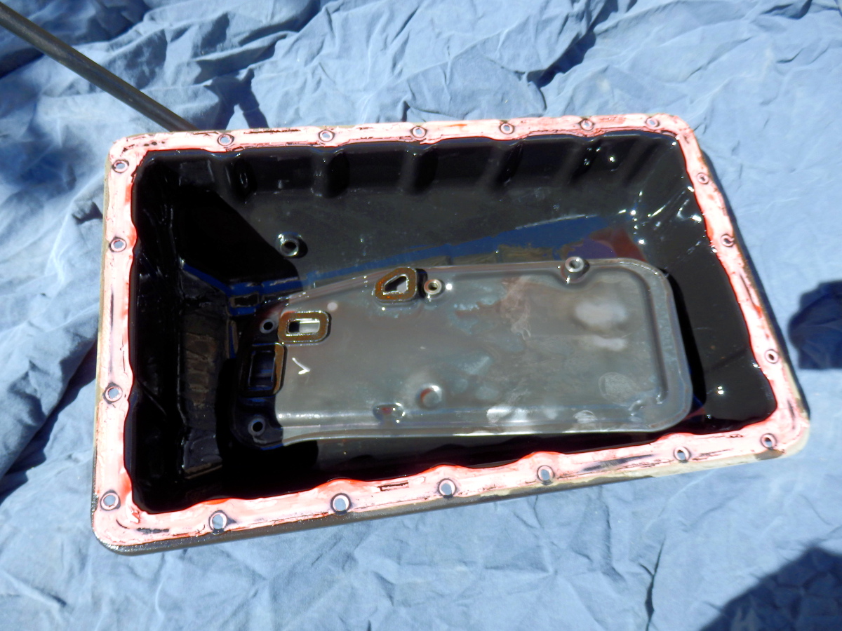

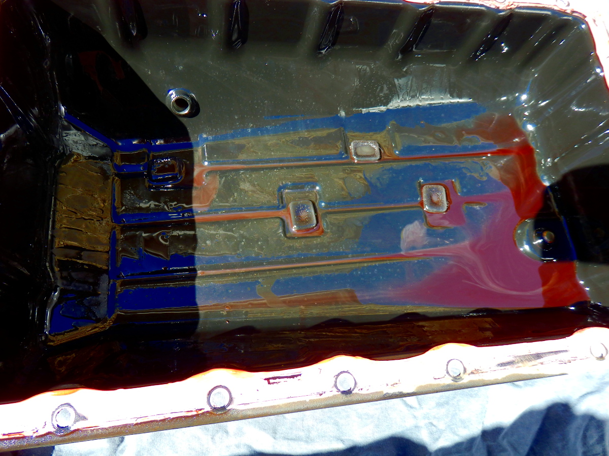

Some more transmission cleaning photos. Did the silver gunner this weekend. This time, I took photos before wiping off the strainer.
This is all perfectly normal for a car with 200K+ miles that has never had the pan dropped and that uses a strainer for a so called filter.
After a thorough cleaning and re-seal, I installed the magnefine filters in both 4runners which should help keep the strainer screen clean in the long term. Should help with buildup in the pans too. Found a convenient, easy to access spot for the filters just off the radiator barb, under the skid plate on the return line. If done right, the filter will not rub on anything and you can easily zip tie the line to a close by hard-line.

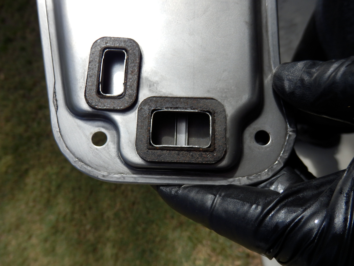

Strainer sitting in the pan. You can see how nasty it is. The strainer body normally does not look like this. This is the result of years and years of buildup in the pan without proper filtration. Tranny flushes or drain and fills DO NOT clean this stuff out. At this stage, only manual removal will clean it. Once clean, proper filtration will help keep it clean.
On the flip side, if more buildup occurs and some of the buildup is dis-lodged, your transmission will suffer in numerous ways or a failure may occur.
You can see the buildup on the strainer and where I rubbed the filth around
Pan right after dropping it. You can see the buildup on the magnets
Some of the buildup and sludge that sits in the pan stirred up
The pan all cleaned up and prepped

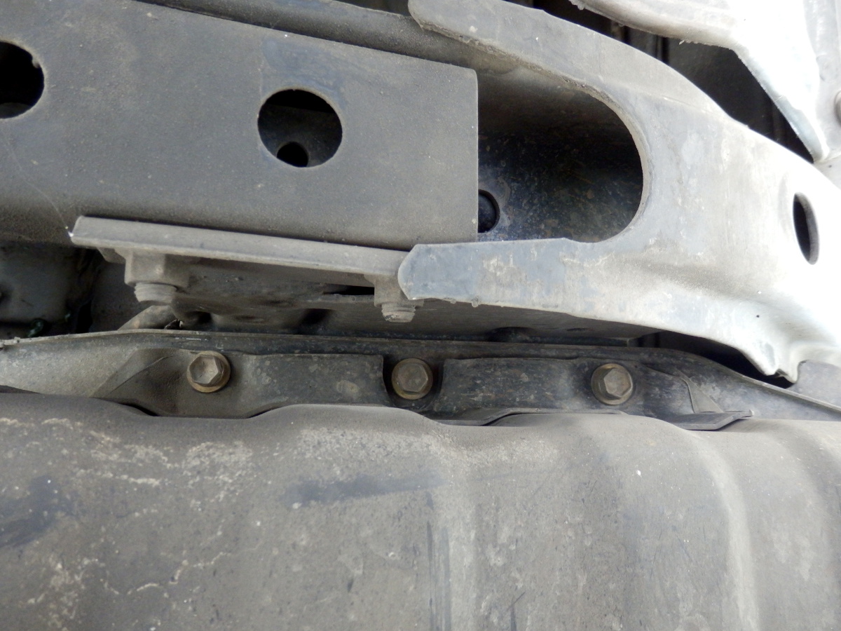

First the trick: You can remove the tensioner without taking off the ac compressor. Some may already know this but here is how.
- Use a LONG 1/4" extension and slip it between the oil pan and the brace. Just enough room for it to fit. Have it exit just below the tensioner
- Once through, put a 12mm short socket on the end of the extension and slide it up to that pesky rear tensioner bolt and remove! Saves a LOT of time. I know, because I had to do it 3 times this weekend! lol
Mind you, I have NEVER had an issue with a timing belt installation - always smooth as silk. My turn to get sucker punched a few times. If you cannot laugh at yourself... yeah..

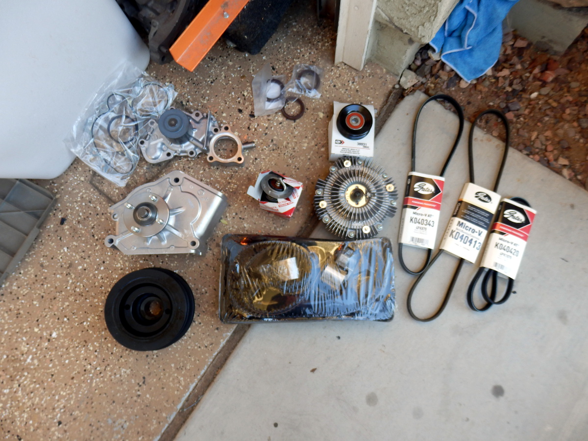

So.. my Saturday:
Knocked the timing belt out. Re-assembled and filled with coolant. Fired her up and she idled fine. Revved the motor a little and knew right away something was off. Pulled the top cam cover and pulleys lined up, looked at the crank pulley and... oh hell. Looks to be off two teeth? What the heck?
So... time to do the whole timing belt job all over again woohoo! Somehow the belt slipped 2 full teeth and I freaking missed it. Tensioner was good, no issues with install at all. But there she was... slipped. :redbrick:
Pulled the tensioner out, compressed it and put everything back in - lined it up. Good to go! Then I put the crank pulley on with the bottom cover for a quick sanity check... WAY OFF. Ah F-me already... I put the belt on 180 out. Really? Two issues on one timing belt install? Just not my day.
Flipped the belt, compressed the tensioner and re-installed. Finally, good to go. Re-assembled it all and she is fine. So in short, I did 2.5ish timing belt jobs on the silver 4runner this weekend. And I feel every single bit of it.

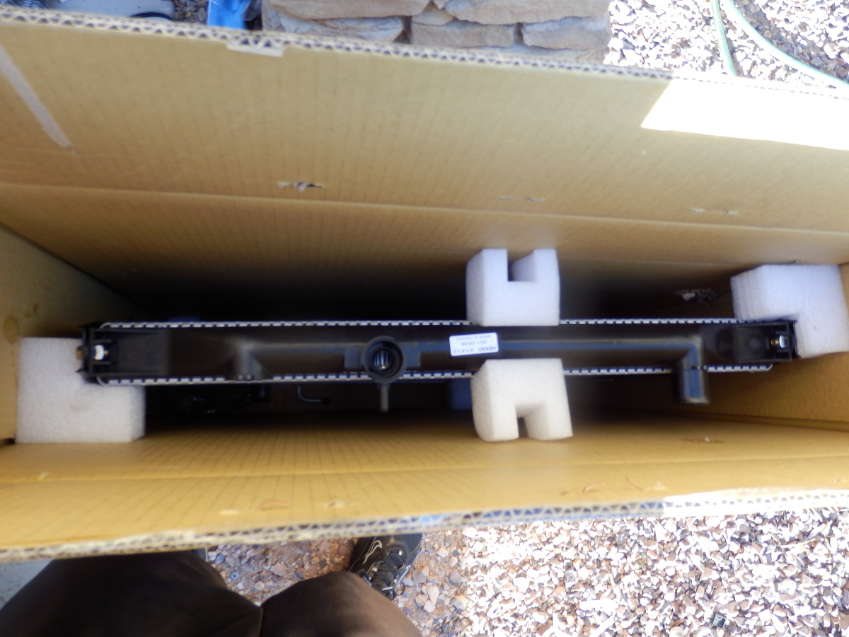

While I was in there, I also put in:
- New Aisin water pump PN: WPT-100
- All belts replaced with gates PN(s) K040413 K040343 and K040420
- AC idler pulley replaced / gates PN: 38031
- Gates timing belt kit with tensioner and idler PN: TCK271
- Crank seal / cam seals / toyota PN: Cam x 2 9031138051 / Crank PN:9031140022
- New Aisin false water pump idler PN: FBT-004
- New Aisin fan clutch PN: FCT-013
- New radiator PN: 221-0508
- Thermostat Toyota PN: 9091603075
- T-stat gasket PN: 1632562010
