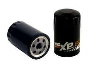

Nothing really new to update or report except I am switching over to the new Wix 51516XP oil filter. They are a high capacity / long life filter. The goal for me is to only change them out every 2nd oil change (10K miles). I am good with this as the oil is looking decent these days but still have to have it analyzed on the next change. On both 4runners, when I switched them over to T6, the oil was black as night even after a few hundred miles as a lot of yuk seemed to be dispersing / cleaning up in the engine. Looks like that has passed now.

Nothing wrong with the oem filters. But in use and over a lot of years of making brand choices due to good results / cut-open reviews (and my own cut-open checks, I simply choose wix and or pure one filters.
Rather pleased with wix making the XP series and looking forward to seeing how they do at 10K miles between changes - see if the filter element is collapsing at all.

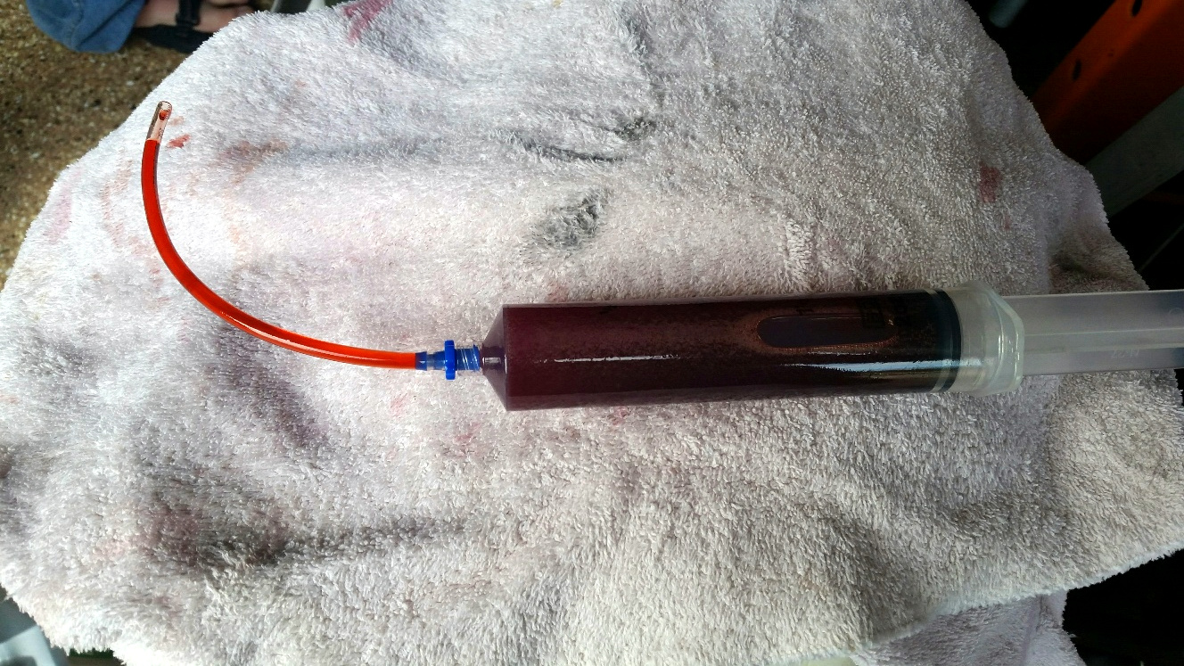

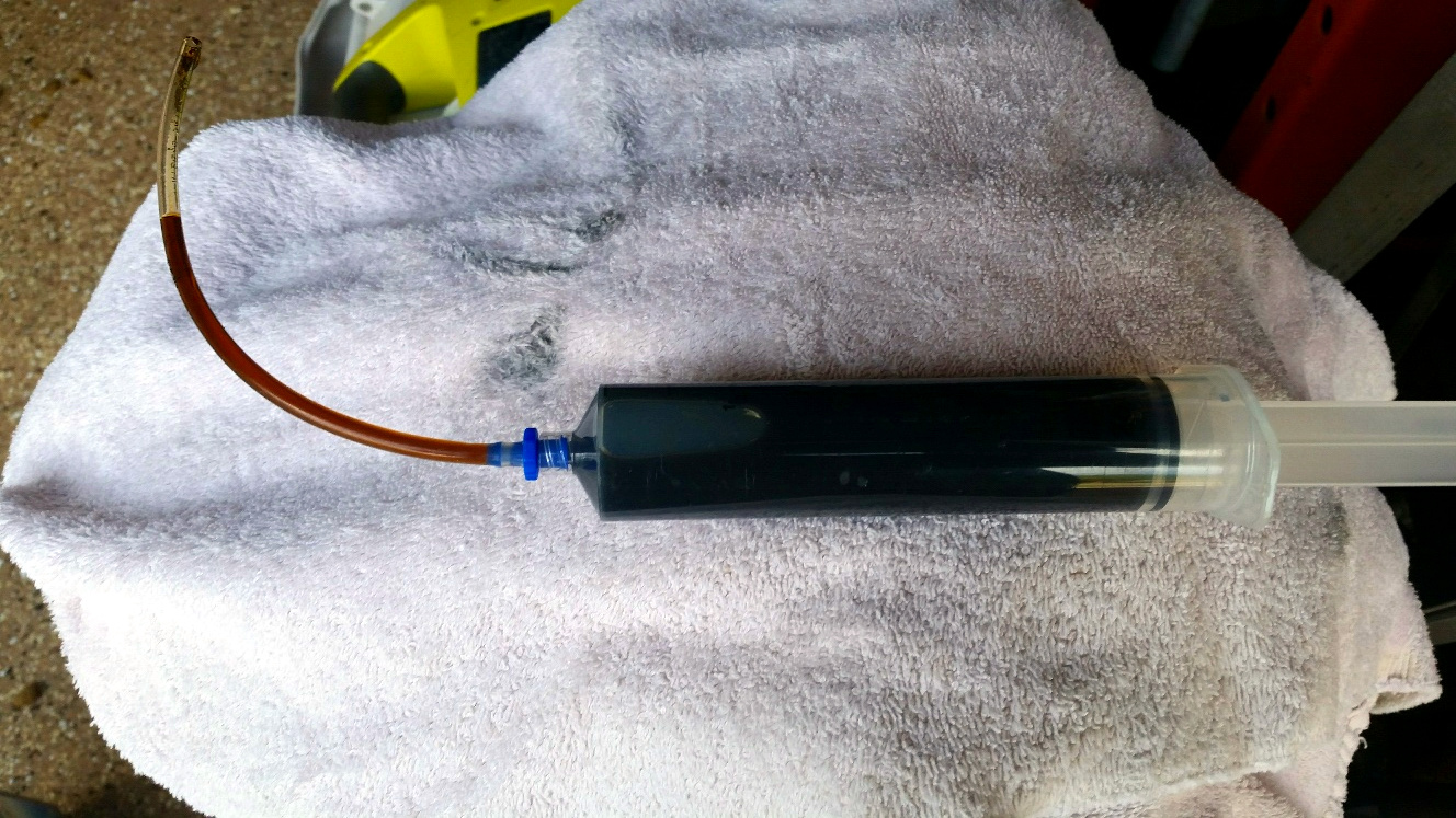

Some pics of todays service work on my white 4runner. I also did my silver but did not take pics. Does not look like anyone has touched the PS system since new in the white gunner (does not surprise me). Shame on me for not jumping on it right away when I picked it up, but other goodies had priority.
This particular service took about 25 minutes and did not spill a drop of fluid and required hardly any effort. The fluid was BLACK, nearly like burnt motor oil. So this took 5 drain and fills / starting the 4runner and turning lock to lock 3 times in between each one to get it to the condition it is in now.
As I previously mentioned, I will now extract / fill every other oil change (10K miles) and it will remain in excellent condition and actually get better over time. I only found my 60mL syringe so this process actually takes about 10 minutes if you have a 200mL syringe (they sell them online as brake - oil inspection syringes)
Before: Notice the nastyness on the tip of the syringe tube. Gunk that stirred up from inside the PS tank. I am tempted to use a magnafine filter on the PS for 30K miles or so until I clear the sediment up and the detergents in the new fluid break down the grime. Will see how it looks in 10K miles. If you have this gunk on the tube, make sure you wipe the tube clean before putting it into new fluid to suck up fresh ATF.

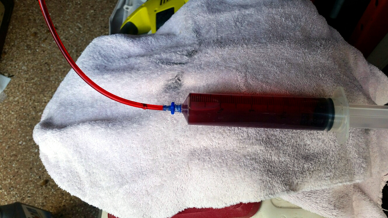

After the process. Not flawless but in 2 changes or so, she will be as good as new. And with continuous small changes, she will remain as new.
And just for comparison, brand new ATF

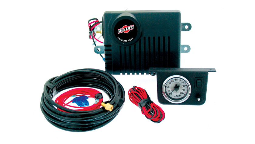

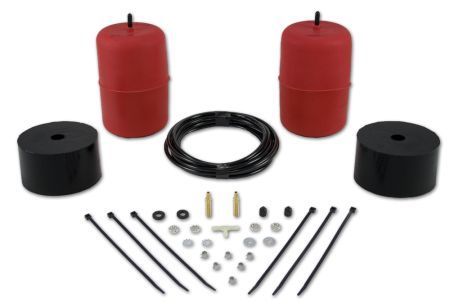

Just ordered in for the white gunner:
- Rear Bilstein 24-249966 shocks (Fronts are Tundra 5100's)
- Load leveling airbag kit from Air Lift P/N: 60743
- Air-Lift compressor / gauge / control kit P/N 25804
- 10mm and 5mm trim packers from OME
Wanted to get the ass end under control when towing my 6x12 trailer I am slowly working on to be an expedition trailer. With the gunner fully loaded with trailer, kids, dog, wife and things.. she sags in the rear (the 4runner, wife looks great)
I know I could have just added external ports for the airbags, but decided to do a cheap, compact on-board compressor system. I will mount it inside and behind the rear storage panel for easy access. I may end up adding inside the console or glove box... will see.
The height without the gunner loaded + FJ springs is pretty good. However I have a tad bit of rear drivers side sag. So I will add in the 10mm trim packer to that side and the 5mm to the passenger side. I am doing this as I do not plan to run any pressure in the bags when not towing as I am happy with the ride and height.
