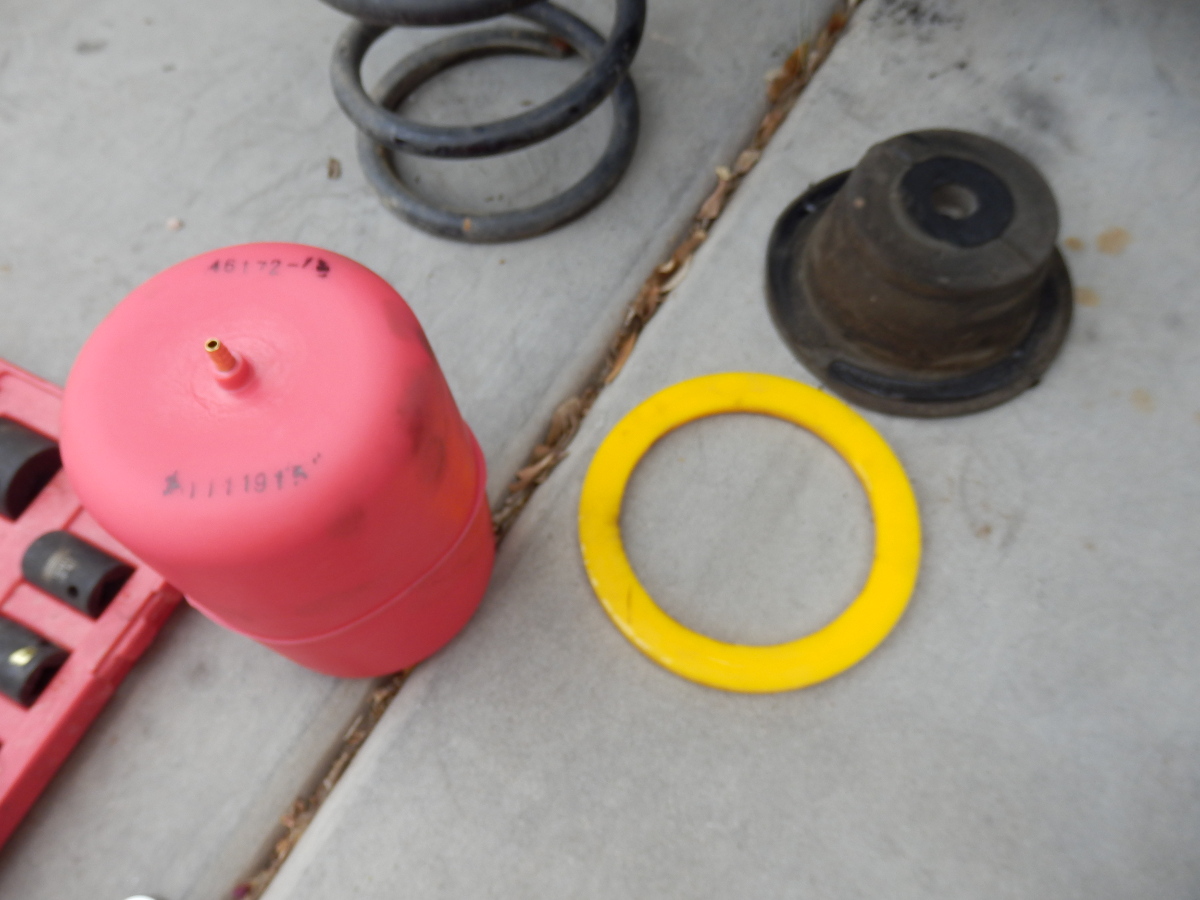

Bump stops cut / trimpacker pictured

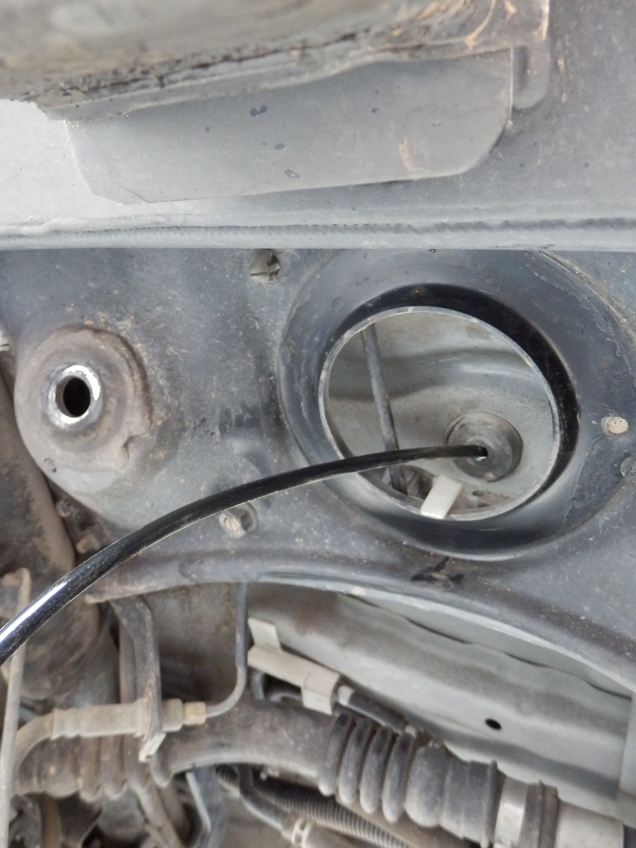

Airbag line should run straight up through the bump stop. There is a grommet just above the perch you can run the line into (drill it out a little). This line ends up under the rear carpet.

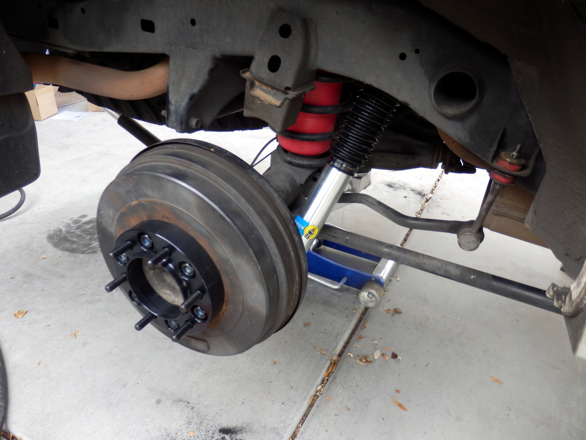

Everything installed. Spacers, bags, trimpackers and 5100's

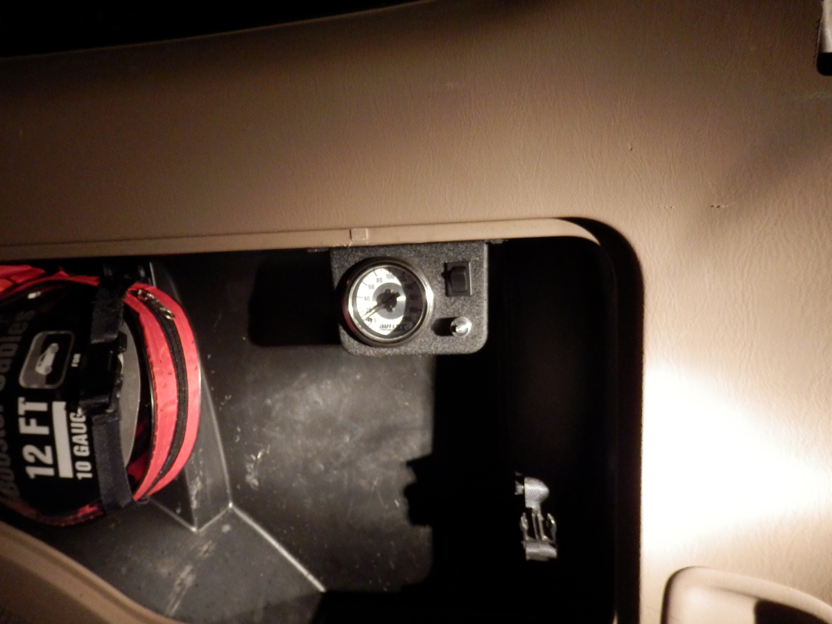

I put the airbag controller in the rear cubby up high. Makes for easy access if I need to adjust. I did not picture the compressor, but it is behind the opposite wall bolted to said wall (easy installation and it fits with the removal of a noise reduction pocket)

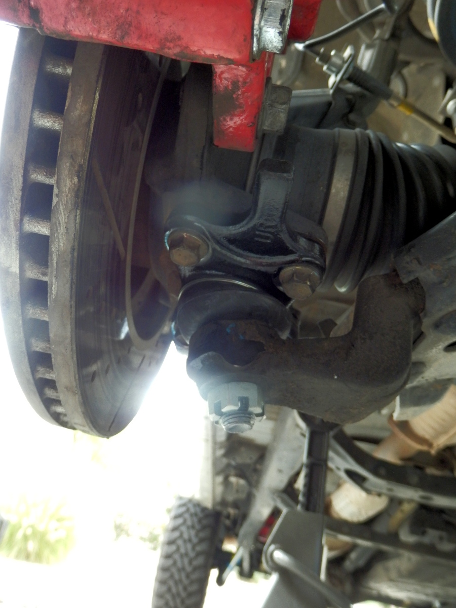

LBJ's installed. Photo before torquing
When installing LBJ's, I recommend you install new bolts (4qty of 14mm bolts). I thought I had ordered them but did not. Have them on order now and will change them out.

- Use blue loctite on the 4qty of 14mm bolts. No need for red.
- ONLY buy toyota LBJ's
- Torque for 4qty of 14mm bolts is 59ft-lb
- Torque for ball joint bolt is 112ft-lb (may be a tad more to line up cotter pin)

Since you are pretty technical and know your stuff what's your detailed opinion on the eBay spacers.

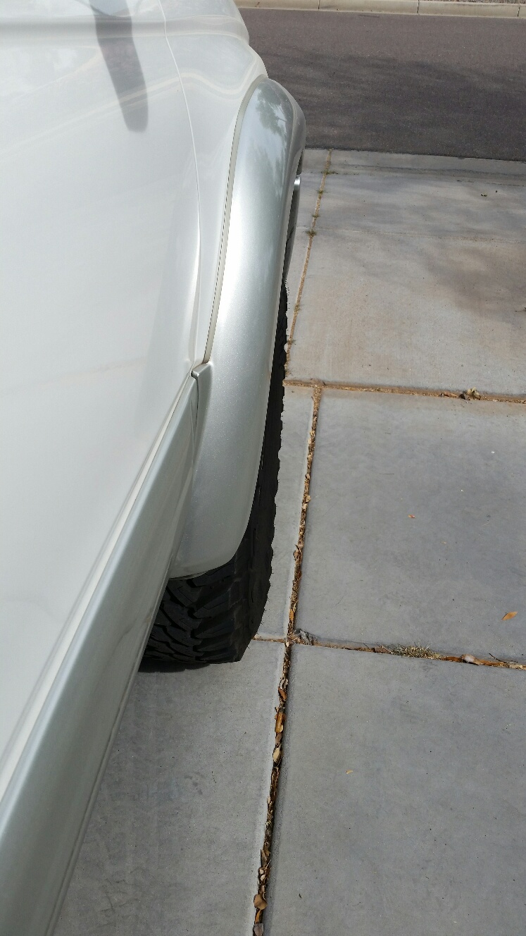

The specific hub-centric ones I bought and linked above are top quality. I was surprised actually for the price. Very well made and tolerances were excellent.
They added zero vibration going down the road which speaks to the machine work. Time will tell how the studs age / if they rust or whatever but overall for the price - go for it. Besides, studs are easy to replace.
One comment on the spacer install, the rear studs (4runner studs) had enough thread so that they were flush with the bolts which was flawless. The fronts (4runner studs) however, not sure why but I was about 1/4" shy. Not sure if they are OEM or if someone replaced the front or rear at one point. But whatever the case, the front studs were shorter than the rear studs on the gunner. Will order in new studs for the front and since I do not run dust shields on the front brakes, changing studs is super easy.

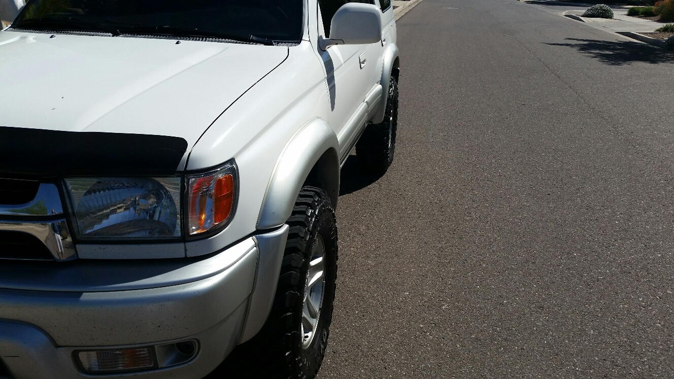

Before the spacers photos:
After the spacers:

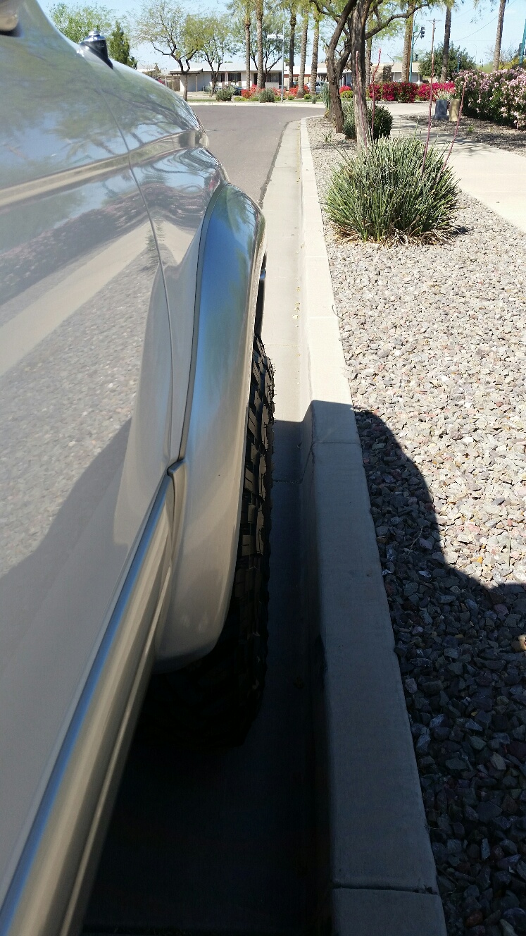

A shot with spacers installed. Looks great with the fender flares.

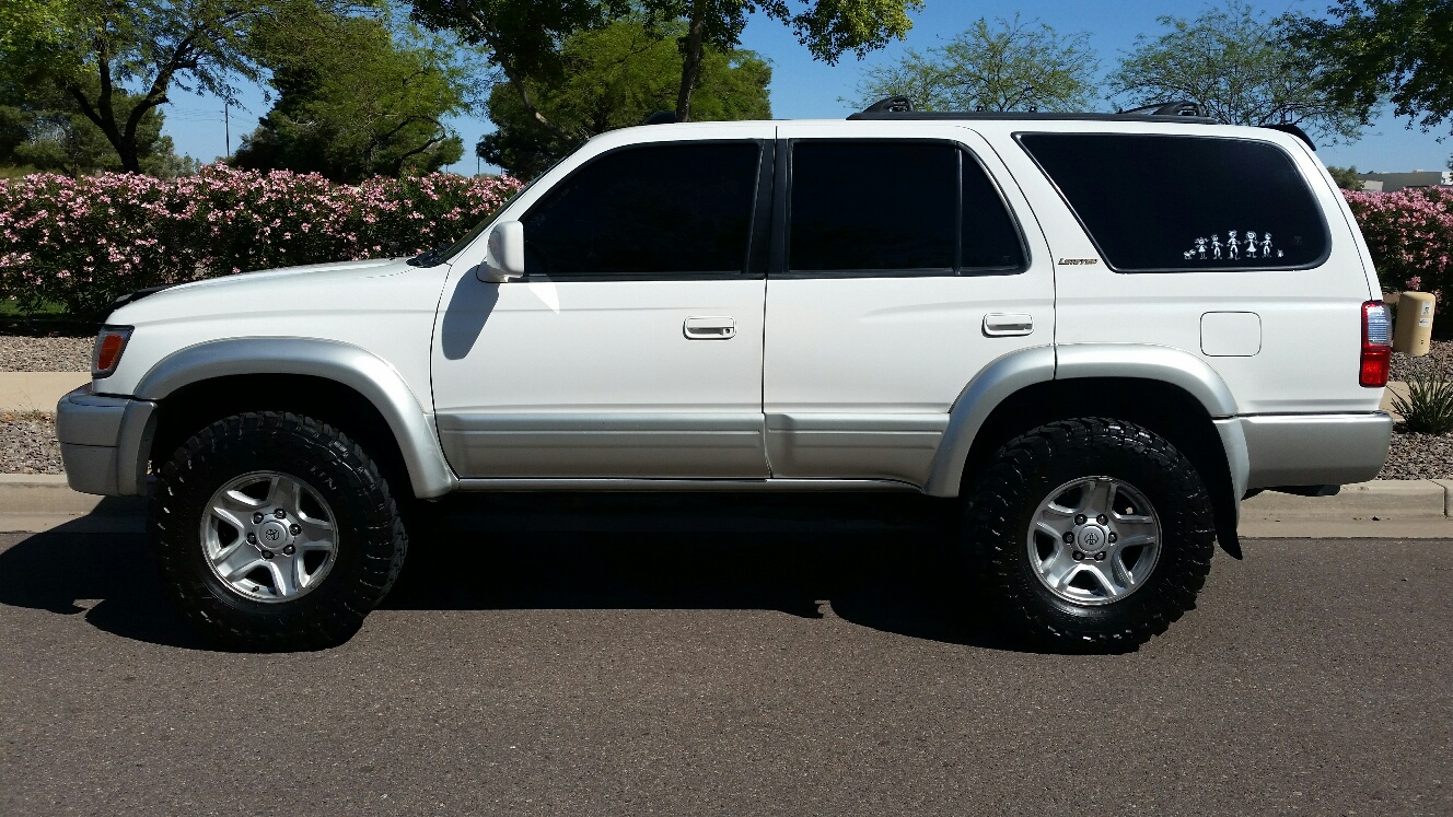

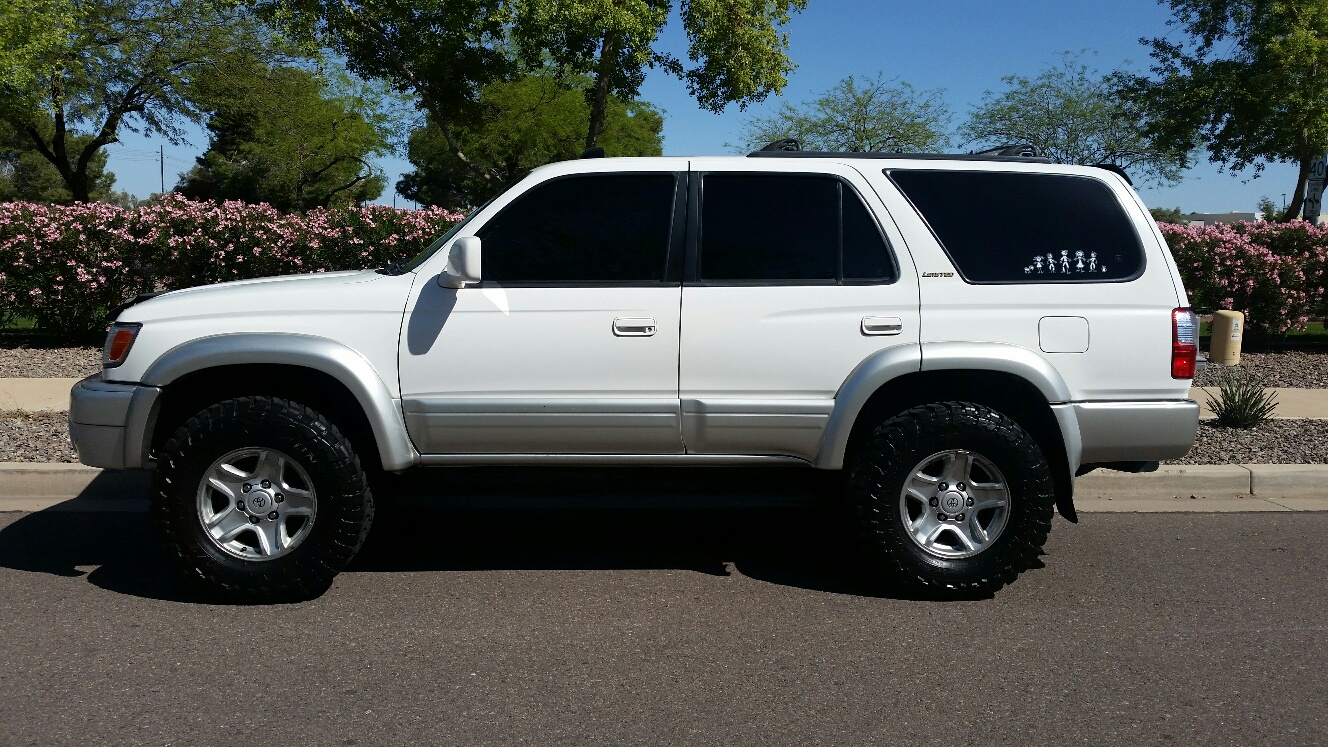

With the airbags. They really do not raise or lower the 4runner much when not loaded so nothing really all that notable. However sit all my kids and family in the back so it sags a bit, then add some pressure and she levels right out! Exactly what the setup is designed to do.
Current stance with bags at their minimum 5psi recommended setting with trimpackers / 100% full tank of gas. She sits with just a slight forward rake... hard to tell in the photos.
Notice at 35psi... as stated, the setup is not designed as a lift. Does raise the back a little but nothing much. Now if the ass is sagging from weight, the bags lift it right up and level it out with ease.
Ride is butter with them at 5psi / normal. But with pressure, it gets thicker feeling but not rough. Still cushion there but not much travel so it just feels like a stiff spring but well damped by the 5100's. I have not towed with the setup yet so cannot comment on that part.

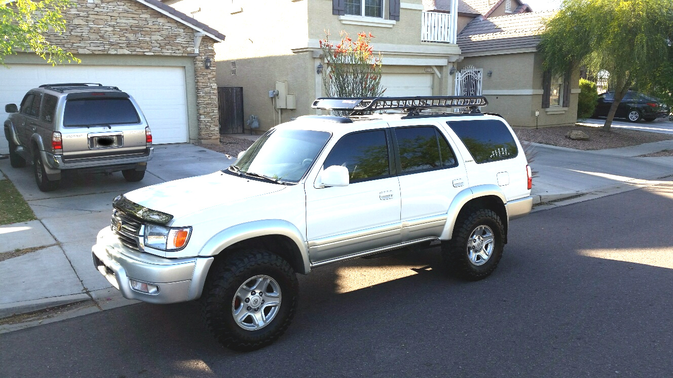

Got this on today - Rola basket with extension. Price was good and as long as you seal the joints - good value! Sits higher than I would like so will fab up some low profile brackets later. Next up... hopefully bumpers in the next few months. Still deciding on which. Main thing is my front bumper is starting to fade and sticks out all goofy being an 01. Would be nice to have a bit better approach angle even though I am not setup as a hardcore wheeler. Departure is TERRIBLE with the 3rd gen towing setup and spare tire. That will all get fixed too. Past that, very pleased with the ride.
