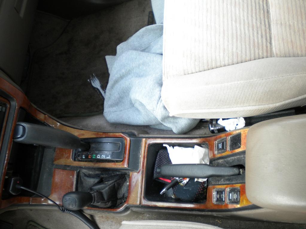

Nelson, the wood on your center console doesn't look stock. It looks like actual wood. Did you replace it?
Haha, no, it is stock. It is delaminating a little bit. Well, actually it isn't eparating, but something is breaking down in there and causing visible change. It doesn't look very good in person, but it isn't so bad as long as it doesn't physically separate.
I gotcha. It looked like varnish starting to peel off. I've often thought about getting it replaced with real wood. Of course that would cost thousands of dollars, and might not last as long as the fake stuff.

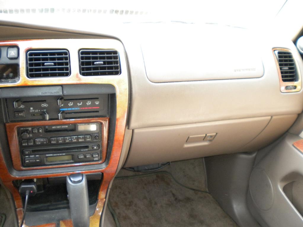

I believe it is varnish and the option was stock. It is also real wood or at least it is in my 97 SR5. Mine was peeling bad when I bought it but have pulled the varnish off and put some coats of polyurethane on them to make it look nicer.
Real wood? Really?! That's incredible. I always thought it was fake because it seemed like plastic, especially compared to the other luxury SUVs (BMW, Mercedes). Maybe mine is real. Hmmm. Looks good, K. :)
[/URL]
It isn't varnish, it is some kind of clear plastic stick-on coating. There is thin wood veneer underneath that gives the wood look. I'm sure it is the same as what you have.
You say you have refinished it? Show us some pics, I would love to see what my options are for making it look nicer.

I do believe the wood or "wood" is different in my 4runner. It has the gold package so I guess it had some other options that were different from a normal SR5 or limited.
BTW, try using photobucket instead of imageshack. For some reason imageshack often only loads a quarter of the picture then freezes (I can't actually see the bottom 3/4 of your first picture). I migrated from there over to photobucket and like it better.
I'll take a picture tonight. Its not the best looking because I half assed it, you can see runs in the polyurethane. It would look better if I took the trim pieces out of the vehicle and lightly sanded them but I got lazy and just painted it on.
Before pictures attached.
Couple notes on the pictures.
The wood around the radio and ignition still has the factory clear coating on the wood so its a pretty good match by just looking at it. The polyurethane isn't has thick though.
You can see where it pooled up some at the bottom of the wood under the vents, sanding would help which I did not do.
The close up of the yota system on the wood shows its not completely smooth and has some texture to it.
Also this is the stuff I used: Polyurethane $10 well spent

Yeah, Mine isn't separating nearly as bad as yours. Your fix came out pretty well though, good job.
