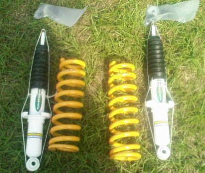

I just bought the Ironman 1.8" lift from CJ80
I found generally good reviews of the Ironman products, figured I'd try it since it was relatively cheap. Always good to explore other alternatives outside of Toytec/OME/Stock
Now need to find some rears to match, thinking I'll just get OME 906 or 890's, and run front and back without spacers. I might try the RC nitro shocks from Wheelers' as they are cheap.
Any reason I shouldn't do that? Is there an OEM LC or taco shock that would work better, or something like that?
This should give me about a 2" lift which is what I wanted in the first place. I think all in all it should come to around $500 with all new stuff (I am getting wary of used stuff)
Hopefully I will have all this in within about 2 weeks, and can install it before I decide it isn't going to snow again and take the duratrac's off and store them till next winter, or a wheeling outing.
