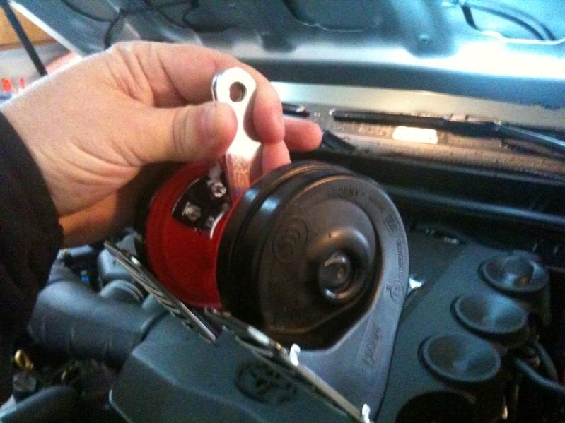

I have a Trail Edition, and it had one horn located on the drivers side.

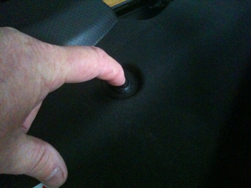

The first step was to remove the plastic cowling allowing access to the horn/ Front of radiator area.
Gently push the fastners (almost like a pop)down holding the cowling in place, I then used my pocket knife to gently lift them and take them out. There were 13 in total

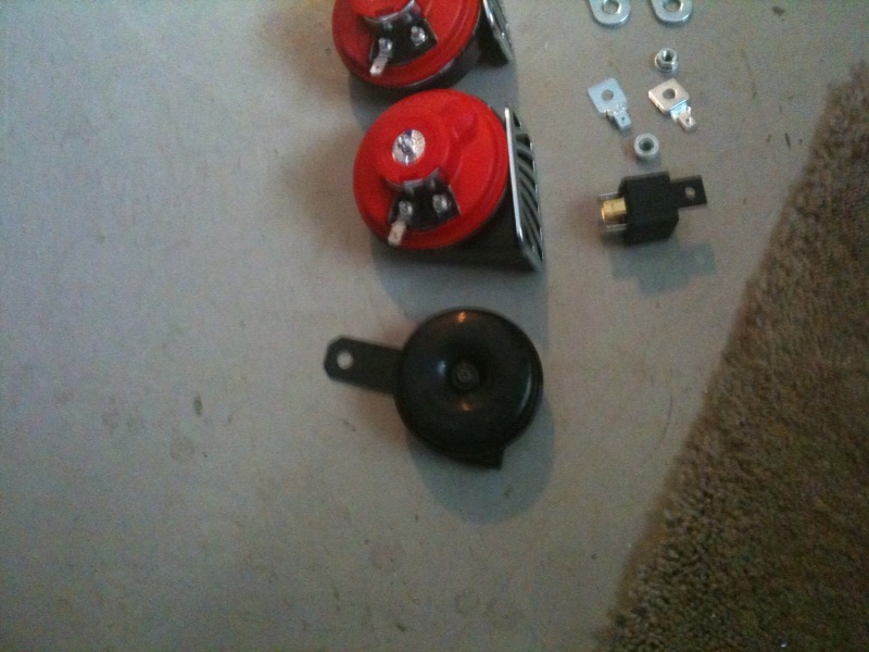

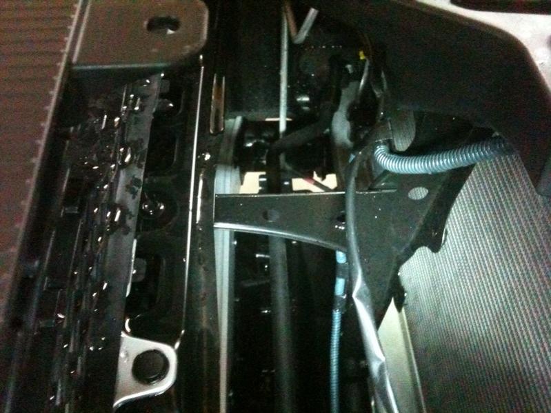

With the cowling off, disconnect the horn screw, and then the power lead snaps off and pulls out.

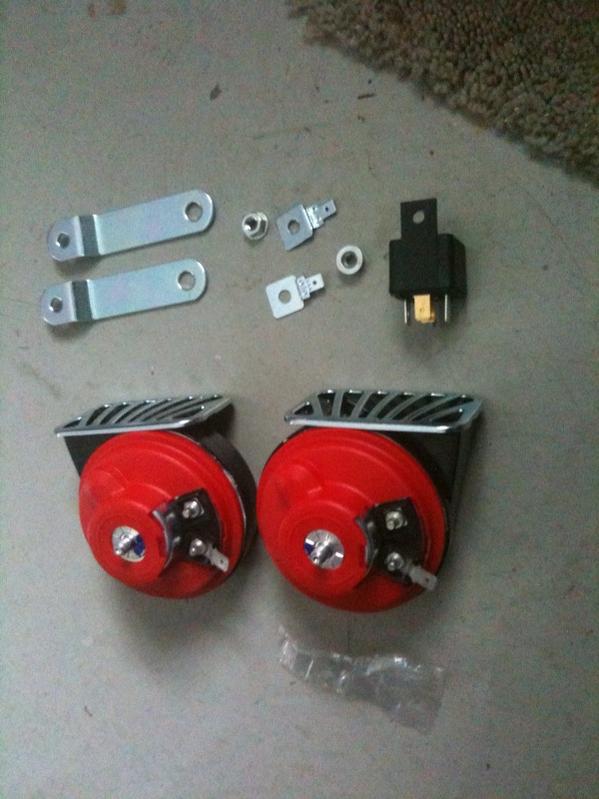

One picture shows all the parts laid out on the floor.

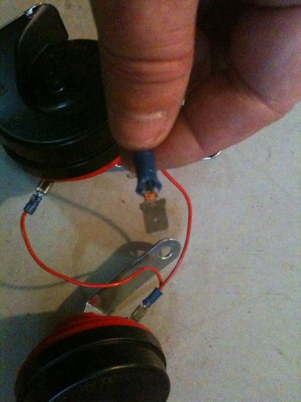

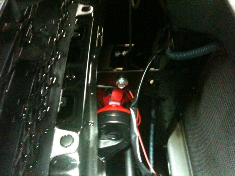

I used the bracket in the middle (directly under the hood latch 8"-10")to hold the horns, there was a hole already in the bracket which worked great, the original location would not fit two horns together.
Next I wired the the two horns, test fit the brackets, insureing the horns were pointed at about a 45 degree angle to the ground...don't want any water collecting in there.
I took a rat tail file and made sure the bracket and screw had a good groundMetal to metal). Installed a 3/8" bolt with washers, and tightend the whole mess down. I touched it up with a coat of clear spray.
Snapped the hot lead for the original horn onto the new blade connector, gave a wrap of electrical tape for protection, tested (worked!!....dont know how in the hell that happened....) and istalled the cowling back on.
One note..the clips seem a little tender, when I re-installed them I grabbed them by the outer edges and pushed gently down until the center button popped back up...then I kind of remolded them wih my fingers, popped them back in the holes, and pushed the center down till it locked....peice of cake.

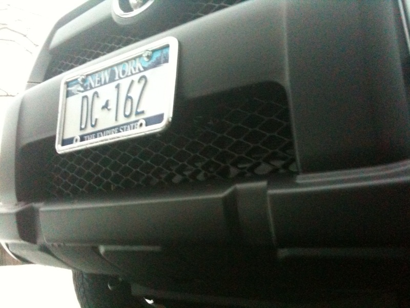

Can you post pics of your horn mounting location? I like TitanPats write up but I don't know if I want the horns sitting right in front of my radiator visible through the front grille.
Also, why did you make a wiring harness? It doesn't look like TitanPat had to and his 4R also has a single horn.
Been trying to figure out how to add a sound file so instead...I ended up with a link to a video of it. It compares the old and the other the new horn.
The new horn was just taken outside tonight.
I'm also including a picture of the front grill to show you that you can't dsee the horns. Their actually behind that black plastic peice that holds the front license plate. They point down and out of the bottom grill.
