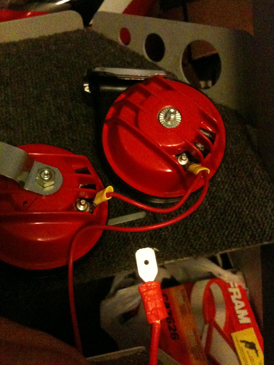

Man I can't figure this install out. I have the exact same two horns, using 16 gauge wire wired just like Wild Fan so finely instructed and it just will not work. I've rewired this thing like 87 times thinking maybe I did it wrong and nothing will work. Any way I can test to see if these horns just don't work without using a voltmeter?
Here is a look. Please be gentle I am very new.

yeah I mean I haven't hooked them on or anything yet I was just testing them by setting them on top of the plastic cowling. Even taped them up a few times... I left the stock horn in place and have been testing through it often to see if I blew a fuse or anything.

The red wire takes power to the horns, but it uses the bolt-on for a ground. You have to connect them to some bare metal on the frame before they can complete the circuit when you press the horn button. Just resting them on the plastic won't provide the grounding you need.

Thank you SeattleMike! I was wondering how that circuit was working haha... Well my horn works great now and I am not embarrassed to use it anymore!
