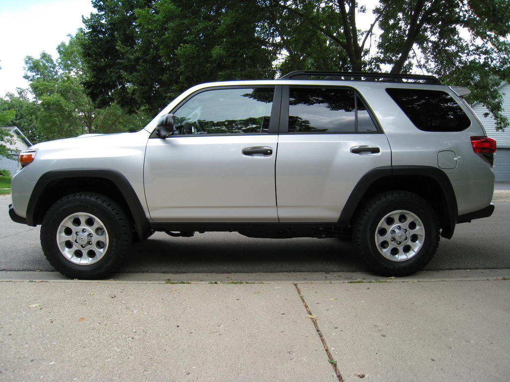

What do you all think of this. I really don't want a big lift. Looks cool but I really drive on road. But hate stock tires. I'm going to upgrade and i also like the look of the red coils and leveling the truck out. I think you will be able to see the red coils through the fender gap. So i may get toyotec Front adjustable coil over kit with Bilstein 5100's. Looks so good. Run stock rear. And when and if i move to mtns i can raise the front and get rears. I also want to run a more aggressive tire like the MT/R in 275s because they won't rub. So stock rears... Front adjustable coil over kit with Bilstein 5100's and 275 MT/Rs.
Also don't like the way the truck squats so much under braking and acceleration. of course accelerating would prolly need the rears stiffer.
but i'm sure the coilovers would help.
here is pic.

Finally put the 5100's on this weekend.... WHAT A GREAT DECISION.
I set them on the 1.75" setting and the front now sits .25" below the rear. I drove 250 miles on them this weekend and was impressed.
Overall: Easy install, much better ride and looks great. I would recommend them to anyone trying to level out their 4 Runner. Next step, purchase and install rear 5100's and stiffer rear coils.
I have pics on my camera at home and will post this evening.
Finally Getting around to posting some pictures... This is a link to the entire album on Flickr Flickr: amikhal's Photostream
If anyone is planning on tackling this themselves, let me know and I can send you the install instructions / a write-up... The front has settled since I took these so it is sitting lower than in the pictures. As I said before, it is about 1/4 inch lower in the front than the rear.

Those shocks IMO is very practical as a leveling lift. Aside from the leveled/lifted look, the ride is improved...very comfortable in freeways and firmer when making a turn..
:bravo:
Looks good - Now did you set the 5100's at .85 (second notch) since your sig says 1.25" for the 5100's? I am torn between setting them at the .85 2nd notch or 1.75 3rd setting? My front is 2" lower than rear on my Trail Edition. Ideal front lift for me would be 1.5 inches, leaving .5" lower in front.
IMO I would go to 1.75"... At first it will look a little higher in front than the back but after about a week mine has settled down nicely

Did everyone set the 5100s to the third notch for the fronts?
Can you post more pics for us all please? I want to level my truck. Also did you install the 5100s on rear too?
I did the 5100's in front at 3rd notch (1.75")lift, which left maybe .25 higher in rear. If you are going to have more than 100lbs in back alot then you may want it at 2nd notch .85? I have 2 dogs and now would like the back maybe 1/2" higher, not sure how? I am thinking of putting the 5100's on the back, but I don't think that will lift it any higher? Maybe those airlifts that support the springs or firmer springs? The ride is better and less bounce in front when braking.
