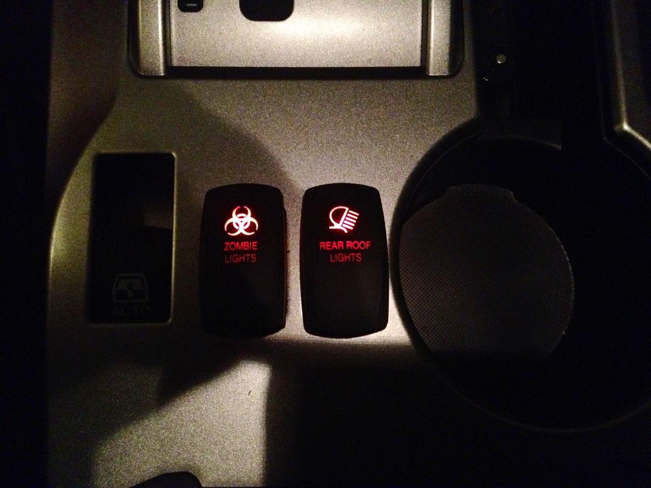

Here are my switches that i just got and installed in te factory holes in my center console. They look great!

Did the switches snap right in or did you have to dremel the hole slightly?
The truth is, haven't had the time to dedicate to the electrical stuff and had it done by my local audio guy. He did state that he had to dremel just a little. I think he might have been lying becuase they look like they would have been a perfect fit.
When I was researching these switches a few months back I think I remember FJ guys not being able to slide these into the factory switch blanks and they required a little dremeling. It would be awesome if it worked though!
It's funny you mention that becuase my buddy just picked up a '13 Trail Team FJ and was looking to install some of the OTRATTW switches. So bottom line though is that they will fit, just with the help of the dremel?
This is correct. I test fit one back before I had my switches installed. The factory Toyota blanks are JUST a bit to small to fit the OTRATTW blanks. But it's pretty simple to solve with a dremel or even a razor blade.
