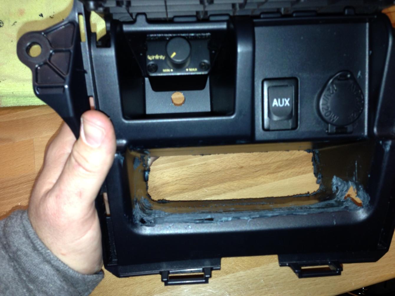

Going to have to dermal to fit... See pics below.... The other option is to try to cut off half of switch one "holder" and half of switch 6 holder... Cause it's really close to fitting in... If you dremal the console it will pop right it... But I am thinking it is way cheaper to first try cutting up the switch holder than the console... As long as you do not take off more than half of the holder the switch should still be secure...

No clue how you got this to fit I keep dremel'ing and dremel'ing and tried drilling and lightning it on fire... I stepped away from it for a min to rethink my strategy... I'll Probably just drive it down to Ducmonsta shop and have him fix it or maybe trade it in and start over?:ybrick:
