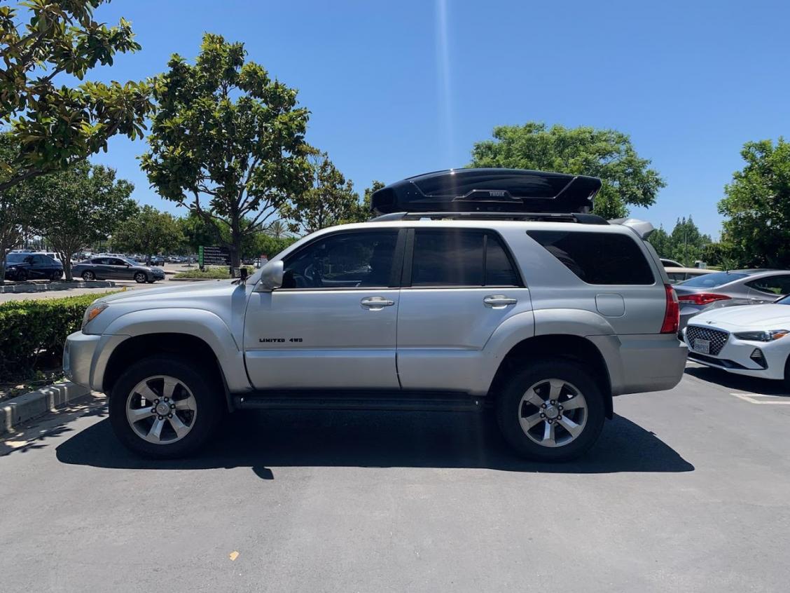

Hey guys,
I searched around and there was a wealth of info regarding tires but was wondering if there was anything to might specificly pertain to constant milage.
Little back story, my wife and I and our two small dogs are going on a 3 month roadtrip across the country. We're hitting about 30 states and 20 national parks. We'll have a Tepui RTT, Dometic 75 and all the other goodies.
I am looking to get some fresh tires for this trip to make sure we're good to go. I have a 2006 Limited with stock 18" wheels with a 3in lift.
May I ask for some input on what you guys might suggest? I will be doing minimal offroading, mostly pavement and the occasional dirt trails but would like to be prepared for any terrain.
229,000 Miles and counting! As she sits right now.
Thank you so very much for your input!
