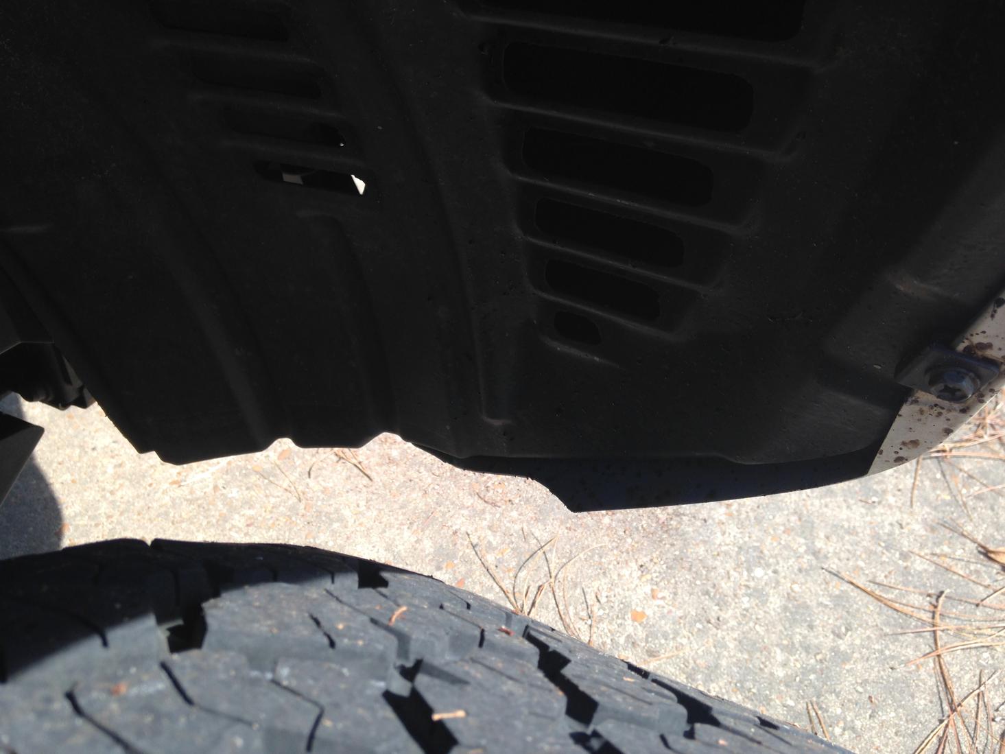

No paint, After the cut. It is so far in on the fender nobody can see it unless they are under the truck or specifically looking for the cut.
I had to start at about the inside 1/3 of the lip. I turned my steering until the tire was touching or close and marked the fender, then cut it in toward the frame after straightening the wheel again. I took a little more off than I needed on the passenger side, but not enough to bother me. Mind you I moved the fender liner forward first. This is looking down past the front of the passenger side tire.
