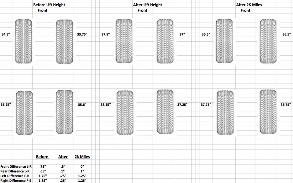

Updated lift info
Here's an updated set of measurements on my lift after a couple of off road trips, 2 months and a little over 2000 miles.
It's also worth noting I did install a Warn ZEON Platinum-S winch during these 2000 miles between measurements. Interestinging it even out the front L-R and took about a 1/2" off the front overall lift. I guess 75 lbs will do that.

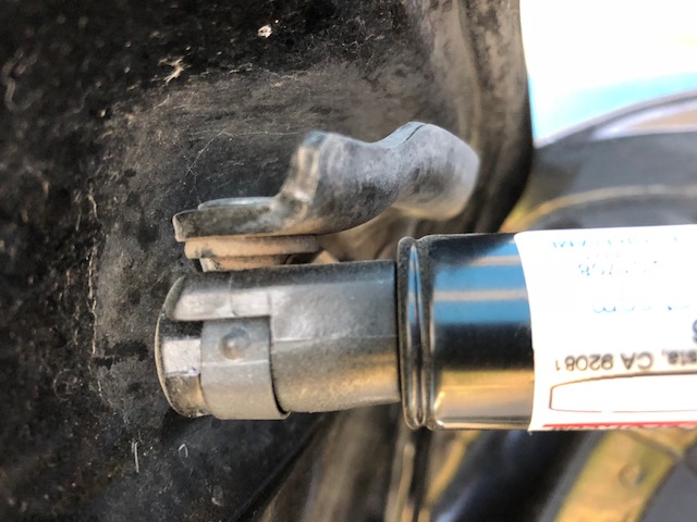

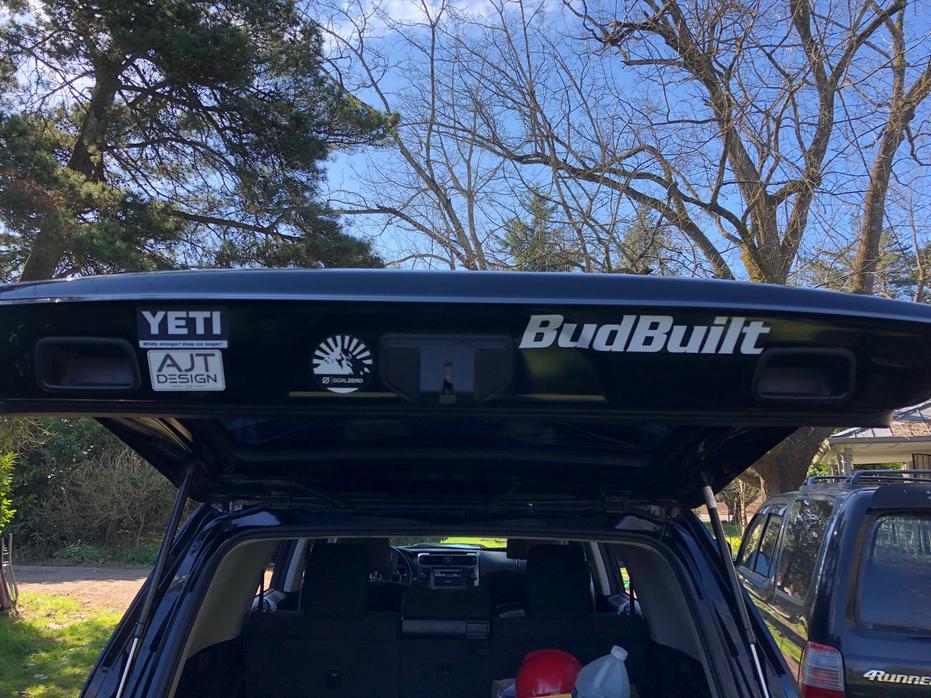

Lift Gate strut replacement

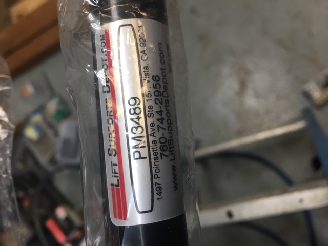

If you have a blown strut you will know, one strut will not hold up your hatch!
In my case they were getting weak and the hatch would not stay all the way up. So I figured this was a cheap enough fix.
I only took a couple quick pics, but just wanted to post what I used here for anyone doing a search.
I bought these from Amazon 4Runner Lift Gate Struts
I saved the end clips off the old ones and used them on the new ones. This is a 2 person job. The new struts come with the holes lined up straight, you will need to attach one end and rotate the strut 90 degrees so you can attached the other end.
They work like a charm, now my hatch stays up approx another 4" and I don't walk into it any more! :D

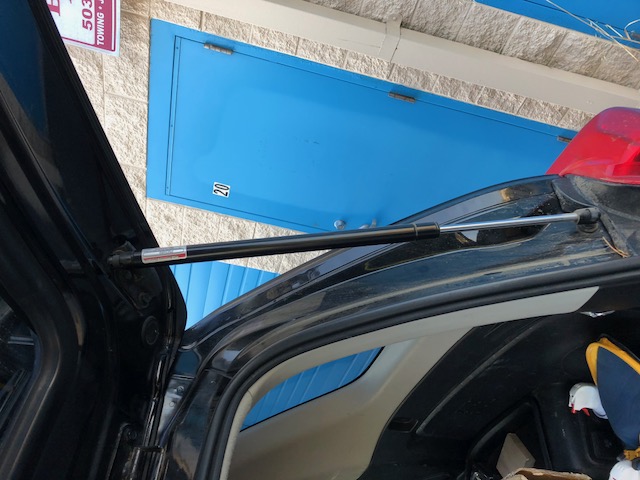

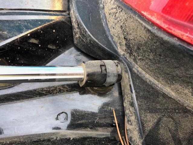

A few more pics
I took a few more pics to show the clips and how the ends are turned 90 degrees from each other. Please forgive the dirt, I just got back from a week of deer hunting.

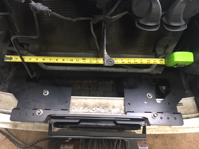

Hidden Winch Install

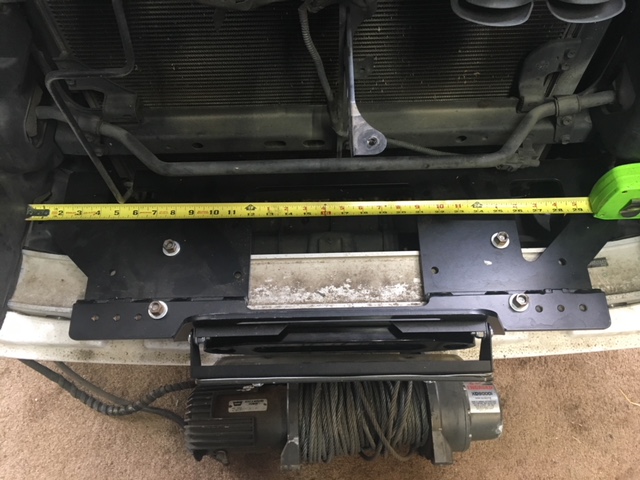

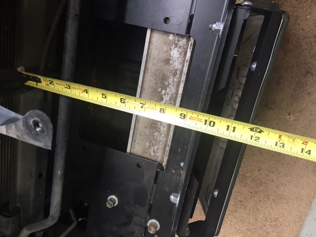

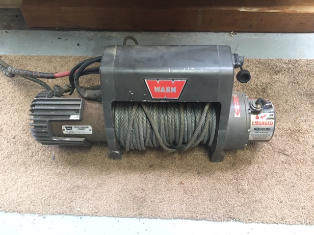

Okay so my goal for this mod was to install this XD9000i from my 3rd Gen on to the hidden winch mount.

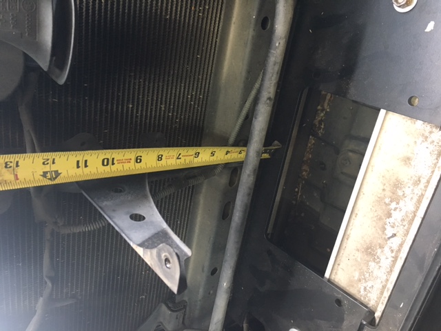

I started by measuring all the space I had.
I quickly figured out it wouldn't even be close to fitting.
Looks plenty wide enough.....

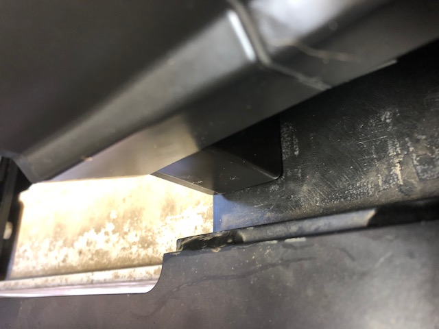

I included the tape so if anyone was curious about the amount of space they could see it for themselves.
Basically the XD9000i is too tall to fit under the brackets that hold the hood latch and grill.
It is also too wide to clear the vertical air conditioning line running down.

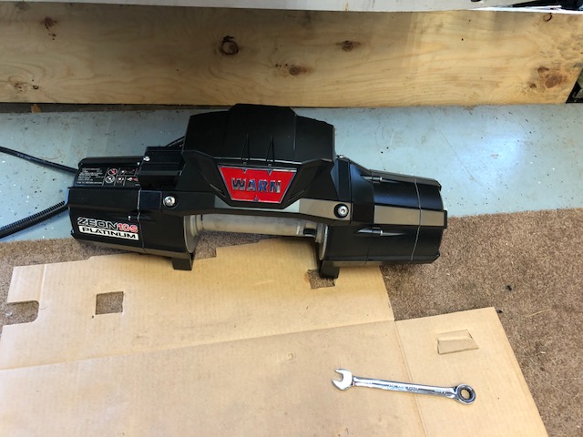

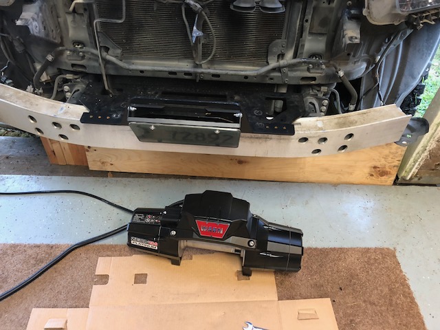

So I went with plan 'B' Not cheap, but damn nice!

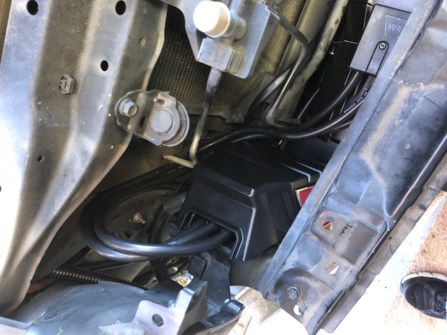

Hidden Winch Install part 2

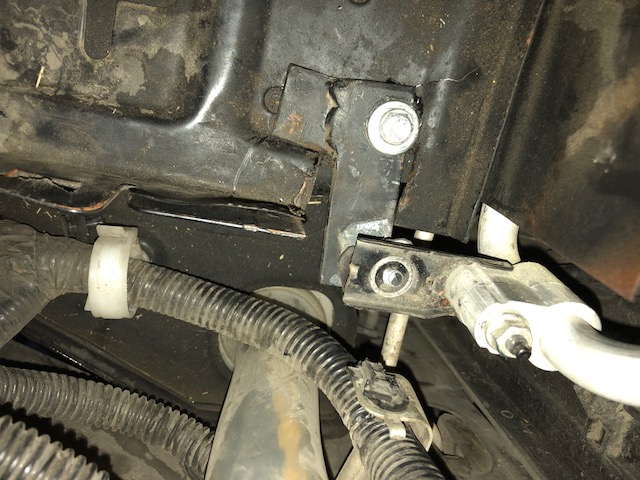

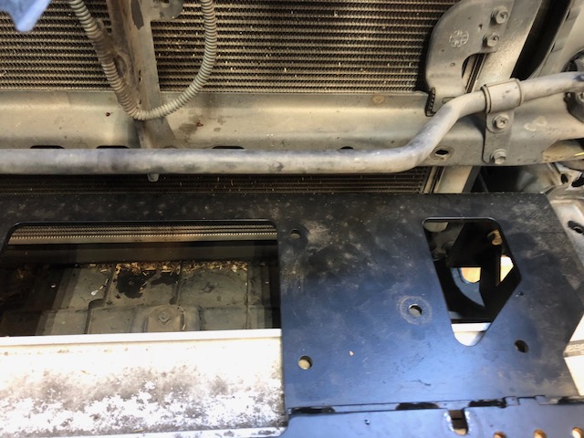

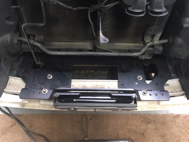

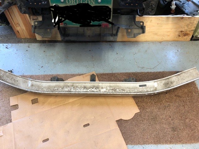

The first issue is in order to bolt the winch down you have to remove the OEM bumper.
You also have to loosen all the brackets holding the power steering line (vertical line) to gain enough clearance to mount the winch. The line sticks to far forward and it has to be rolled up to get clearance.
I will eventually relocate this line up about 5 inches and remount it to in front of the radiator mounts.
Once it is removed you can get the new winch mounted and get underneath to bolt it in place.
BTW there is no freaking way this new winch will fit without relocating the solenoid pack from the top to else where.
You can see I removed it.
I had to loosen all the clamps holding the power steering cooler line so the winch would fit.

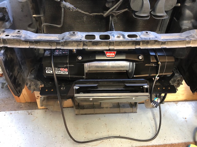

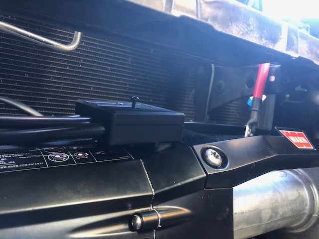

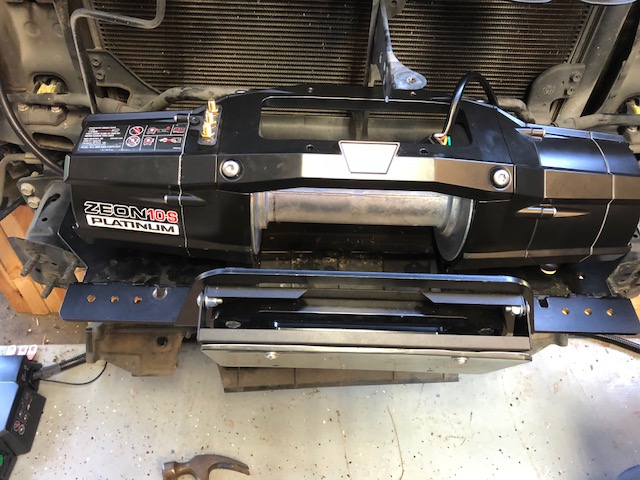

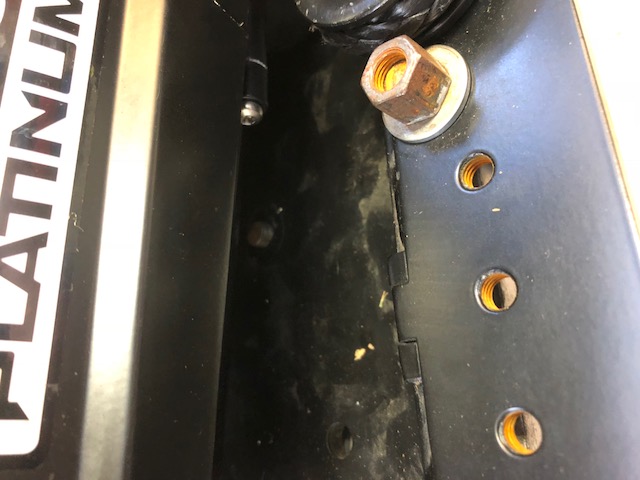

Once it's bolted in place, I started working on the wiring.
Hidden Winch Install part 3

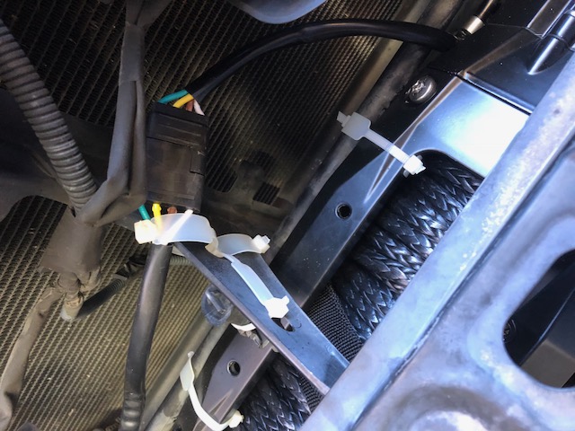

I'm pretty un-happy that the provided holes place the Warn Winch an inch back towards the radiator. This complicates the power steering cooler clearance and the A/C line clearance. I can only assume other winch brands need more space forward. It's possible to drill new holes, but I didn't have time to do this, so I just went with it for now. At some point I will circle back and decide what I really want to do with this. The main issue that needs solved is the power steering cooler line clearance.

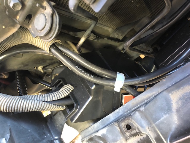

You can see that I mounted the solenoid on the left side. I'm not really happy with this location either. This will be eventually moved up into the engine bay for easier access. It has and on/off switch on the back side for the wireless remote. It also has terminal connections for lights on the back that are also controlled by the wireless remote.
Using the relocation kit to run the control wires elsewhere.

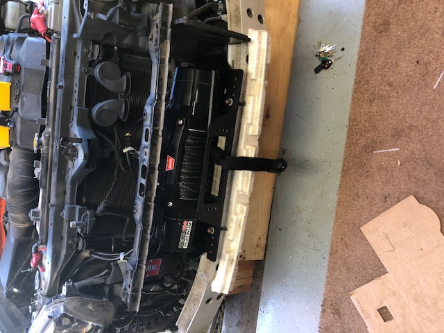

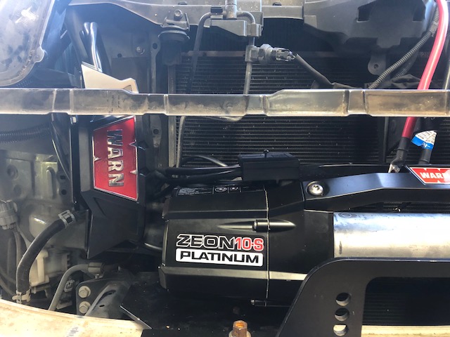

Hidden Winch Install part 4
Here is it almost all done and fit in place
I zip tied down all the wiring, as well as zip tying the power steering cooler down so it isn't flopping around.
The u-bolt that was clamping the bumper to winch mount is now useless, I left one side of it bolted but I will remove it later.
I could drill more holes to use it, but I also did not have time and it will have to be done later.

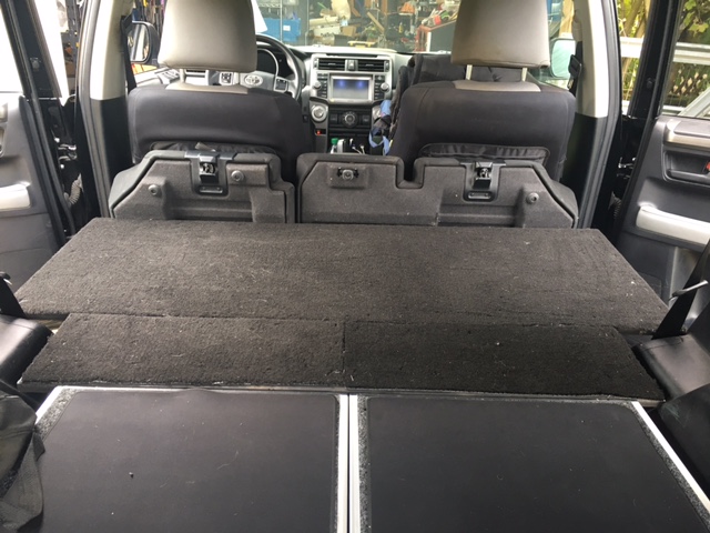

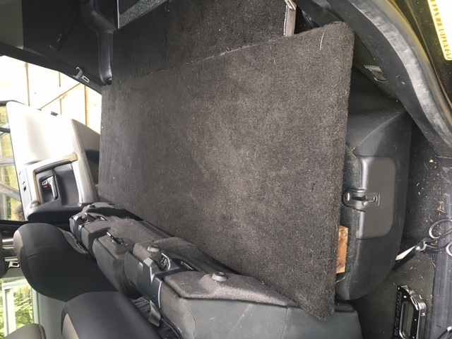

Being a tall guy, when I made the sleeping deck, I for some reason ran the front seats up all the way forward. I guess my thought was I at 6' 2" I needed as much length as possible to lay down with out really checking it. After driving around a couple days with the sleeping deck in I realized that I need the leg room while I'm driving more than I needed it in the back. Plus I can always run the seats forward again after I am out of the cab for the night.
This gave me an opportunity to change a couple things.
After running the seats back to where I was comfortable driving, I needed to trim 3" off the deck. So it is 28.5" deep instead of 31.5." I took 1" off the short side and 2" off the long side. What this really does is make the cutouts for the wheel wells 9" x 5.5" on each side. This gives me a much more finished look with out a few of the larger gaps in the corners between stuff.
My OCD also kicked on a little, so I also took the time to finish the carpet better, wrapping the corners and covering the bolts with carpet, spray paint the board, etc.
It looks a lot better now, plus I can install it and still drive :lookout: without getting a cramp.
Next time I yank it out I think I might make it a bit narrower, so I can just flip it up in to the back when I need the seats. As it is now, I have to pull it out walk it around and place it in back or remove it totally, by making it 1-2" narrower, I could just slip it back.

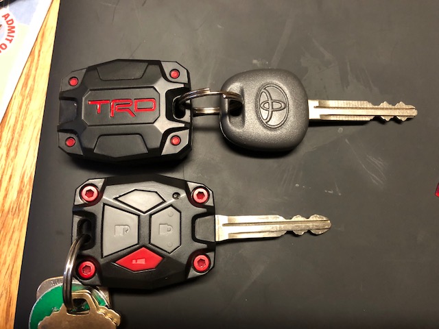

Key Programming
With my techstream setup above all ready to go, I purchased these key blanks from Amazon. I wasn't sure which would work so I bought from different sellers, turn out they are identical, so buy the cheaper ones.
2 for $30 or 1 for $23
Note: The original 2 for $30 link was not f'ing Walmart (it was also amazon) - Damn forum software is scraping links to get a kickback for admins
https://www.amazon.com/gp/product/B00Y1HRV9Q/ref=ppx_yo_dt_b_search_asin_title?ie=UTF8&psc=1
I had the local true value guy cut the keys. Since I brought my own blanks he cut them for $1 each! Ha...basically since I had the cable, all I needed was a key blank and a cut, and I can make good usable keys for about $16 bucks each. Which I promptly did!! I made all 3 and they work perfectly as good as OEM. (I had to go back and get the 3rd one cut)

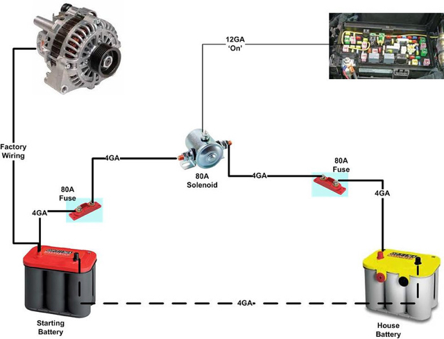

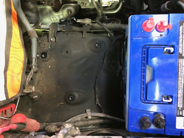

Dual Battery setup
I just got done upgrading my dual battery setup so I thought I would post a few pics and comments.
First off for the wiring I used this post to get it all setup. I pretty much wired it exactly like this.-->Dual Batteries on the Cheap.
http://layton.org/t4r_org/simple_dual_battery.jpg
The pic shows it wired to the fuse box, but it's a generic pic and there is no switched 12v line to tap into under the hood. To find a switched 12v source you need to go into the cab on the t4r. Just pick one, I don't even remember which one I tapped.
I didn't buy the cheap parts if you are wondering, it wasn't really about the money(well ok, maybe a little), it's more about a simple and practical setup. I bought the 500amp relay and heavier cables just for reliability and durability as much as anything.

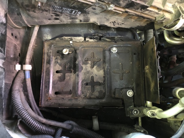

I cut the OEM power steering fluid bracket and screwed it to a simple "L" bracket that I made from a piece of thick sheet metal. I made the bottom long enough I could slide it under the batter tray and drilled it to bolt down with the battery tray. This way I can adjust it if I need to. You can see it on the right in the photo above.
Plus a little better in this one.
http://layton.org/t4r_org/img_b0716.jpg

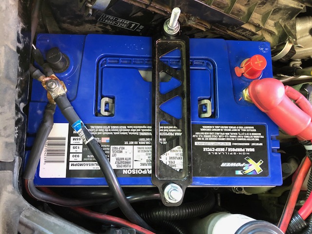

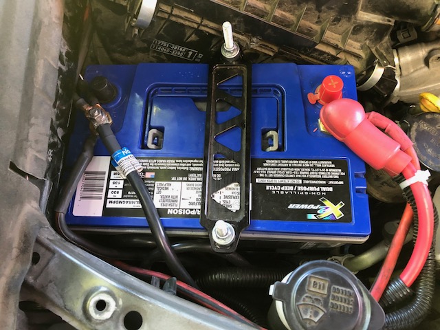

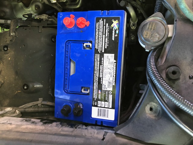

So now, I'm wanted a bit more juice for the second battery. Plus the Diehard is about 5 years old now, so after some research I figured I could stuff a Group 65M battery in the same spot as the Group 34M. The size difference is only about 1/2" - 3/4" in width/length. The height is about the same. That meant reworking the bracket I made to hold the air conditioning line, but nothing major. Just had to move the mount about 1/4" further out to clear and fit the battery in.
http://layton.org/t4r_org/img_b0717.jpg
Since this battery is a bit bigger, I couldn't just drop it in, I had to remove the air box. (@#$!!) No big deal, but kind of a pain. 3 bolts, hose clamp and a wire harness and it comes right out.
http://layton.org/t4r_org/img_b0718.jpg
http://layton.org/t4r_org/img_b0710.jpg
A skinnier air box wouldn't hurt! Anyone know if the fancy TRD model is any skinnier?
http://layton.org/t4r_org/img_b0720.jpg
http://layton.org/t4r_org/img_b0721.jpg
