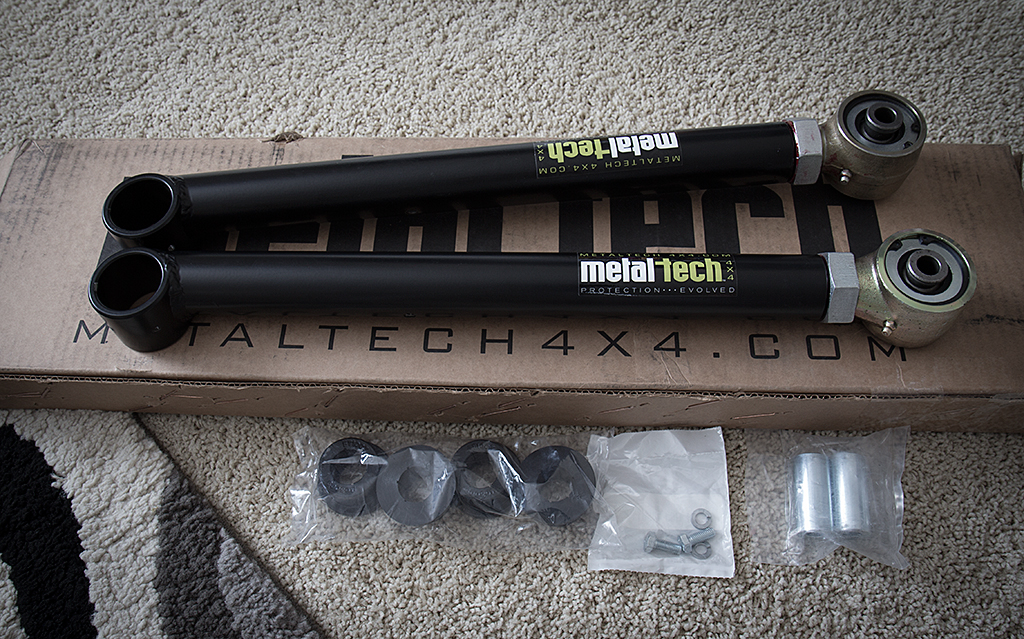

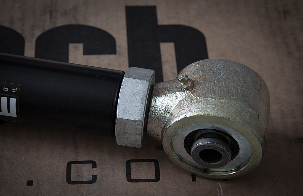

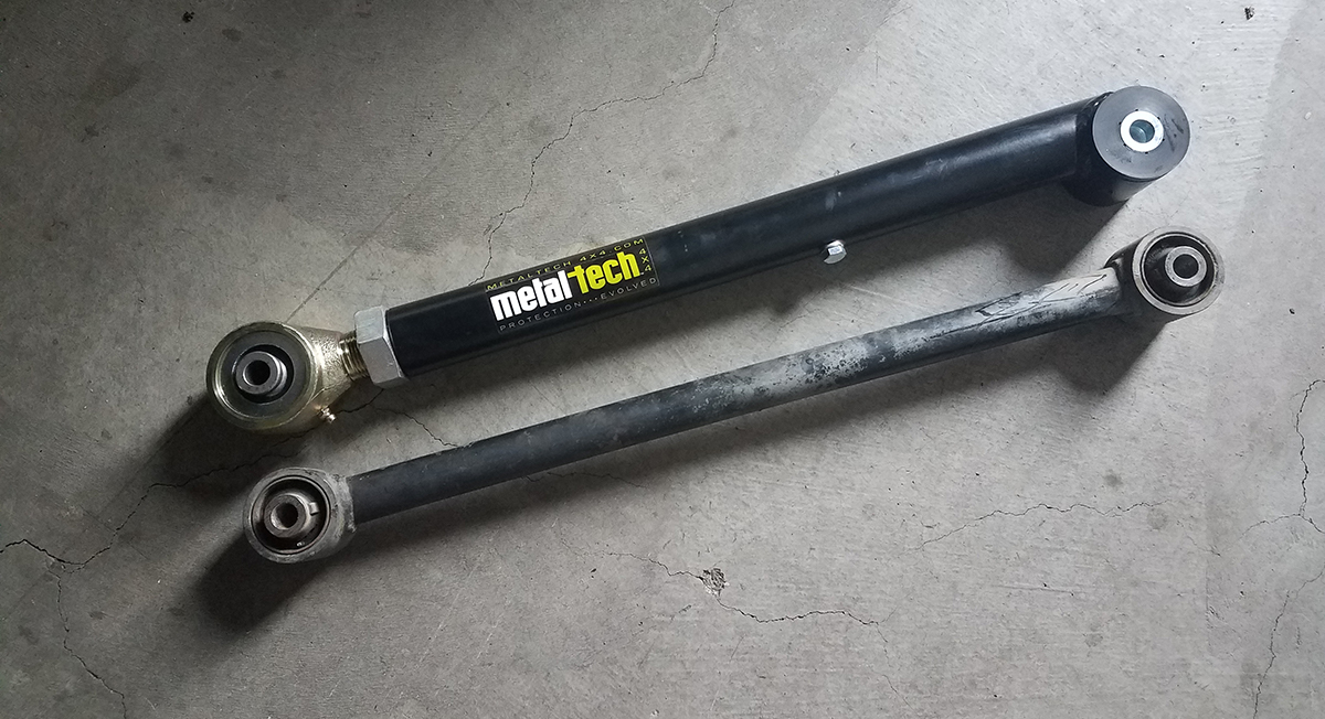

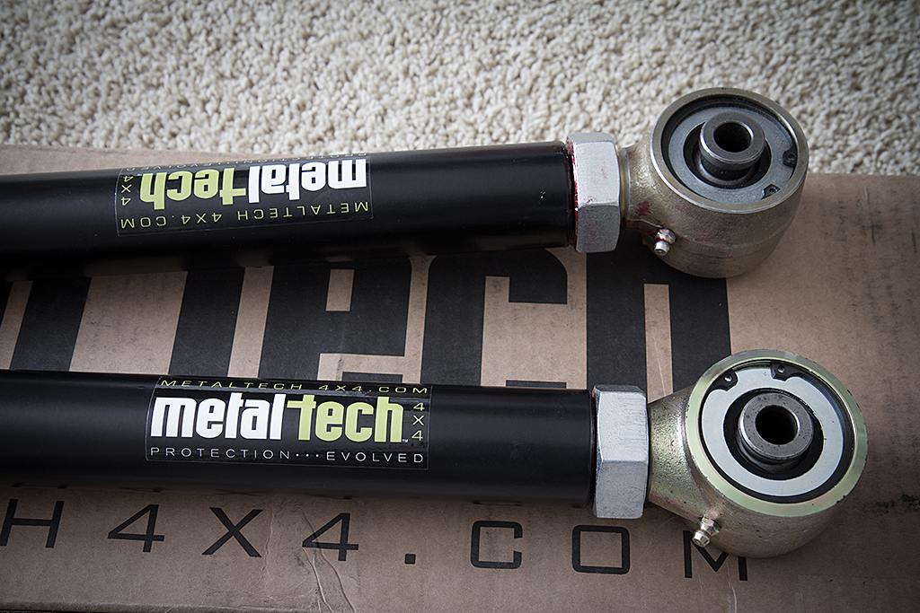

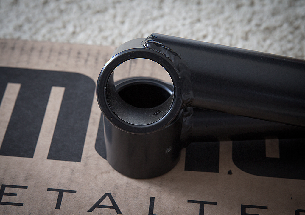

Last Summer, I picked up a set of MetalTech4x4 rear lower control arms. Here are a few pictures after the unboxing:
These things are freakin' beefy!

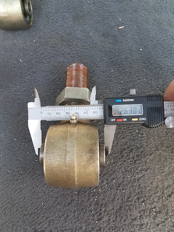

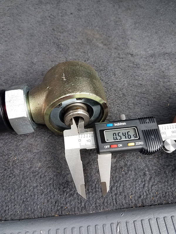

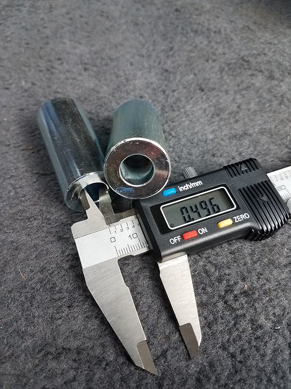

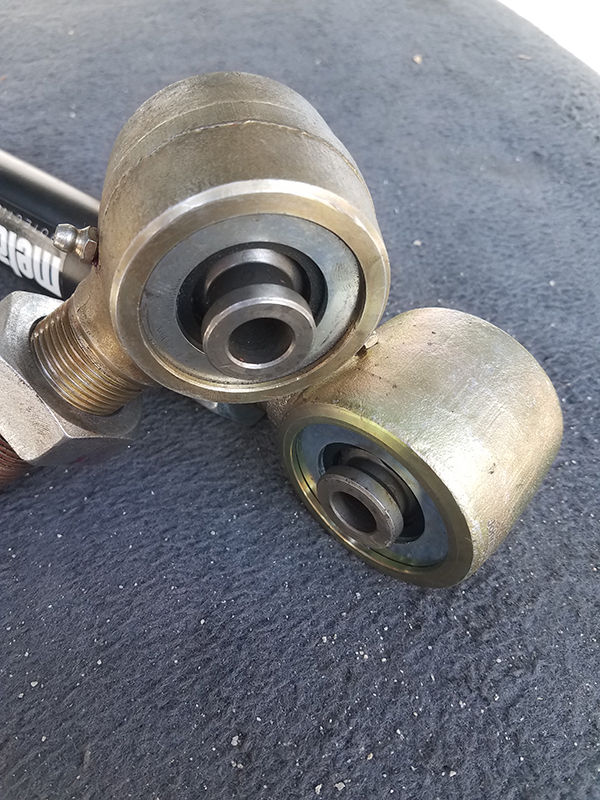

Anyway...I sat on them for a few months before getting the time to install them. After I had the rear end apart, I found out that the metal sleeves in the polyurethane bushing were the wrong size. The inner diameter was too small.
Here is a picture showing the inner diameter of the sleeves. And then a picture showing the inner diameter of the sleeve in the Johnny Joint (which was the correct diameter)
After a quick email with pictures sent to MetalTech, they were very responsive, and sent out a new pair of bushing sleeves that day. I gotta give it up to their customer service. They were really on the ball!

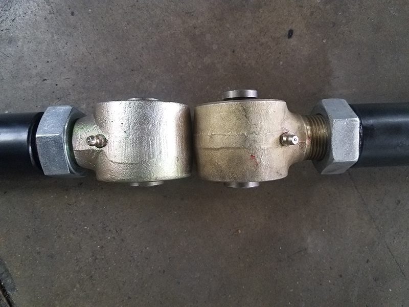

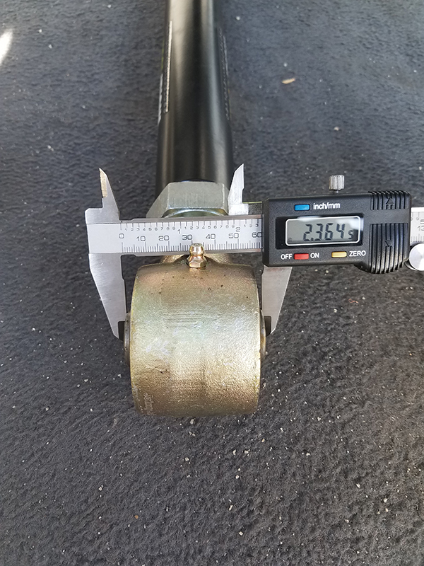

After I got the new sleeves, it took another month or more to find the time again to re-attempt the install. This time around, I discovered that one of the Johnny Joints was the wrong size! lol It wouldn't fit inside the bracket on the frame. Of course, I didn't discover this until all the stock parts had been removed again. lol So after putting all the stock parts back on, I took pictures of the Johnny Joints and sent another email to MetalTech. The next day, a new joint was in the mail on it's way to me!
Here are a couple pictures comparing the 2 joints. You can see that the "sleeve" part through one of them is longer than the other.

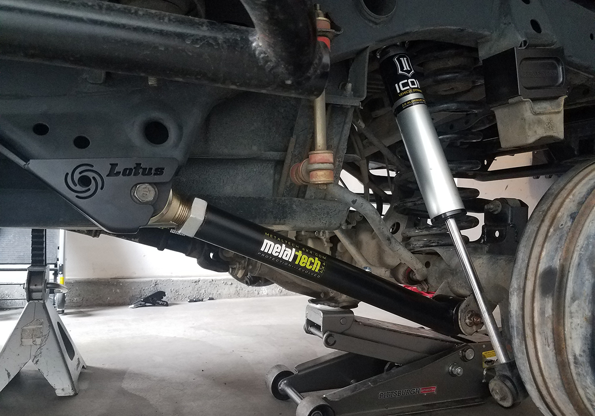

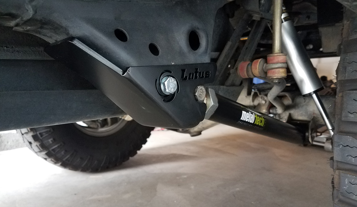

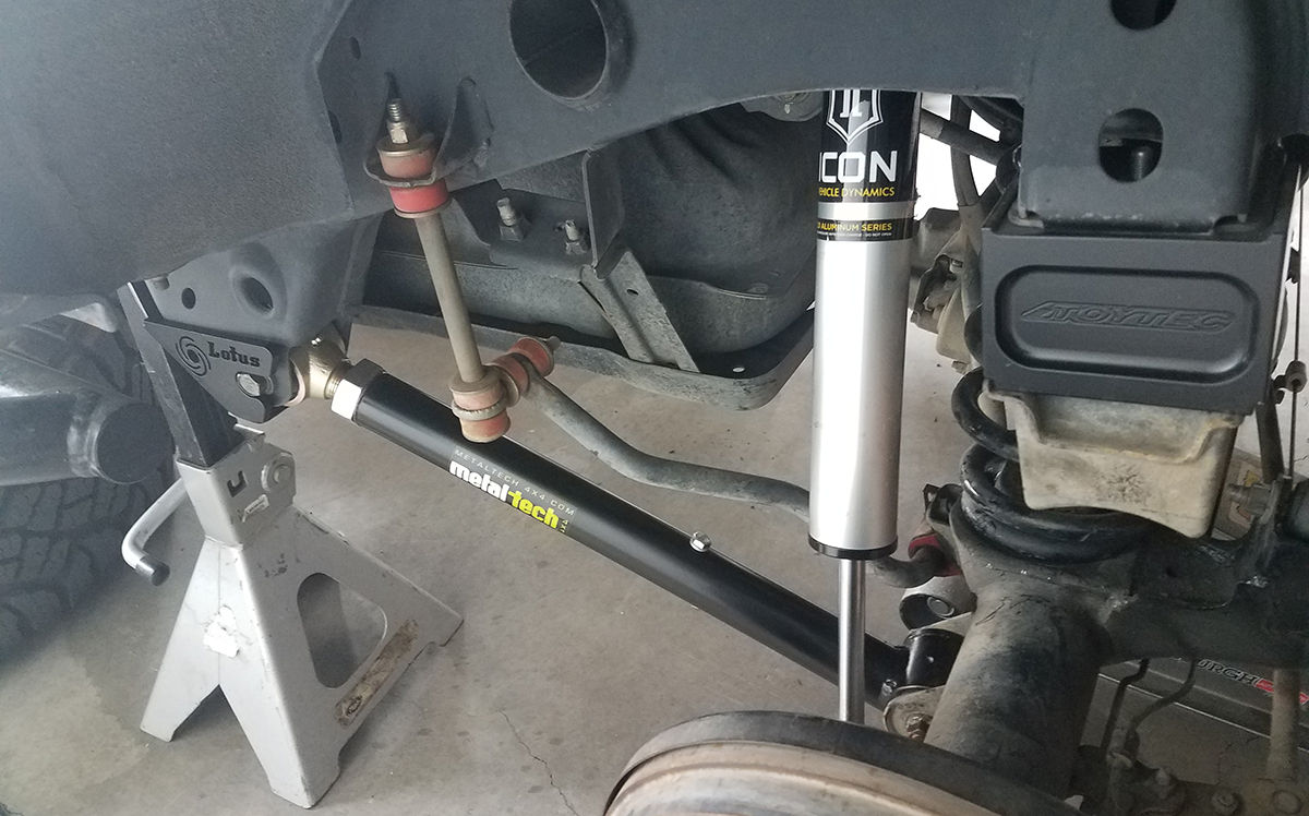

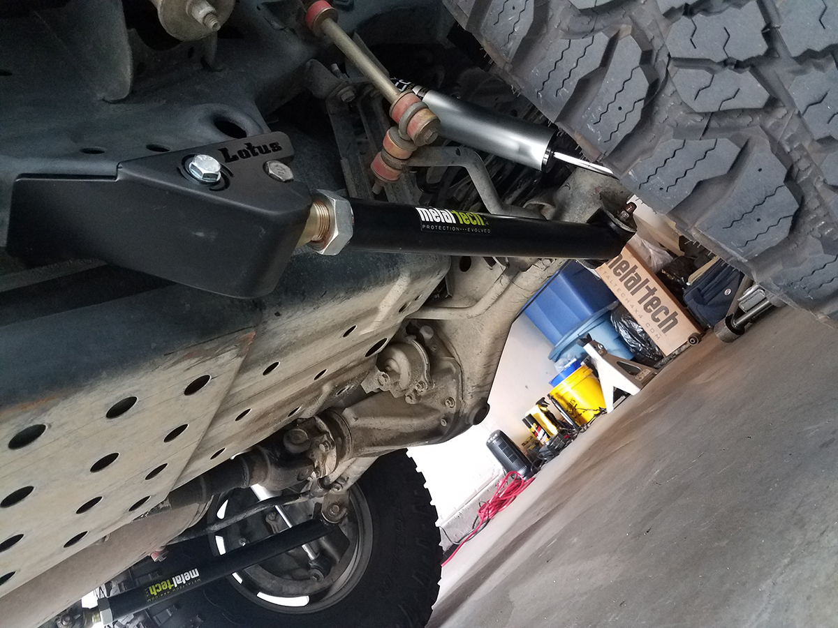

This past weekend, now having all the correct parts, I was able to finally bolt these bad-boys onto my 4Runner. The job was super easy (now that this was my 3rd time doing it! haha)
Here is the new arm compared to stock:

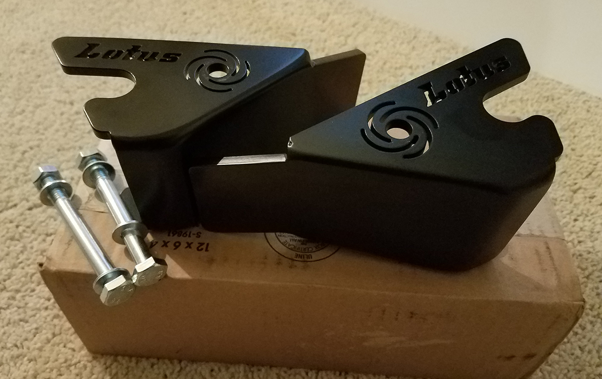

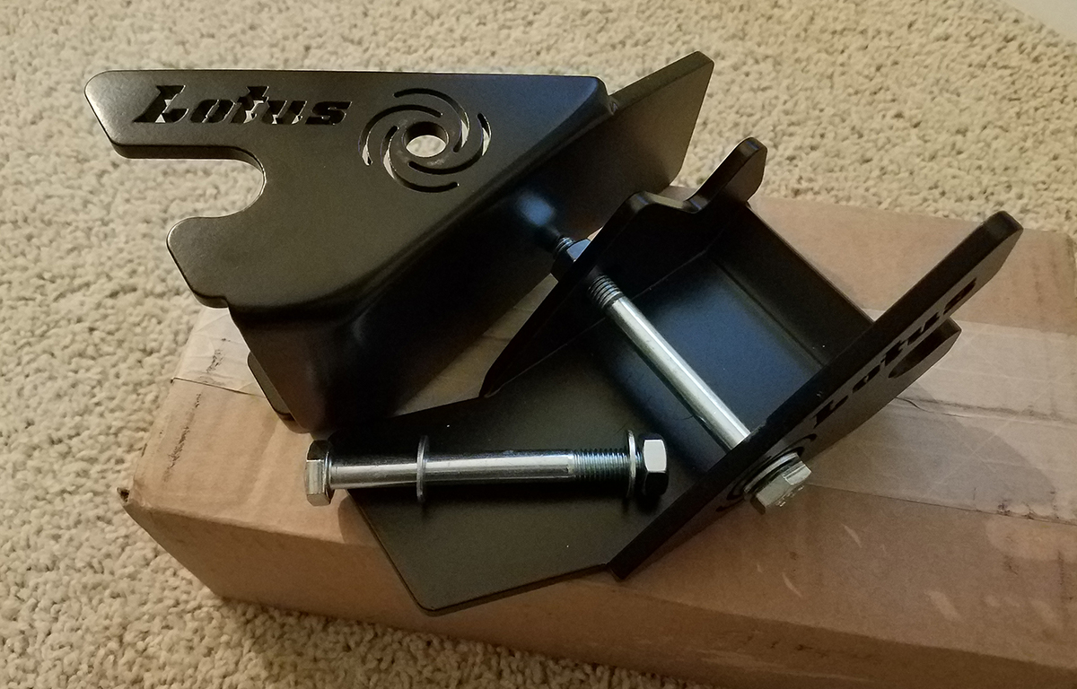

In the "installed" pictures above, you might also notice the Lotus rear control arm skids. My sister in law just got those for me for Christmas.
The install was pretty straight forward, as you'd imagine. They just took a little massaging with my small sledge hammer, so that they conform better to the contour of the frame bracket.
You can already seem them install in my post above. Here are a couple "unboxing" photos of them:
