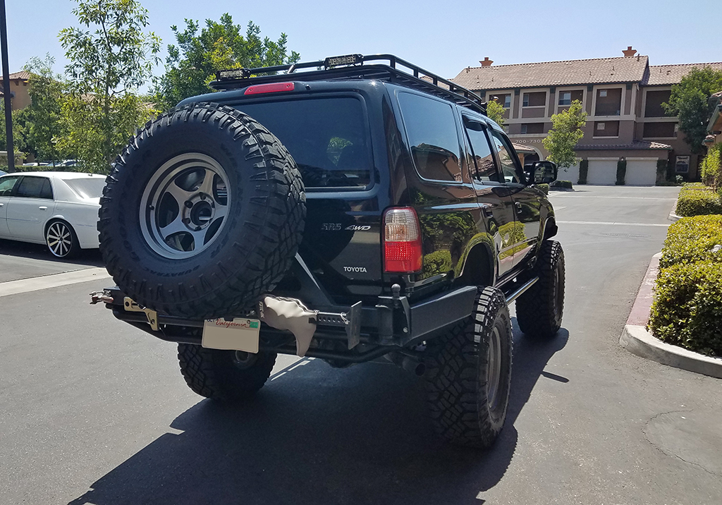

And here's a shot of my 4Runner, all shiny and clean, with the lights and rear springs installed:
Great looking rig! I am running a similar lift setup. Ultimate with the 861s but have more of a rake than you do. How high are your front coilovers adjusted here? All the way? mine are about 1/2 way and I want to know how far you can go or what is ok and how well it rides?
tia
Sorry for the late reply.
As for the minimal rake on my setup....keep in mind I have a fairly heavy bumper/swing-out/spare/hi-lift/etc. setup in the rear, which helps keep the rake from being too obnoxious.
Also....my 861's are installed on the wrong side in that picture, so the driver side rear is a little lower than it should be.
Unfortunately, I don't recall how far the front spring perches are from the tops, but I do remember wrenching them up a little before installing them. If I remember correctly, ToyTec ships them set up for 3" of lift. I'm guessing I'm at about 3.5".
The ride is a little on the stiff side overall. It doesn't really bother me but, then, I come from a background of lowered Honda's set up for track use. So I'm pretty used to stiff suspension. I'm sure it would be too uncomfortable for others.
Hopefully that helps!

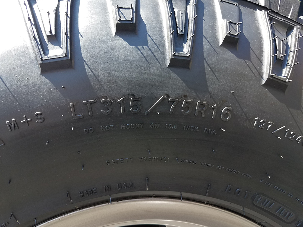

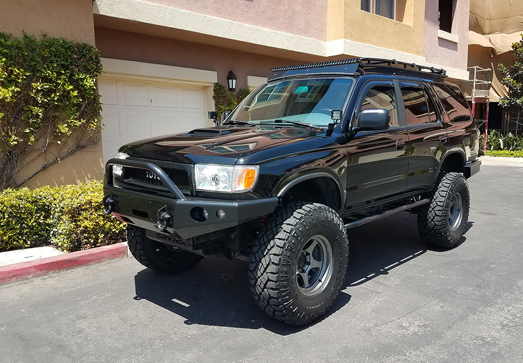

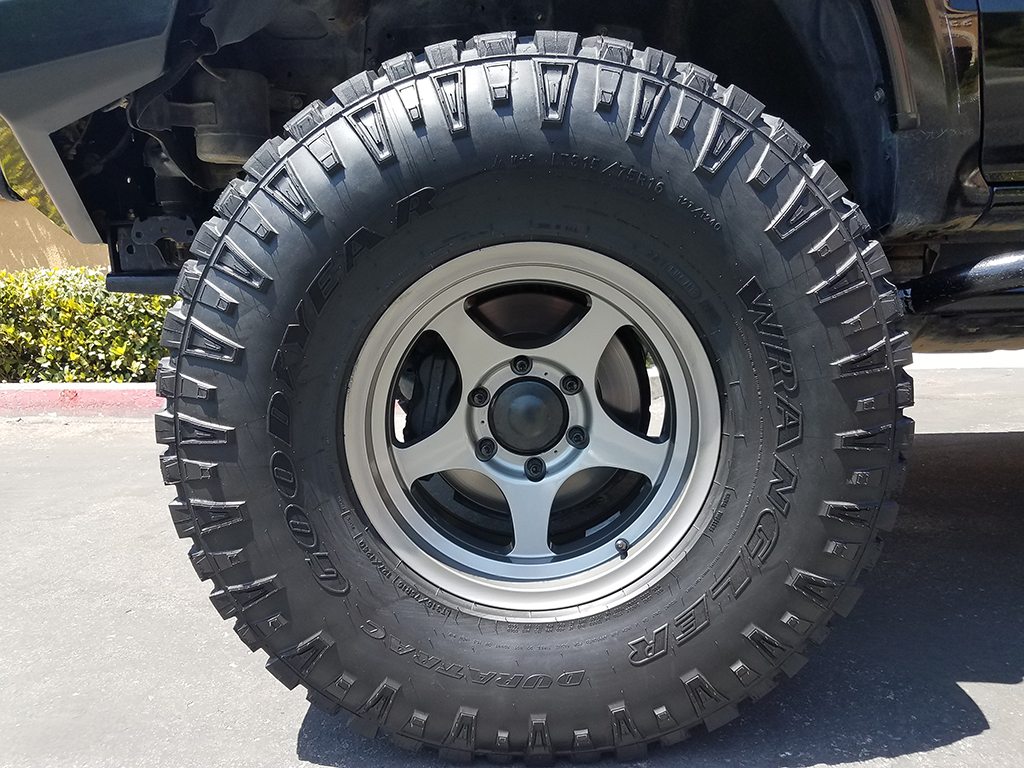

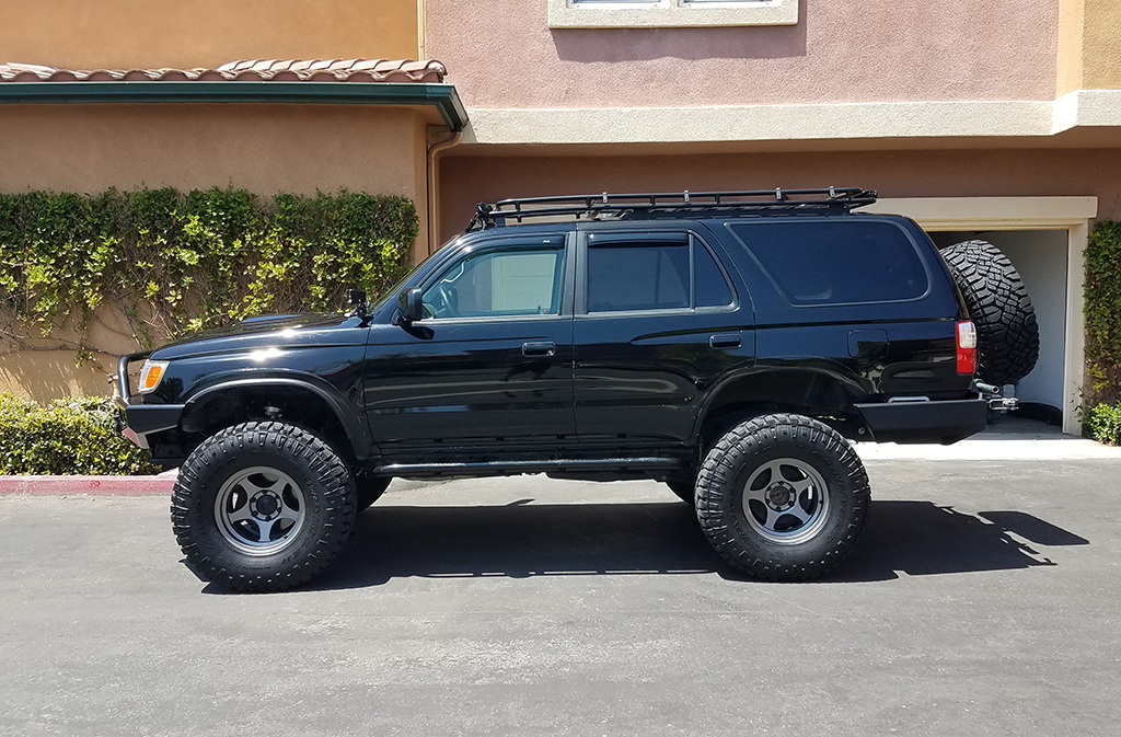

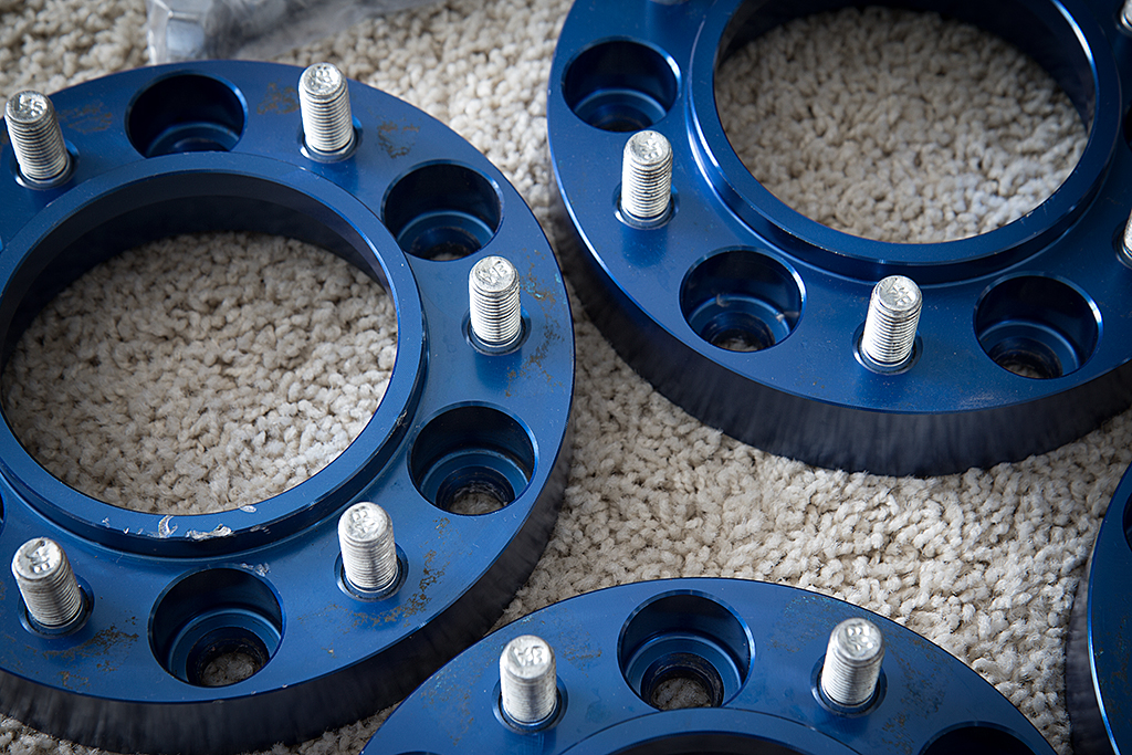

It's been a while since I've updated this thread! I'll try to get some more pics and info up soon. But for now, I'll update with my new tires....
I've been running 285/75/16's (33's) Wrangler Duratracs for the past 4.5+ years. I always told myself that when it's time for new tires, I'd step up to 35's. Well, my tires had been wearing down more and more, and then 4th of July hit and Discount Tire Direct had some good deals, so I pulled the trigger on a set of 5 315/75/16 Duratracs.
With my 1.5" body lift, I figured I wouldn't get as much rubbing as most people do.....but, umm....yeah....lots of rubbing! lol I can only turn the wheels about 30% before they hit the front of my sliders. I'll need to trim off the front of them and weld on an end plate I guess. After they clear the sliders, then I can see where they contact the wheel wells, then go from there. For the meantime, I'll end up installing a set of Spirdertrax spacers that I've had sitting around. Hopefully that will give me slightly more room to turn the wheels until I can modify the sliders.
Here are a few photos....
If I can get all the clearancing taken care of, my next step is to order a set of 5.29 gears. Hopefully all that will happen in the next month or 2!

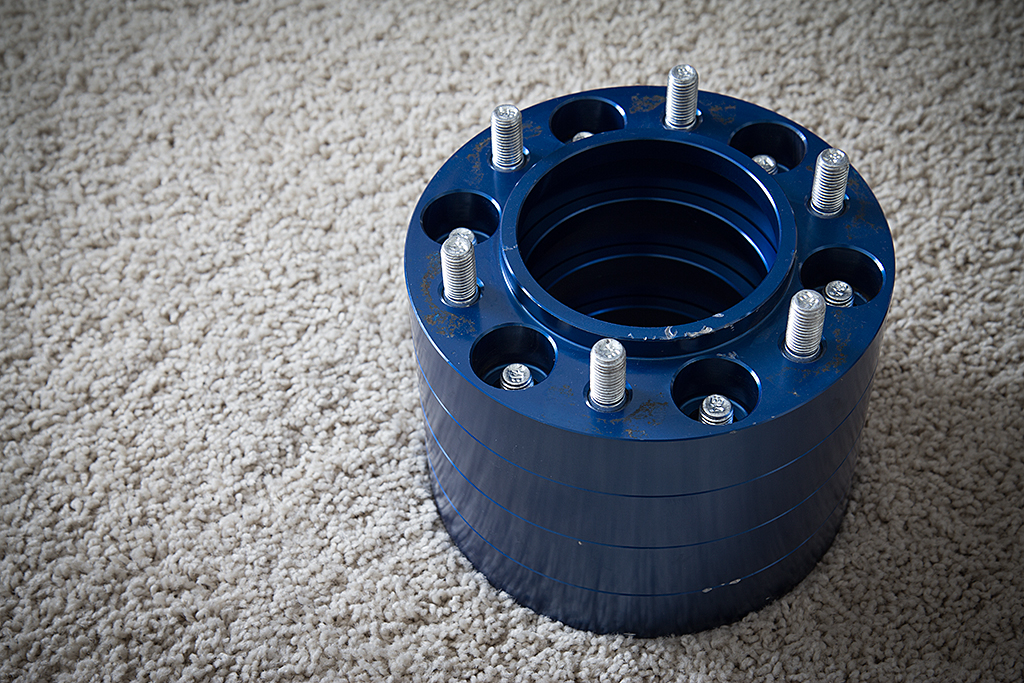

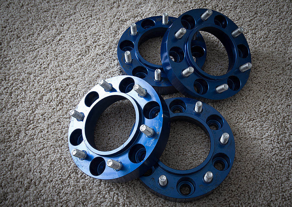

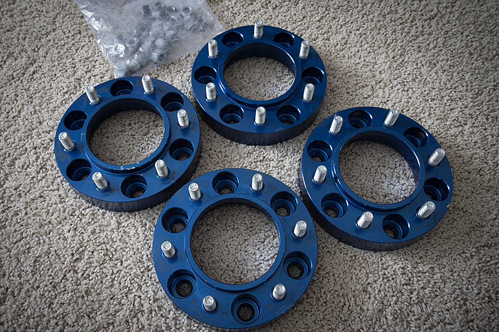

Since I mentioned the Spidertrax spacers, here are a few pics of those. I picked them up used from a forum member:

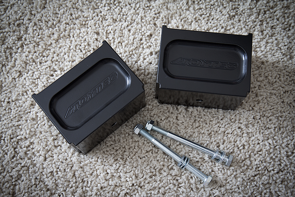

Also while I was prepping for the 35's, I found a deal on a pair of Toytec rear bumpstop spacers. I really dug how they were freshly powdercoated by the previous owner, making them a little more stealthy. I bought them figuring I may end up needing them if the 35's give me problems in the rear. They'll be one of those "will only install them if I need them" type of items.

BTW try to have your caster set all the way forward, should help bring the front tires forward and clear the sliders a bit better.
Man, you have one sweet looking rig. I like those FN 5 stars more and more every time I see them. And, those are some big shoes on there too. I rub with my 285s, I can't imagine all the drama that 315s would cause me. LOL. I want to find a good local alignment shop that knows how to adjust SPC LR UCAs. I should be okay then.
