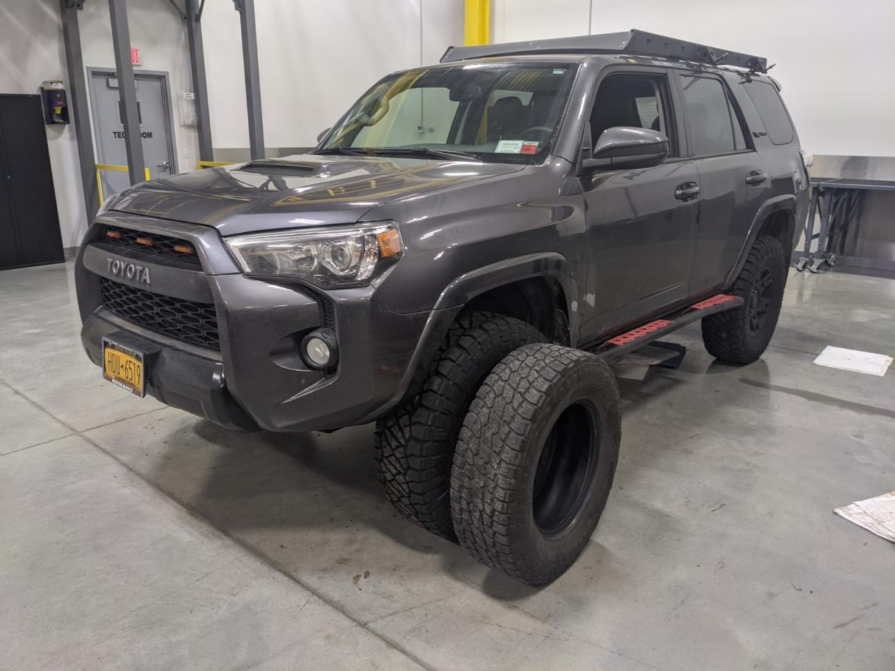

Hoping someone can give me a gut check. Got Town Fair Tire to match the price and 10% rebate Discount Tire was running yesterday on some 285/70/17 C rated yesterday. They ordered the tires and they will be here Wednesday.
I am worried I am going to rub. Truck is lifted with Bilstein 5100s at the second highest setting (I think thats 1.75") and Cornfed 1" spacer in the rear.
I have spidertrax on order but they won't be here til Friday. Maybe I just change my install to Saturday so I can put the spacers on ahead of time? That way everything is on during the alignment?
Edit: Last picture I took of my truck:
Edit 2: Forgot to mention these will be on stock Trail Edition wheels.

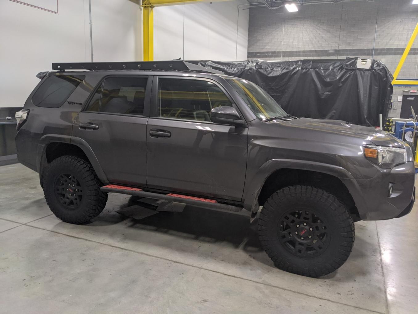

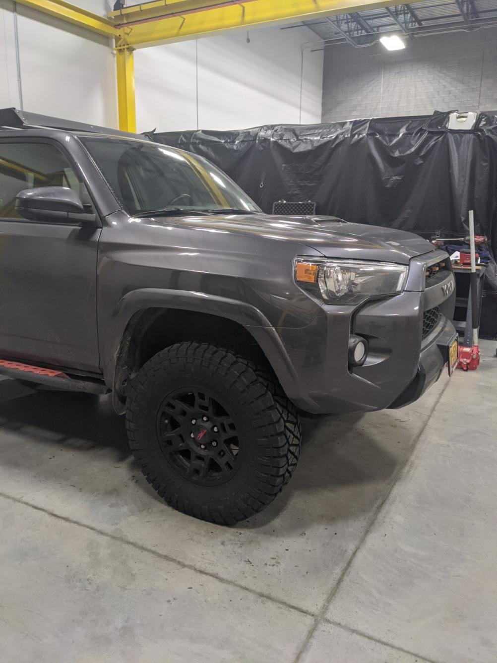

For the record if anyone is wondering. Tires fit no problem without spacers!
A little bit of rubbing at full lock when turning left, usually only on a incline or something. But I haven't even done the fender liner mod yet.

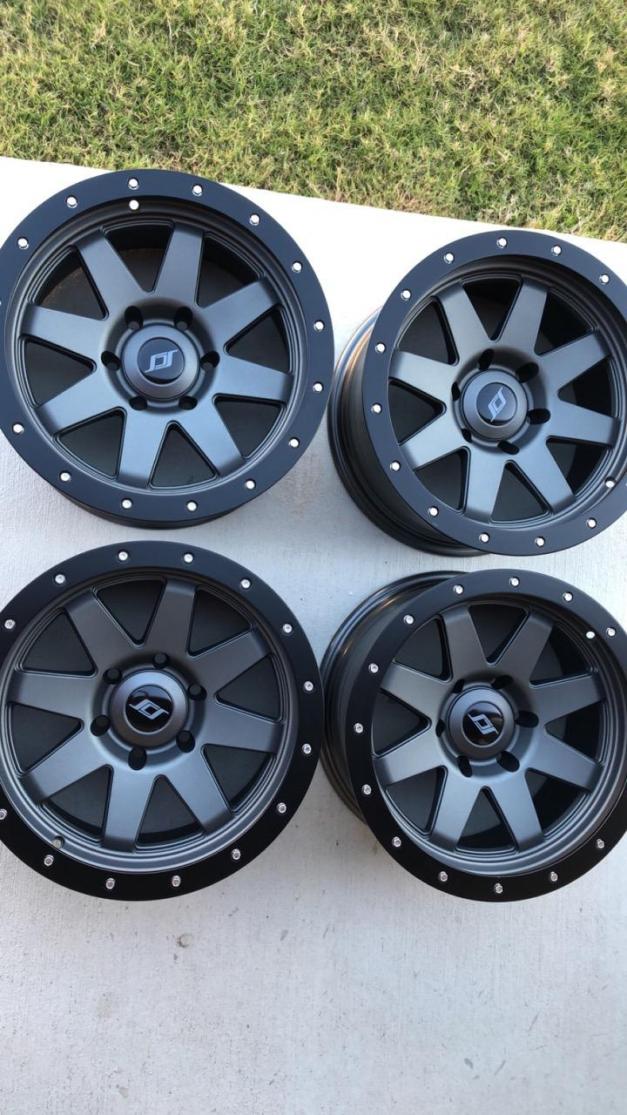

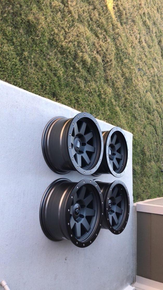

Will be putting Nitto Ridge Grapplers in 285/70/17, wanted 285/75/17 but I pussed out lol hope the combo goes with my barcelona 4runner

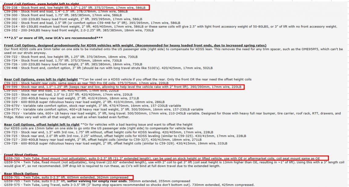

Mild lift below is the suspension I put together with help from Mike at Dobinson's...
After everything settled it is almost 1" lift all around, still maintains slight factory rake and does not require upper or lower control arms. The suspension really tightened up the truck and reduced brake dive and squat when loaded or hooked up to a trailer. I highly recommend...
