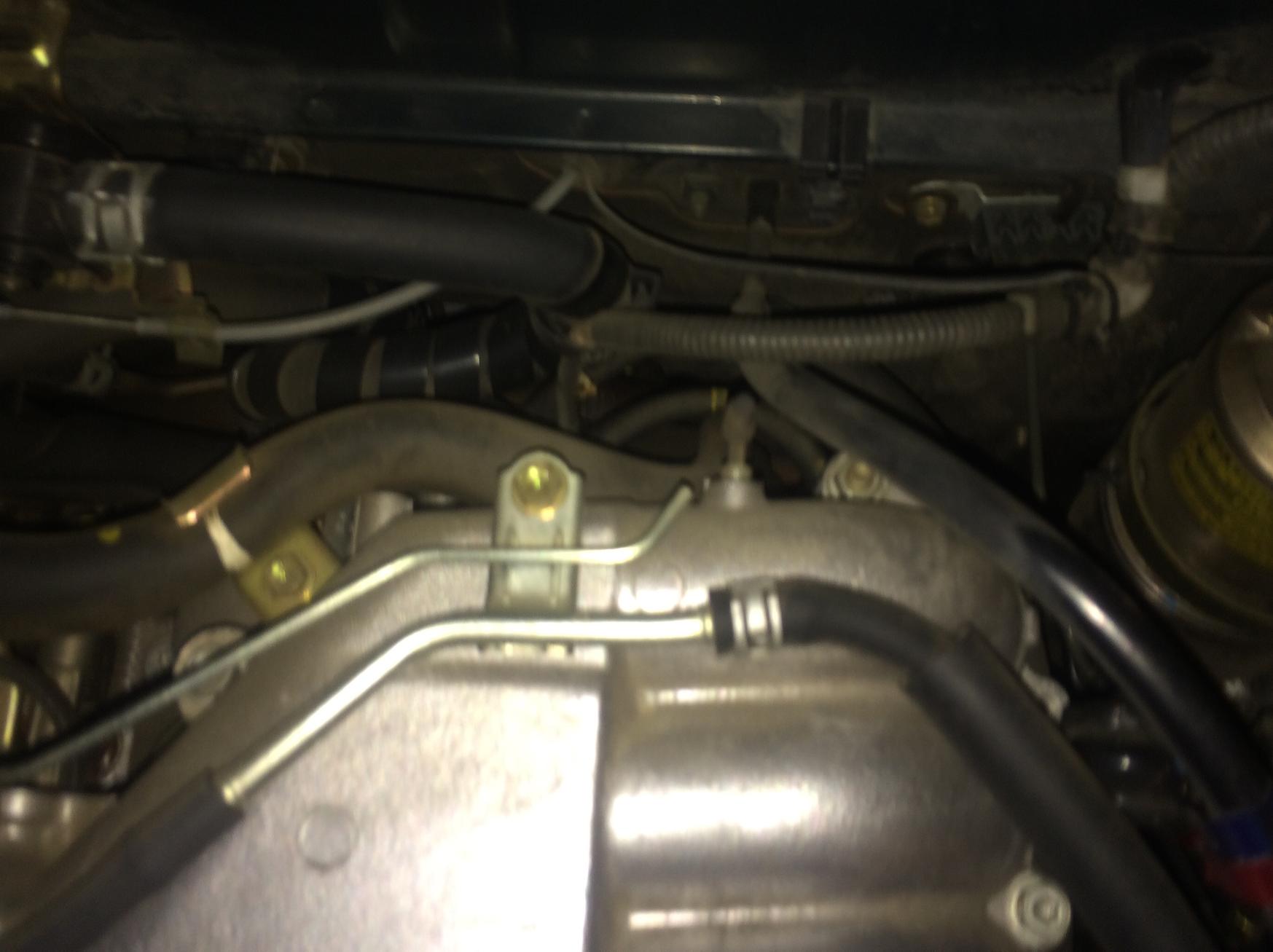

OP. Just went and looked at my 3rd Gen in the garage after seeing the photo you posted. You are missing some things my friend.
That vacuum line goes to the throttle opener. It's plugged on your manifold. If it's disconnected and working correctly it should idle between 900-1900 rpms. If it doesn't it can only be replaced by replacing the throttle body itself. Not sure if it's related to your problem but I suspect not.
My '02 SR5 same locatation.

Maybe it's something that the 1996-2000 models used. Also I inspected the gas cap and the o ring has cracks in it. So I guess I will order a new cap
