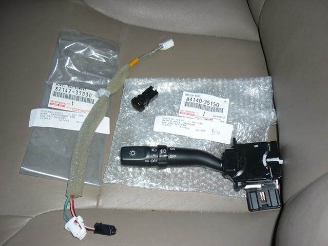

PARTS
Limited Headlight Dimmer OEM: 84140-35150 $109
a. Aftermarket – Standard Motor CBS1240
b. Airtex/Wells - 1S3999
(note: There are lots of similar ones for Limiteds on eBay but they don’t have the automatic headlight switch. Check the aftermarket part numbers. RockAuto had the cheapest ones.)​
Light Sensor OEM: 89121-12010 $133 (got mine for $99 used on ebay)
Wire Harness
If you have standard climate control you need: OEM 82142-35020 $10
If you have dual climate control you need: OEM 82142-35030 $10 (thanks ThreeFiveO)

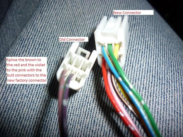

Note: As you’ll see in the install, I got the wrong three-wire dual climate control harness which required some minor modification for my ’04. No splicing required if you buy the correct wiring harness for you vehicle.​
red butt connectors (X2) (but only if you get the wrong part :) )​

  • Assemble the parts.

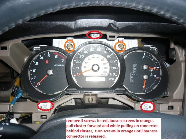

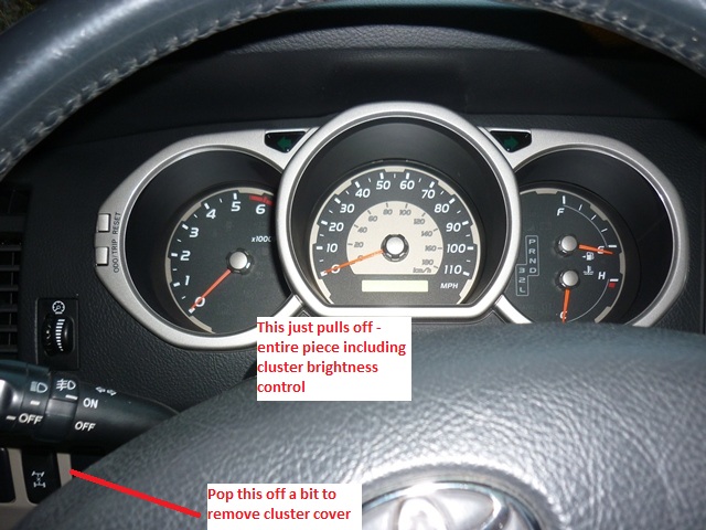

  • Remove the plastic covering the instrument cluster. It just pulls off. Helps a bit if you pull out the top of the lower cover but you don’t have to unscrew the bottom screws.

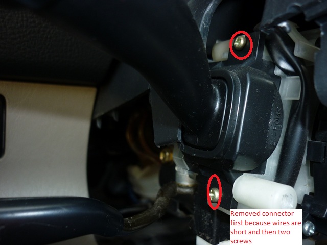

  • Remove the speedo cluster. 3 screws plus the 2 screws that hold the wiring connectors to the back of the cluster.

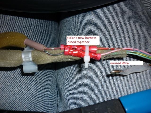

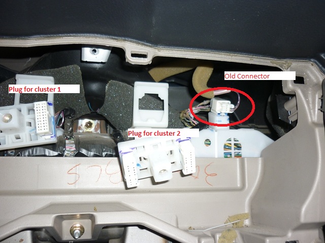

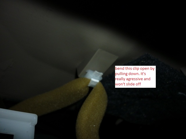

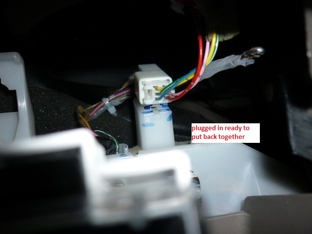

  • Remove the original wiring harness. I had to bend the metal clip in the harness a bit to get it to slide off the mount.
  • Modify the harness removing the three pin solar sensor connector and splicing in your two pin connector. (I tried removing the individual pins for a while but I just couldn’t hit the release.)
  • Remove the blank, install the light sensor (it's tight but my big hands managed it without a problem) and connect up the new harness.

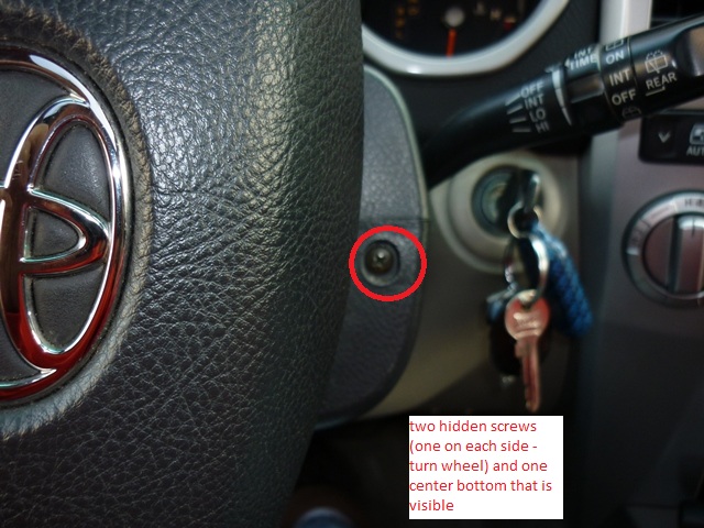

  • Take off the plastic surrounding the steering wheel column. There are three screws. One on the bottom and two others behind the steering wheel that you can only see if you rotate the steering wheel 90 degrees each way.

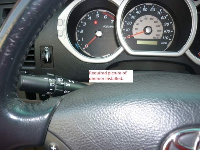

  • Unscrew the Headlight dimmer (headlight stalk) and swap in the new one.
  • Reassemble and you now have automatic headlights.

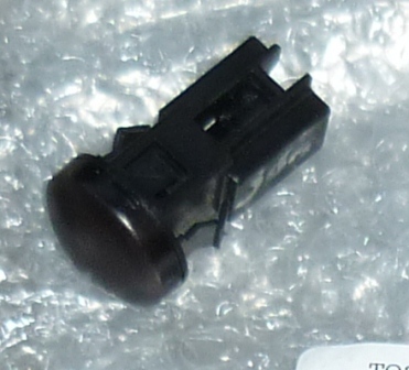

Do you have a picture of the sensor or the blank? My 08 looks like the sensor is already there..
There's a picture of the sensor in the parts picture. It's on the bubble wrap. Here's a zoom of it.
What you most likely have is the AC light Sensor (88790-35070). All of the 4Runners have them. Next to it is a blank. That's where the sensor goes. You pop out the blank and insert the sensor.

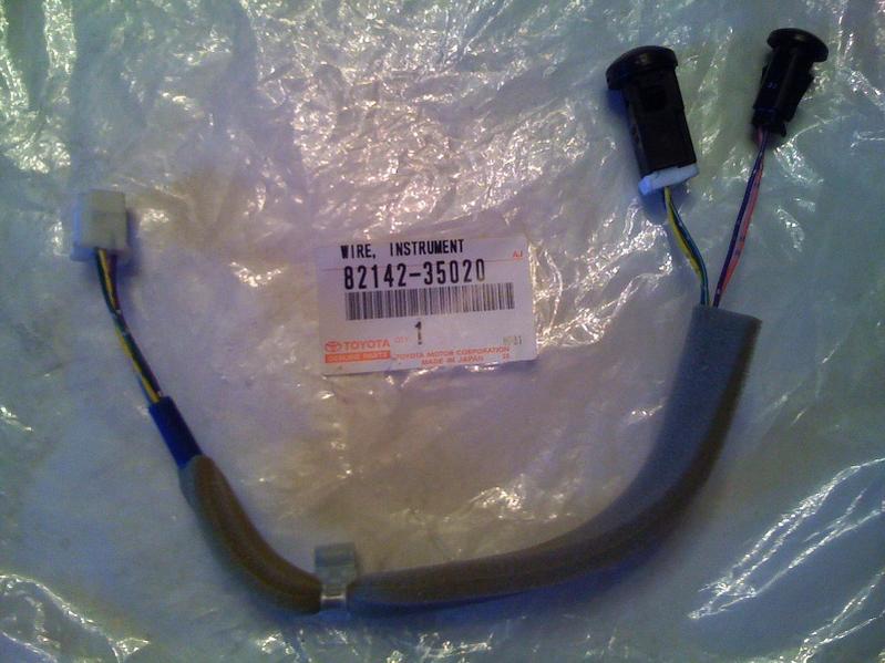

Great Writeup! I did this mod a while back. I sourced my light sensor from a 2002 Lexus IS300.
I thought about adapting the IS harness by simply re-pinning the existing 6 wire 4runner connector but there actually is a 4Runner Instrument Panel #2 harness that doesn't require any splicing and is full plug and play. The part number is 82142-35020. This is a 5 wire harness that uses the standard 2 wire connector for the single HVAC sensor and the 3 wire connection to the auto headlight sensor. The harness is cheap at less than $10 and makes the install completely Plug and Play - OEM. :cheers:
Attached is a picture of this harness with both sensors plugged in.
