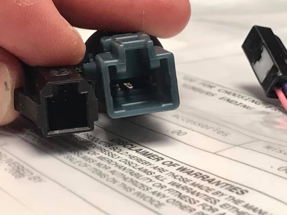

I went to the parts yard and pulled two different sensors from the various Toyota cars in the lot. In the picture attached you can see they are different in sizes and the small one does not work for our trucks.
The larger one does fit. For those trying to identify which one they need at the parts yard: you can pull the sensor out of the truck and it will have the part number on it so you can verify it is the correct one.
The correct light sensor is 89121-12010 which the original author of this thread listed. The entire thing took about two hours and I had no issues with the install.
