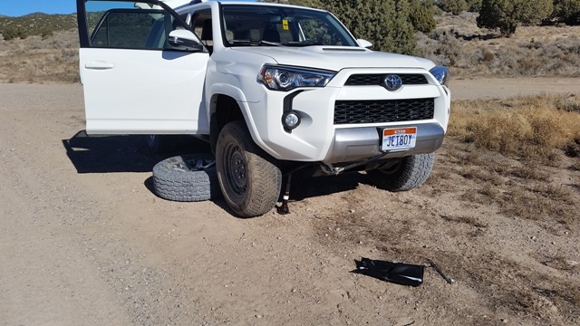

Also - fun tip for safety first folks - put the spare tire under the frame rail while you take off the tire, then swap and put the flat tire under the frame rail until you're ready to drop the vehicle back off the jack. Might save your fingers if your don't get your jack positioned well and the vehicle slips off.
