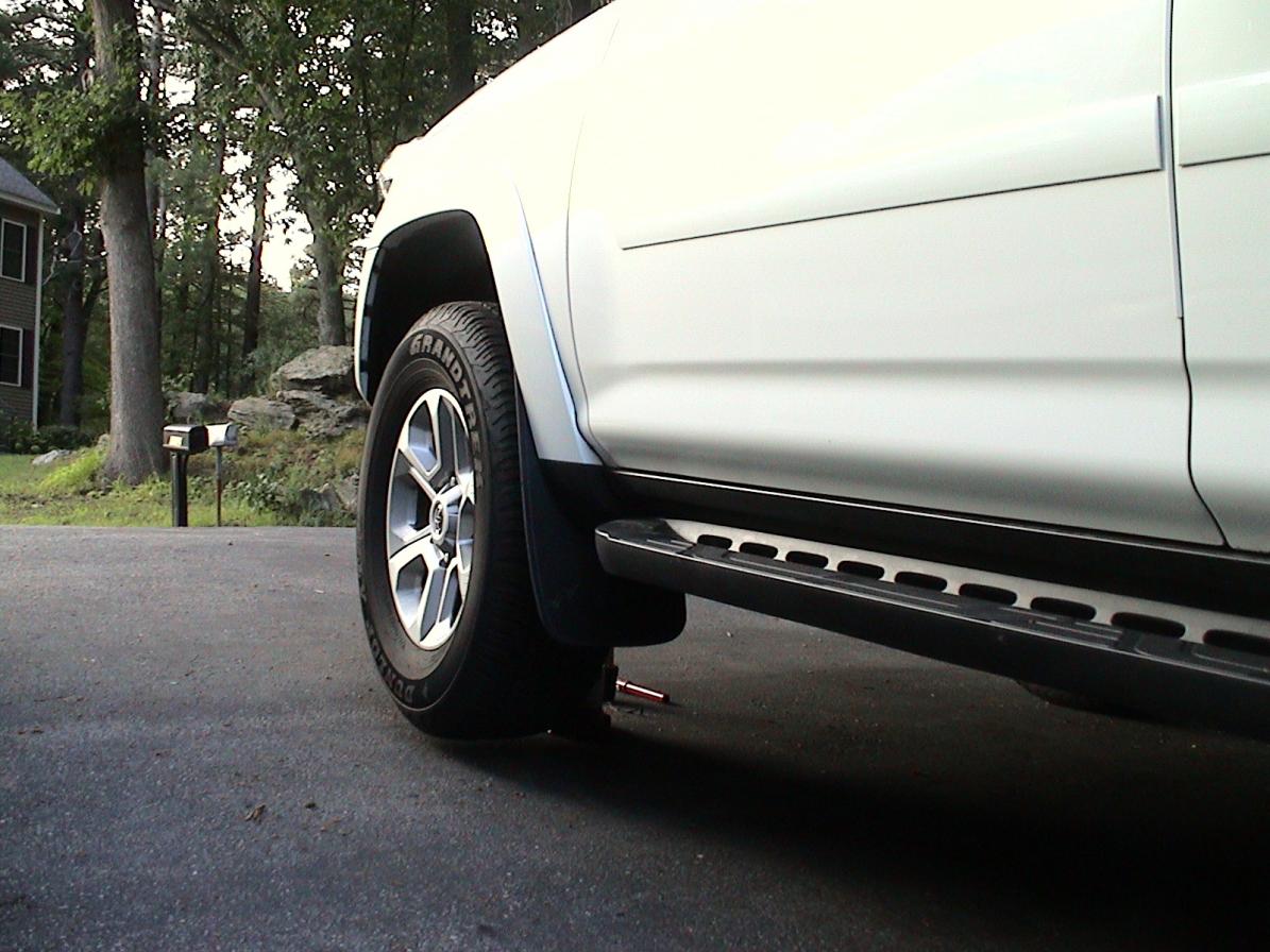

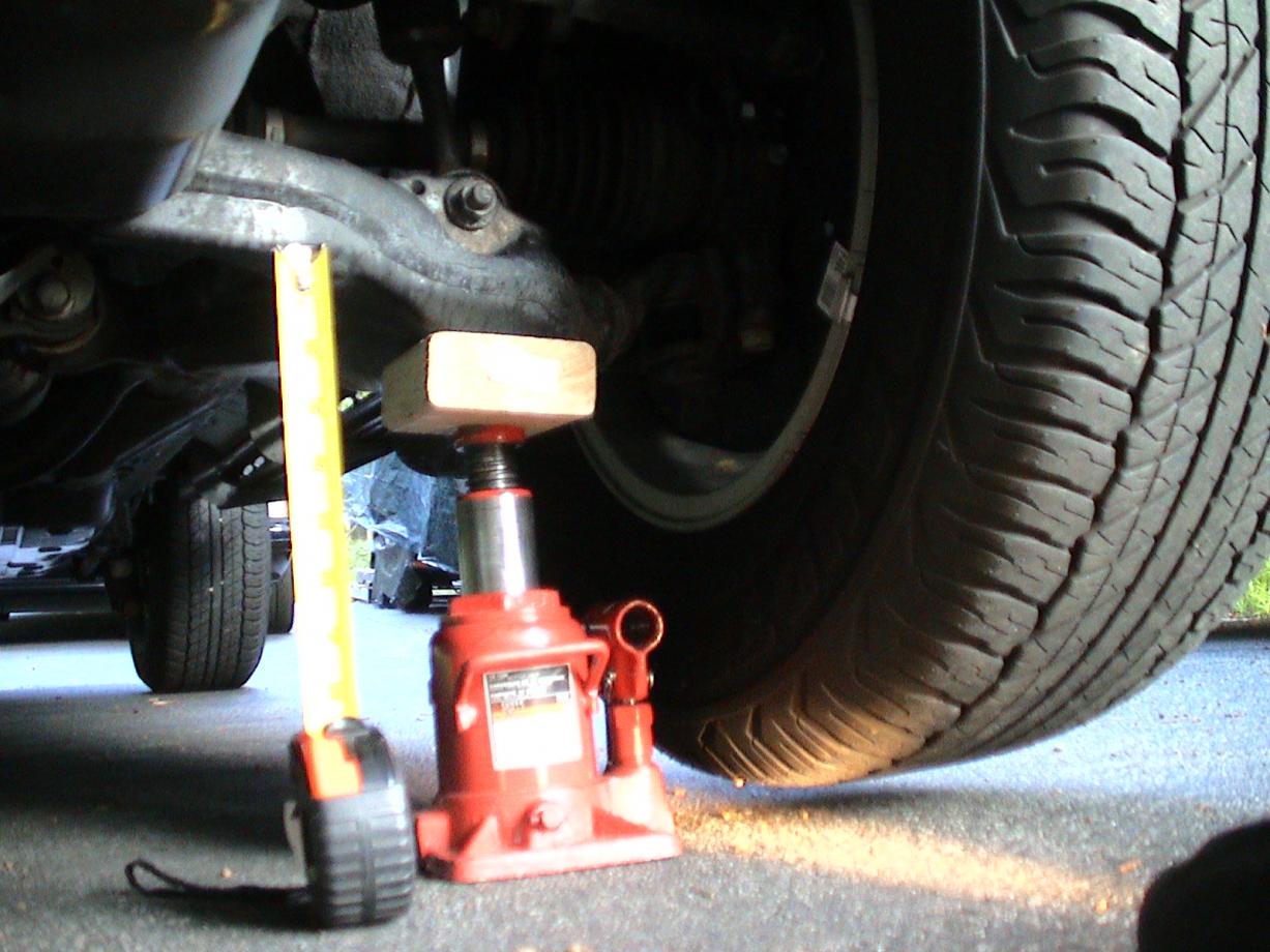

Ya same deal I had using the Toyota jack front tire removal.. this is what I use to remove the front wheels
very safe lifts vehicle up about 2 inches.. using the Toyota jack body lifts up way too high very unstable.. small base plate IMO Dangerous on front wheel removal
I have done that before and it's super unstable. Now I carry two pieces of 4x6's to put the jack on.
you should drill out the wood a bit so it seats over the bottle jack top
no need to drill any holes .. jack goes up 2 inches that is it ..you do this as I did and you will know how safe and the vehicle looks level no roll / wobble etc... very solid like tire on ground..
you do the toyota jack set up on front end ya you need 2X12 so that POS jack is not gonna crash down on you ... need a couple of jack stands or wooden solid blocks to keep it from falling on the ground.

my jack is a 12 ton jack short , so it fits under the front lower control arm ..........................Toyota jack , no fit a bit tooooo tall..
HYDRO JACK much faster, little jacking only 2 inches ..safe..
I can also use this jack for other uses ..I can use this to jack up my house .
