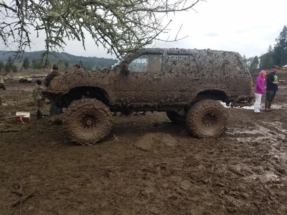

91 runner with 85 SAS 5inch lift up front on leaf springs rears still coils waiting to swap it to 4 link. Has a 3.4l v6 swap with cold air intake and headers hi-flow cat and flow master muffler. 5 speed with 4.88's welded front open back. And putting the power to the ground is some 38x12.5x15 super swampers TSL SX's. Badlands 12k Winch up front on homemade tube bumper 2 6led auxbeam ditch light pods and 42inch curved auxbeam light bar on room(not pictured ) TG rear bumper with 2 6led auxbeam pods on back.

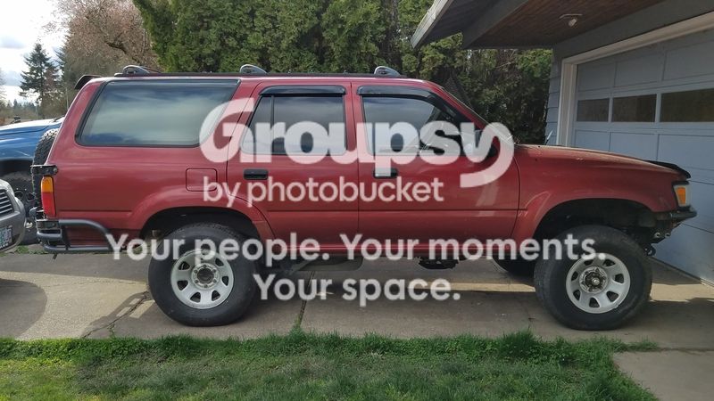

94 4Runner, stock supsension and 35's

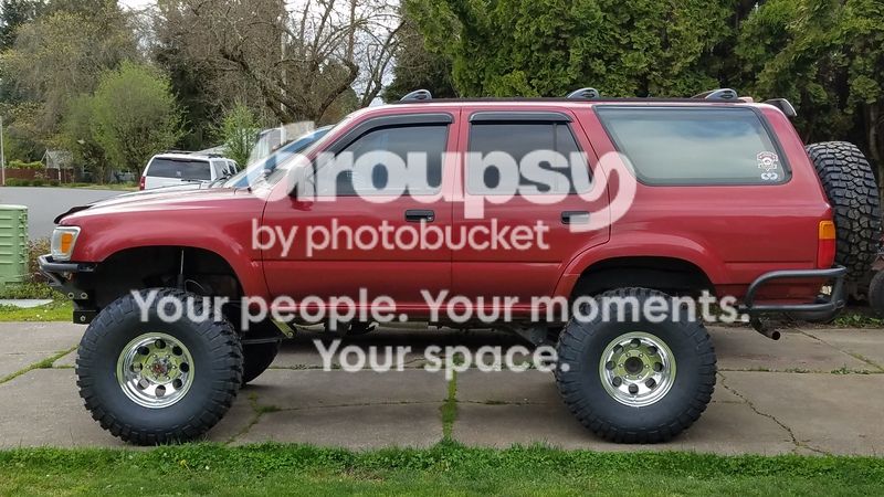

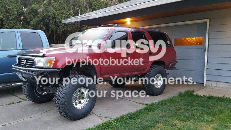

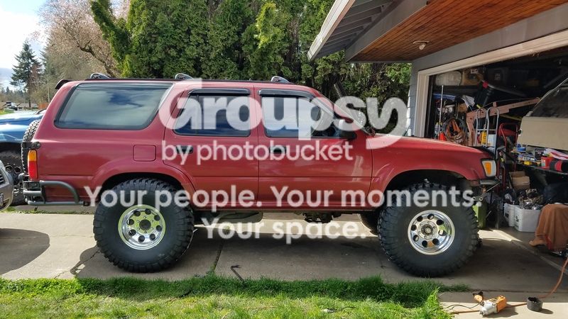

SAS with Trail-gear 4" springs up front, 97 FZJ80 springs in the back
SAS with Trail-gear 4" springs up front, 97 FZJ80 springs in the back + 1.25" rear coil spacer

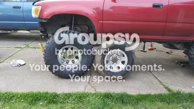

35 next to 235

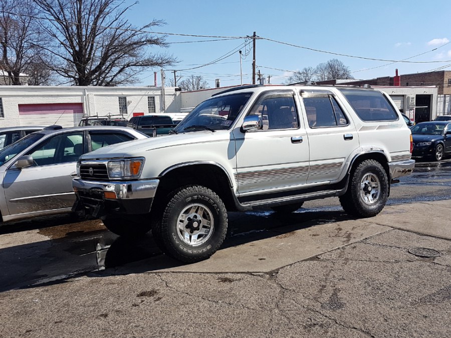

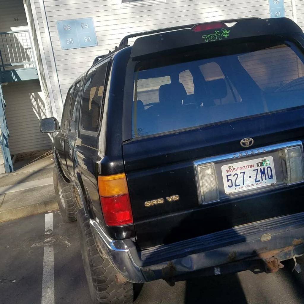

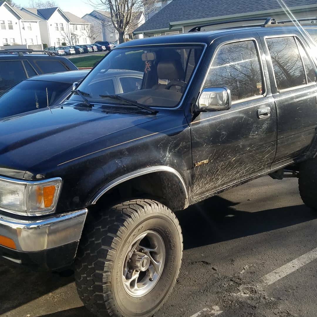

95 4runner limited, 32 inch tires and not sure if it is stock or lifted. I don't see any signs of a ball joint spacer kit on the truck.

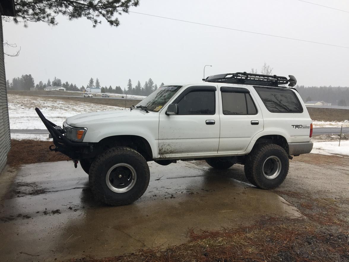

1.5 bj spacers in front with ome 900 coils in back. 33x12.50 15 on 15x10 with -32 offset
Sent from my SM-G930T using Tapatalk

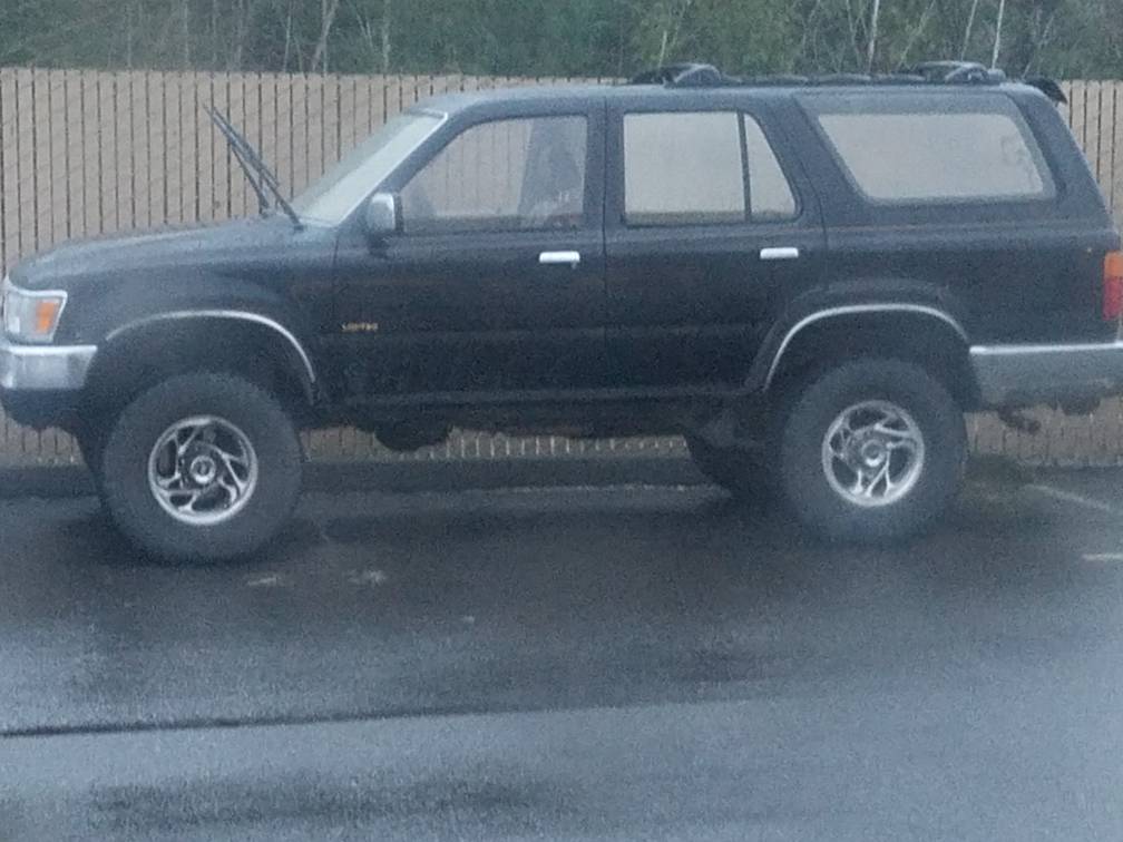

Mine 95 is stock with Rancho RS9000 shocks and looks about the same height as yours. I'd say that your runner is probably not lifted.
That's the conclusion that im coming to. I was wanting to go up to a 33 but I might just go to a 31 since 32s are not a common size any more
