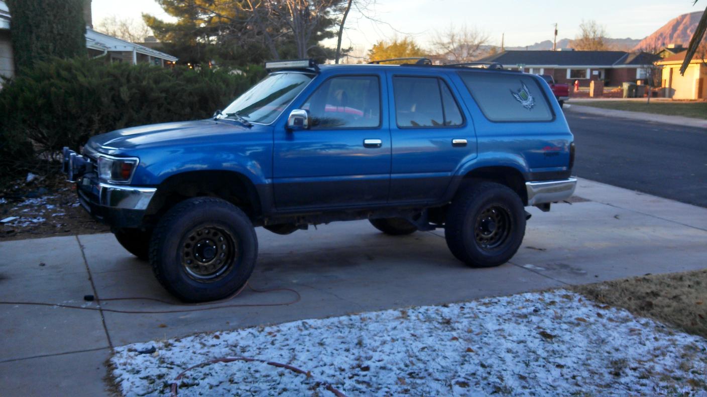

33" Grabbers
Had 33 10.50 15s put on my 94 runner. It has 4.88s in it and 30s on it when I bought it. Nightmare on the freeway. Now its pretty close to factory gearing. Everything clears with no rubbing. I'm going to run it as is for a bit and see if I can get away without a lift.

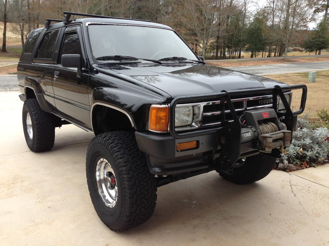

35x12.5R15 Goodyear wrangler mtr w/Kevlar. Have been very happy with the performance if these.
4" procomp front and rear. 5.29 gears front and rear, Detroit locker in the rear.

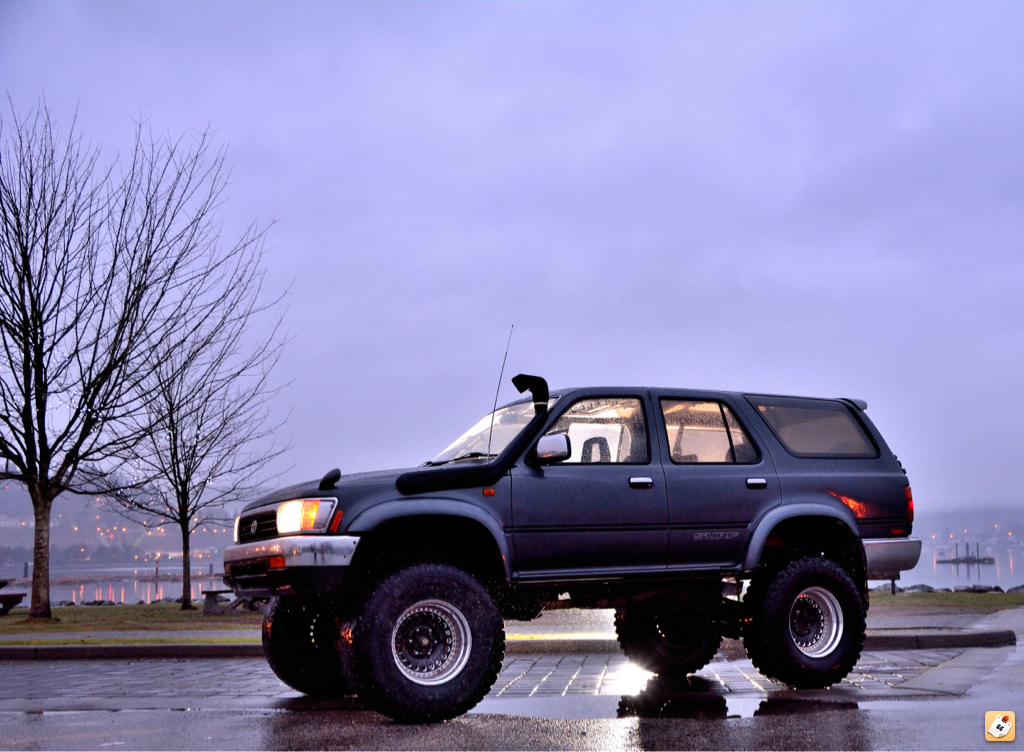

You have almost the same setup as me besides ifs and I have BFGs.
WOW! Gorgeous rig, EricHartley!

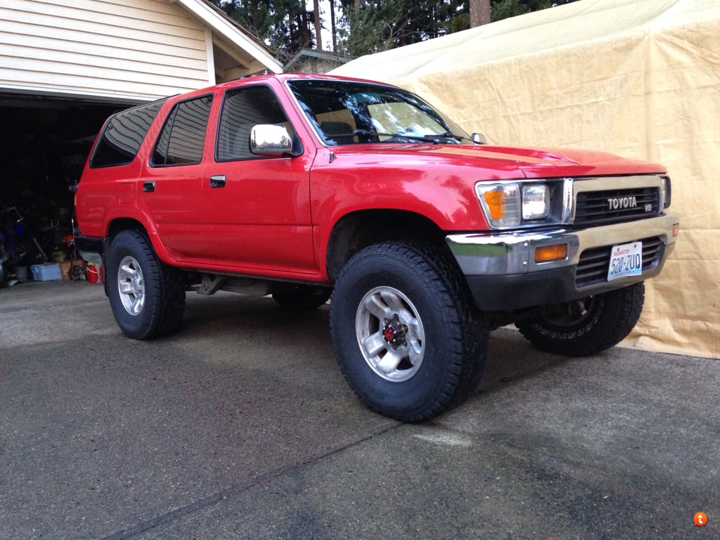

Here is mine... 100% stock with 33x10.50x15 BF Goodrich Mud Terrain KM2's... NO RUBBING, even at full lock!

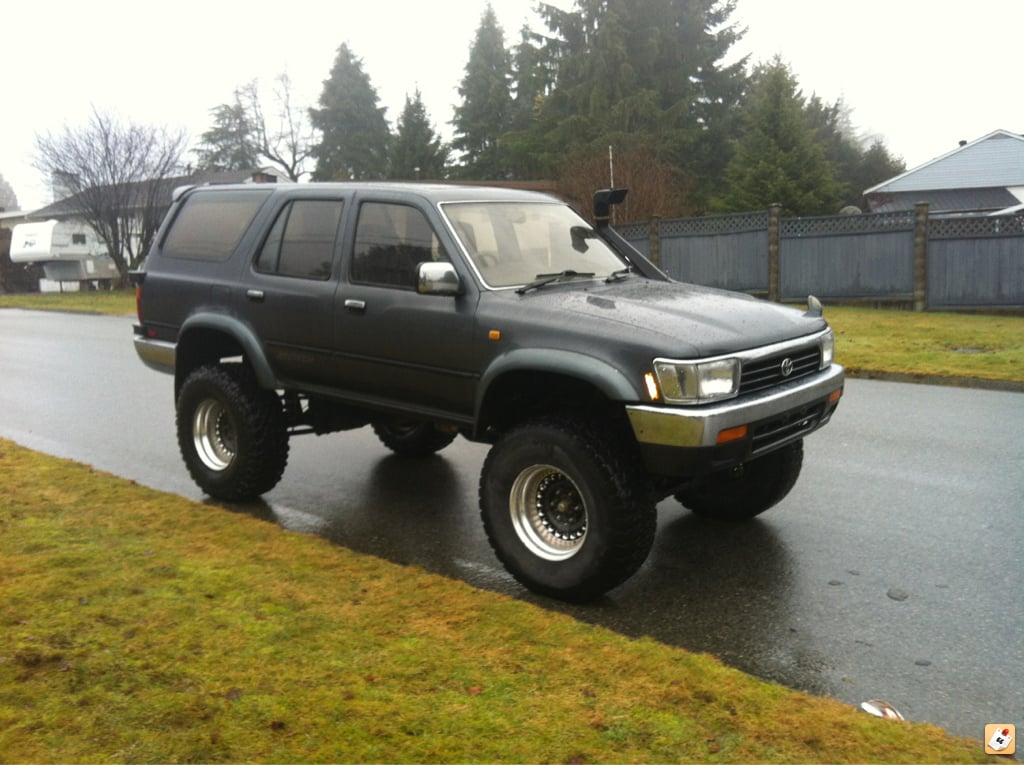

thank you! its very hard to find a 4runner up here in bc with no rust, so I bought an imported hilux surf instead!
your rig looks very clean and rust free! and Ive had a few 4runners like yours, 33s with no lift and no rubbing!
