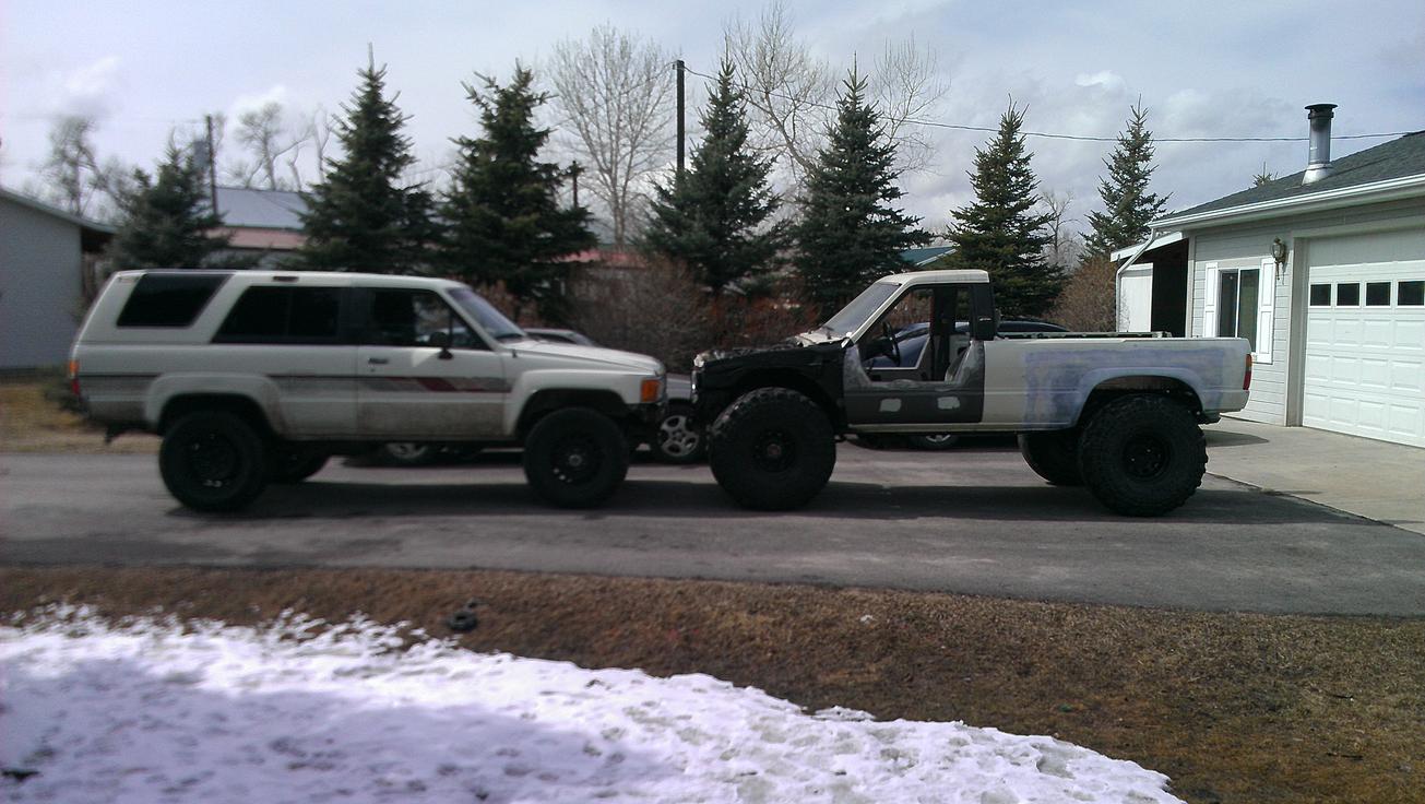

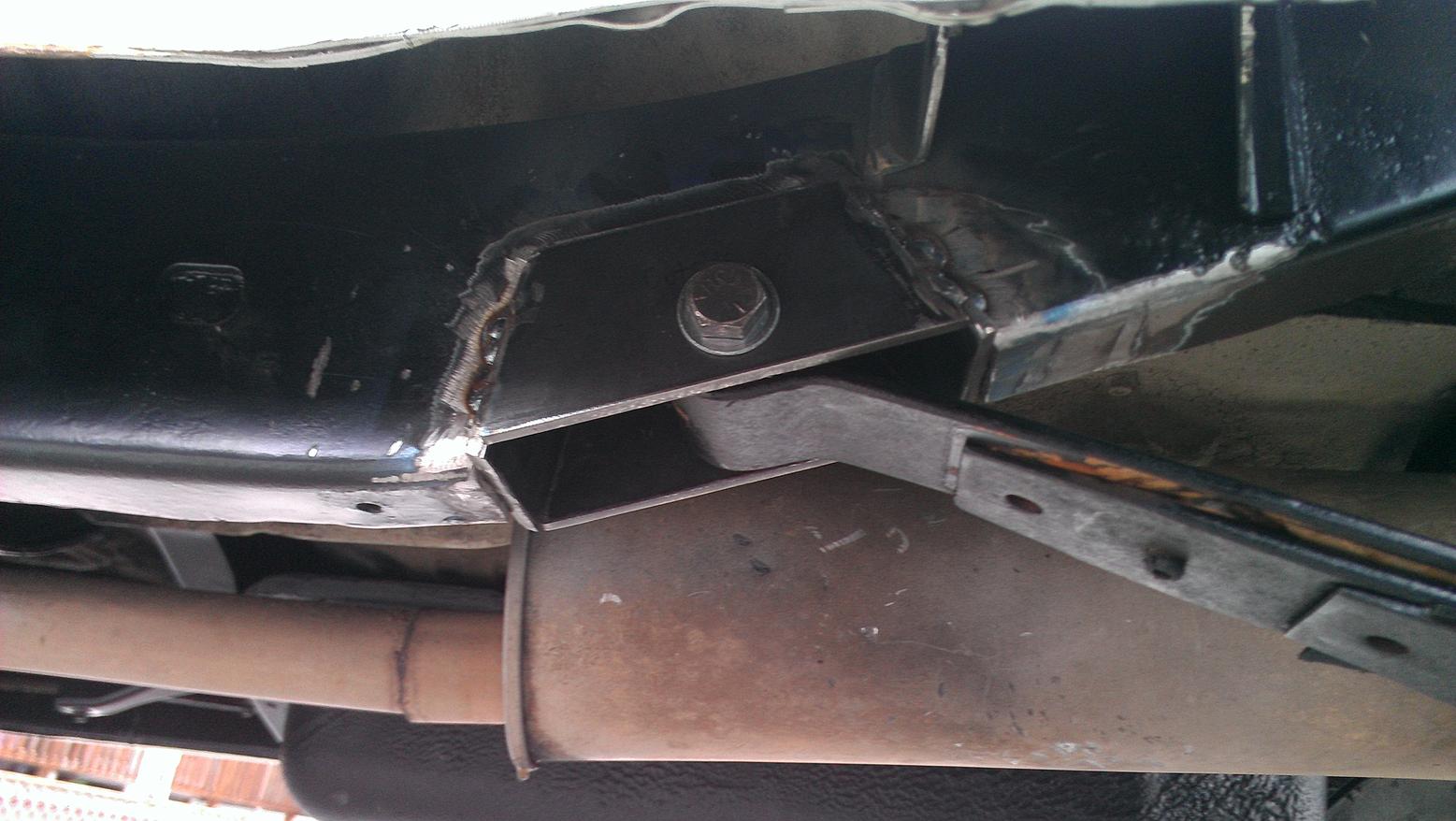

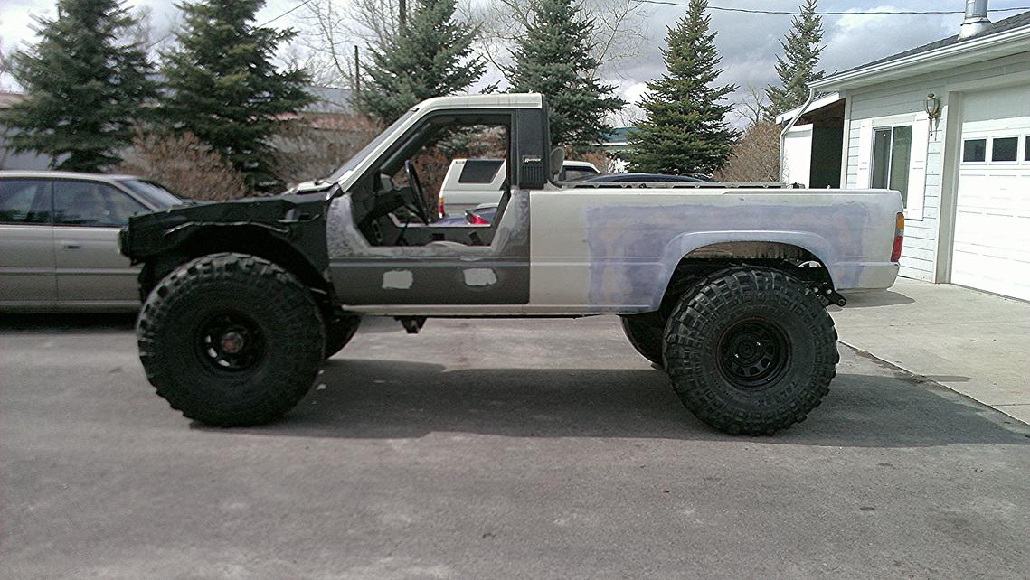

Frenched rear spring hangars, reversed f-150 springs. Skys drop shackles. Sitting on bald moch up 38.5 swampers for now. Front suspension is stock getting ready for 3 link. Extensive tubbing to firewall and rear fenderwells to keep it low as possible.

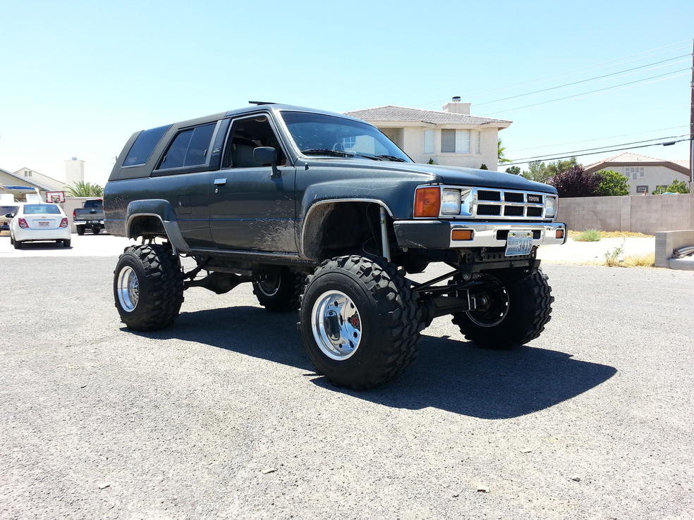

Alohas T4R peeps......I did a 4"trail gear. .shoes are 33x13.50 swamps on 15x14 weld wheels. HAWAIIAN STYLE. Stock gears for now. I got 4:88's on the way...ill post the build pics later. Enjoy.....Alohas

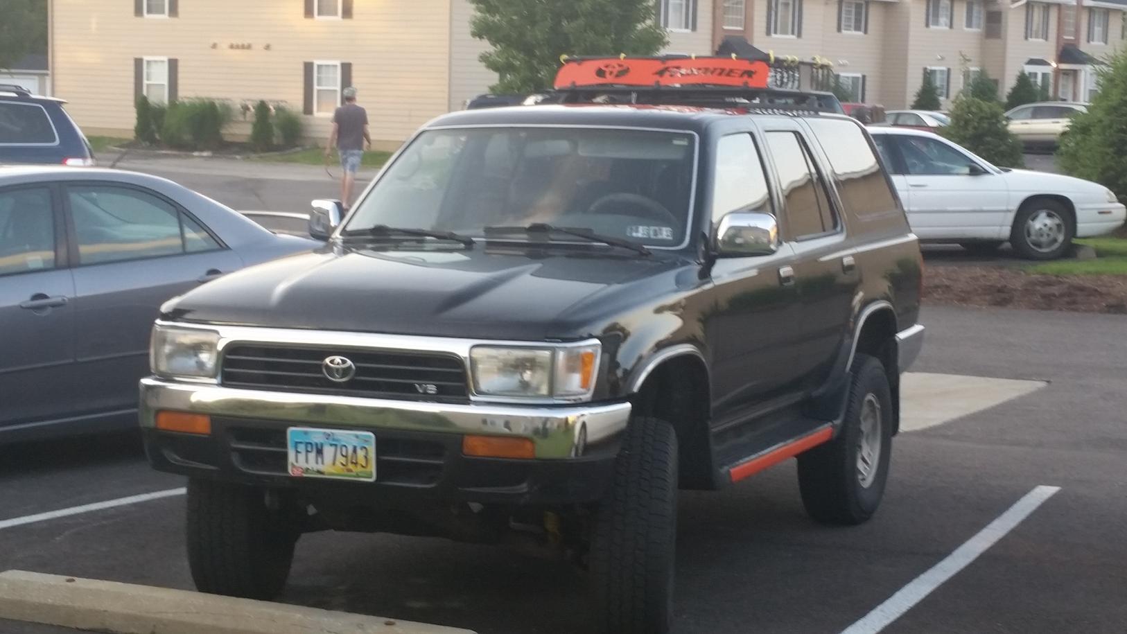

planning to put ome 2in lift with new torsion bars, darak springs, and ome shocks. I was wondering if i could put 35s in it. If not, I think i would stick with 33s. If anyone could help me decide that would be awesome. thanks!

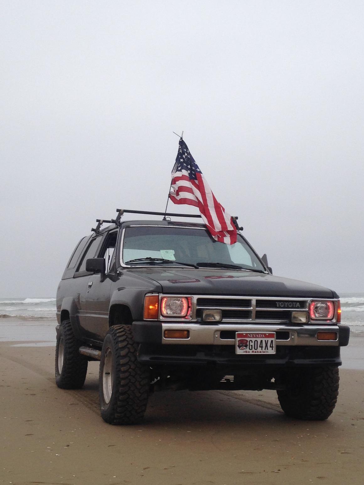

What kind of headlights are those?
