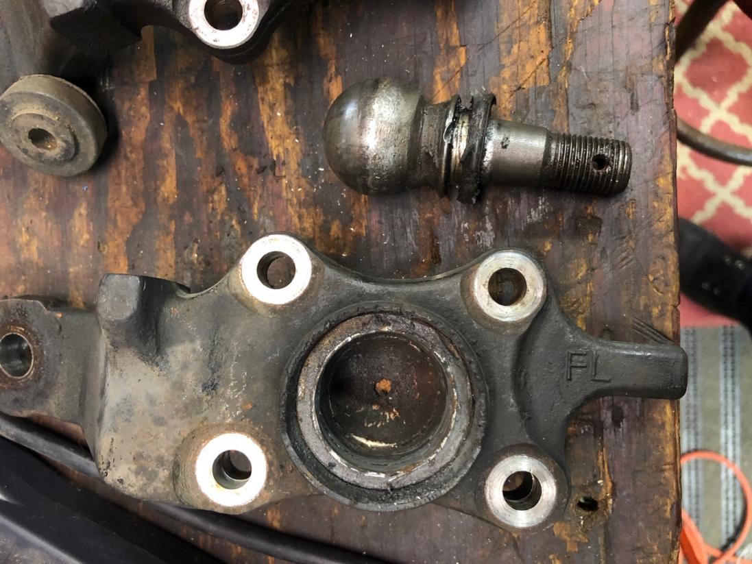

I wanted to add my experience here....
... 1998 SR5 with 192,000
.... 2.5 weeks after buying it, the Lower Ball Joint Failed.
Symptoms were only noticeable for maybe 15 miles before it gave out....
361046d1589399878-official-lower-ball-joint-write-up-thread-ball-joint-5-jpg
Thanks for sharing. Looks like socket lip gave way and ball pulled out?
