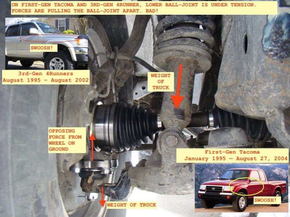

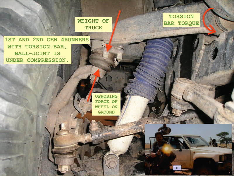

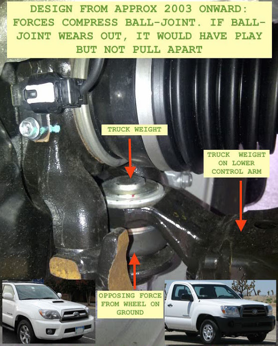

BASICS: COMPARING BALL-JOINT SETUPS BETWEEN GENERATIONS
I hope this simple explanation clarifies why the 3rd gen 4Runners and 1st-gen Tacoma LBJ's are problematic, while the others are not.

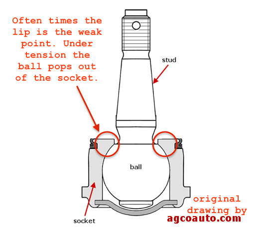

Where BJ's are under tension, they could fail and PULL apart (usually the lip of the socket is the weakest point).
Where BJ's are under compression, if they have wear, they would have play but stay in one piece.
The stud under tension could also fail - more likely than a stud under compression.

It's an attempt to make the problem seem lighter. The root cause of this problem is the design that puts the LBJ under tension as shown below.
Scratches may cause looseness and play but if LBJ were under compression like other designs, it will not PULL APART.
Therefore, the recall should not only apply to certain years but to all vehicles where the LBJ is under tension as shown above.
