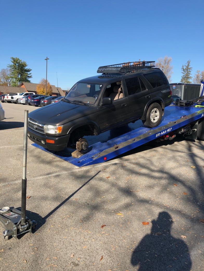

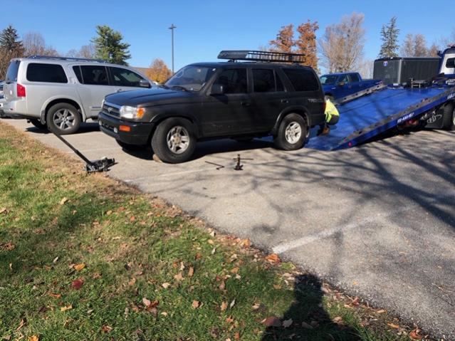

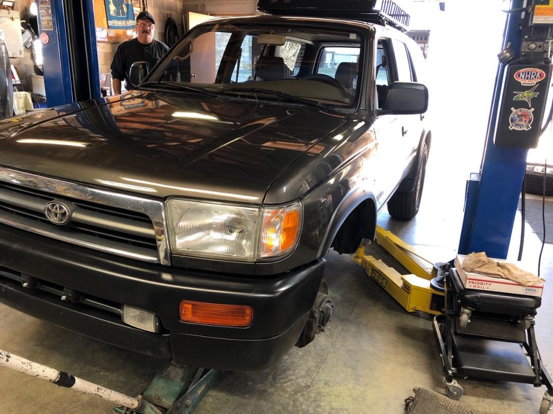

I hadn't even had time to get it on the lift for its first oil change / inspection .... 2.5 weeks after buying it, the Lower Ball Joint Failed.
Symptoms were only noticeable for maybe 15 miles before it gave out. I remember feeling the truck pull hard to one side and I jerked on the steering wheel to correct it. It was nothing dramatic. But it did this 3 or 4 times along a 15ish mile drive.
I parked the truck for a second and then put it into reverse to back out of the parking spot. That's when I felt it give out.
All this to say ... DON'T WAIT on inspecting your LBJ
I replaced both sides with OEM and replaced the bolts too.
I called my local Toyota and they had the parts in next day and even gave me a discount code.
Also, the tow guy attempted to pull it onto his truck with the wheel still on ... I stopped him. It was going to tear something up for sure.
Make sure they remove the wheel and use a sled under the ball joint / caliper

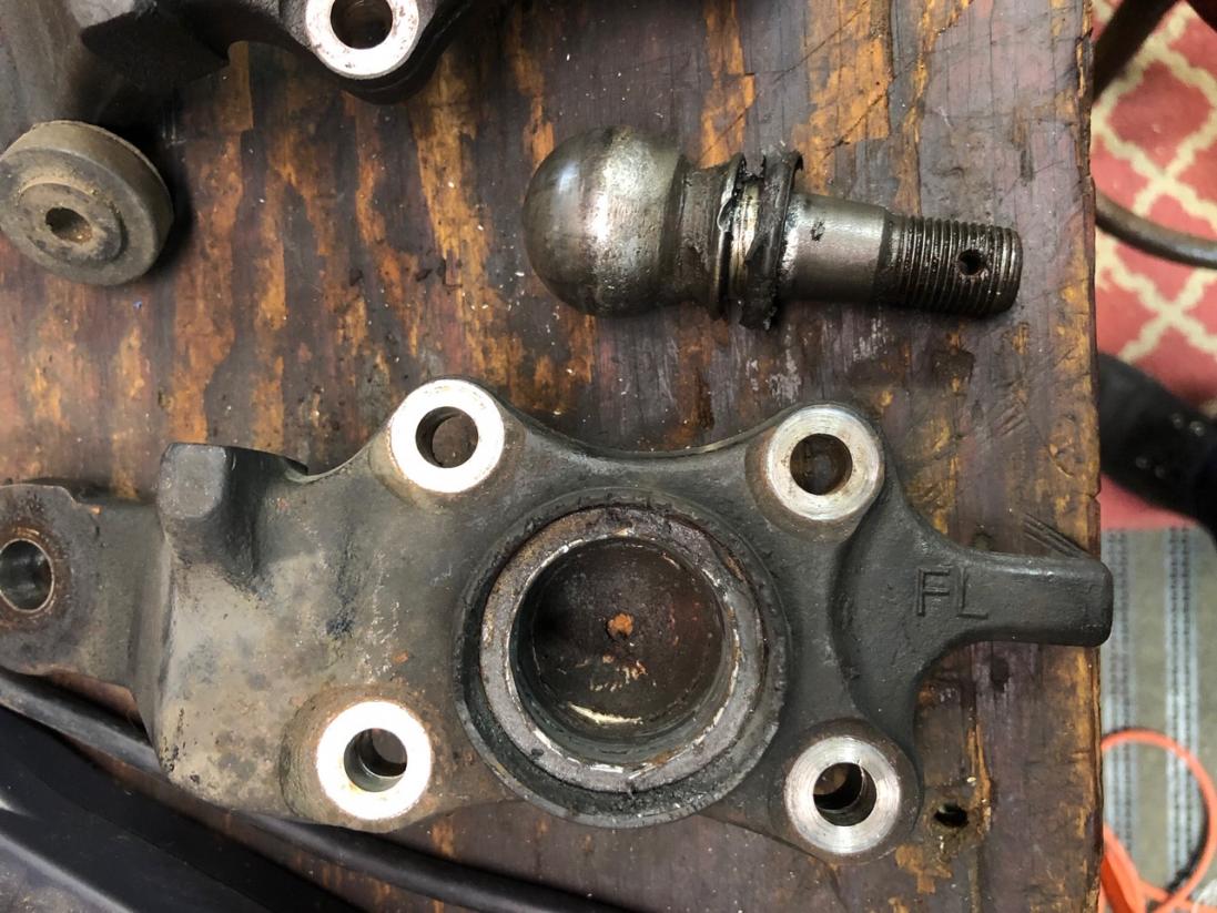

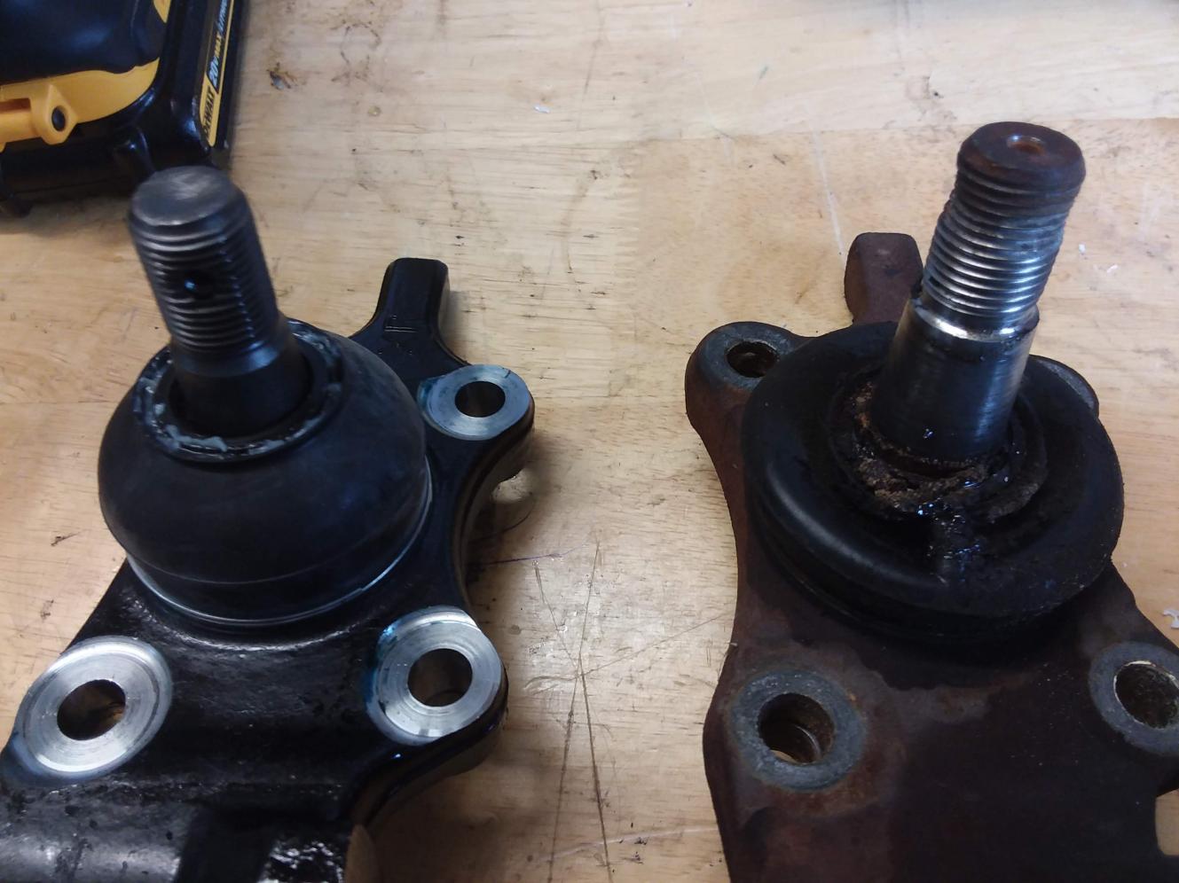

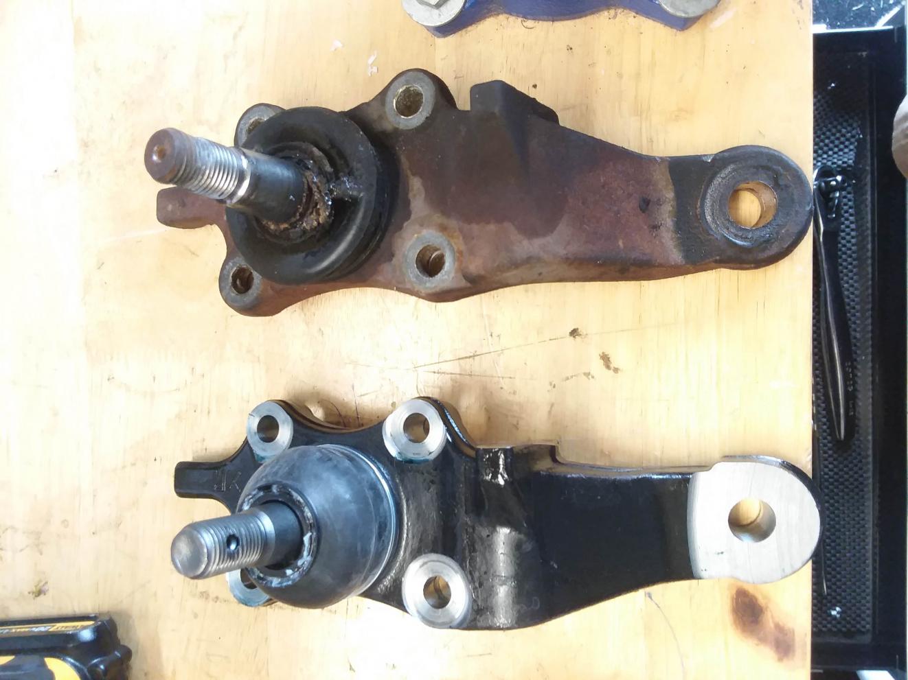

Man that is beyond lucky. Most people are moving and have body and additional suspension damage when theirs let go. I replaced mine at 341k with 555 branded ones. I replaced them again at 380k with New OEM because the NON-OEM 555 branded joints were shot.
What was the failure symptoms on what was going wrong with the 555 joints? Was there any play? Have they been regularly greased?
They were non-greasble type. I took the truck on the sand, but never in the water on purpose about 25 times from 2012 to 2014. Was a street queen until now. I took it in to Firestone for a Lifetime Alignment check, and they said the Inner Tie Rod was bad. I took a look at the ball joints, and realized the one you see here was leaking grease badly. So I ordered OEM LBJ"s for both sides and put them on when I swapped on new ITR/OTR at the same time.
Next I need Upper Ball Joints. That's another project thread entirely though.
That's weird, there's absolutely no grease nipple on them? I had taken a look at some Moog units which were physically branded 555 and they had grease nipples on them. I would almost think that if you are submerging the vehicle often, then greaseable joints would be better because you could flush out the water.

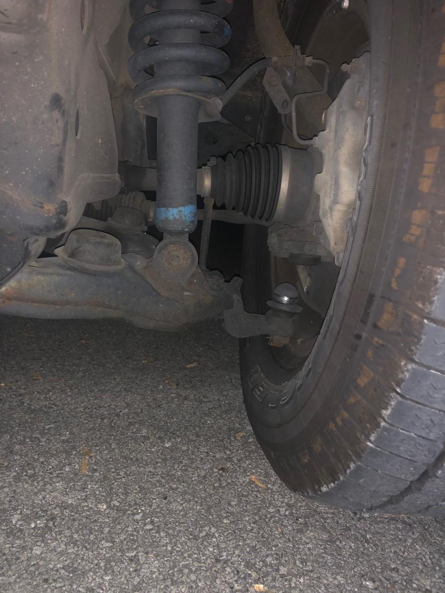

Got an alignment done today and they noted a bit of play in my LBJs. These are Toyota OEM bought from a dealership that I put on 25k miles ago when I got the truck.
I had the alignment shop show me and there was a little bit of play with the pry bar. It did not seem significant, but it also wasn’t nothing.
I’m a little surprised that there is already some play in them, although I have wheeled the truck 6-7 times and I drive around horrible Brooklyn streets with a steel bumper and winch. Looks like I should be looking to replace them again soon just for peace of mind.
