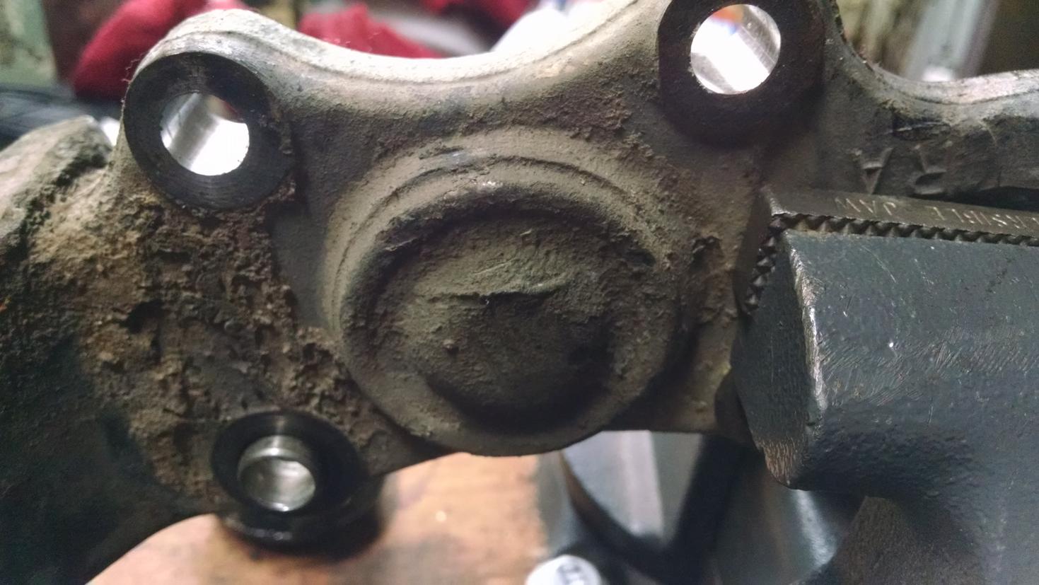

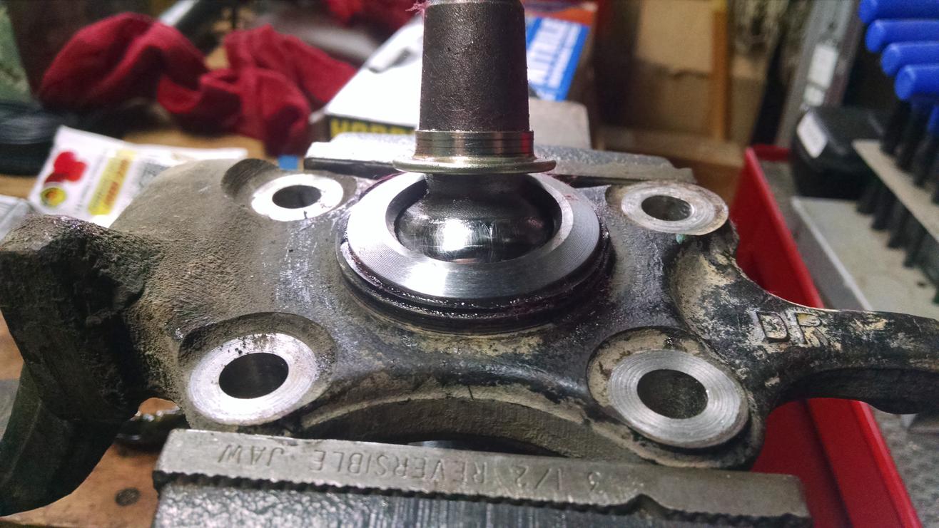

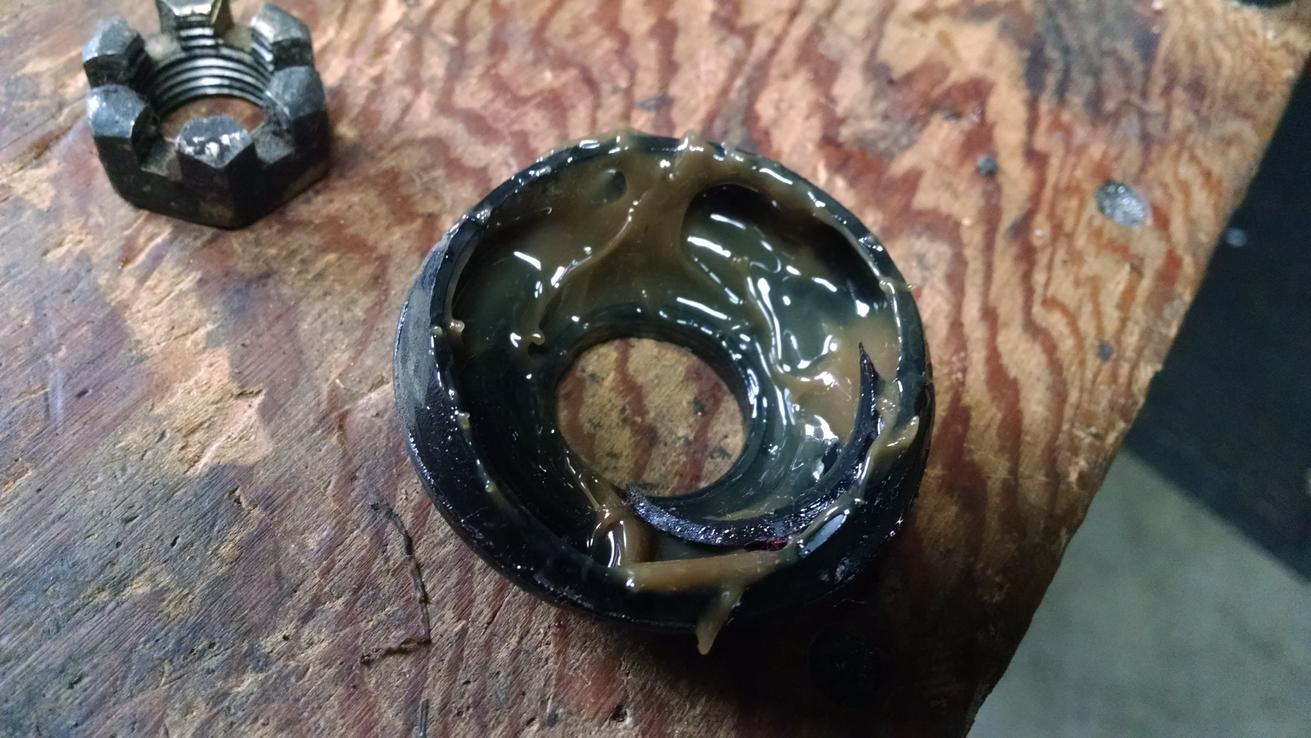

I still had the ball joints and I cut the boot off of one of them and took some pics. I don't think you need to have a zerk fitting for these. At 140,000 miles, my boots were still intact, and because of that, there was plenty of grease in there. I took a picture of the cut off boot with grease in it and I wiped off a larger amount of grease from the balljoint itself so I could take pictures of it. Unless your boot springs a leak, you're probably good on grease. And, if you do spring a leak, that's a chance contaminants can get in there and prematurely wear it out, so you should just replace the balljoint when that happens anyway.
I would be concerned that drilling into the balljoint will leave metal fragments and then cause damage. Also, if you're not extremely careful, you'll drill right into the ball itself. My two cents.
