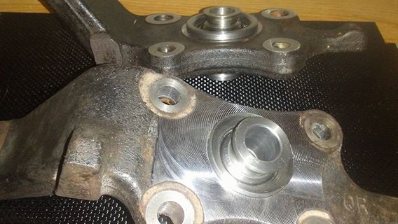

I just had my UBJs and LBJs replaced at the same time as replacing my ITR and OTRE. Pretty certain they were original with 182k miles. On the driver side LBJ, one of the four bolts connecting it to the spindle broke off inside the spindle. The shop tried to remove the broken bolt by torching, etc. but was unable to get it out. Now, I am left with only 3 bolts holding the LBJ to the spindle. I have seen some opinions about the safety of having all 4 bolts, and I would obviously like to get this fixed. Any suggestions for removing the broken bolt? Do I need to replace the whole spindle?

On the driver side LBJ, one of the four bolts connecting it to the spindle broke off inside the spindle. The shop tried to remove the broken bolt by torching, etc. but was unable to get it out. Now, I am left with only 3 bolts holding the LBJ to the spindle.:
This sounds super lazy of a shop as this is not a new problem for any mechanic that deals with rusty stuff.
If I were dealing with it at home I would start with loading it up with a ton of PB blaster, let it soak/dry for a few hours, then pb blaster again, then try a reverse drill bit or if it fits, an extractor.
If neither of those worked I would drill out the bolt using a bit just smaller than the spindle threads and then use a tap to clean the remaining metal out of the threads. Definitely a time consuming job.

This happened to me earlier in the year. I drove on 3 bolts for a few months as I couldn't get the dang thing out. I finally got it out, but destroyed the threads in the process. Tried to tap them but memories of breaking the bolt extractor off inside the broken bolt came back. All I would need is a snapped tap after I just got the bolt out. I said screw it and bought the entire spindle from another user on here. Problem solved. If you have better luck than I, it's not terrible to get out but I would highly suggest taking the spindle off to remove the bolt, you'll have better access. That was my mistake. I still have the original spindle and I might have a shop tap the threads for me.
