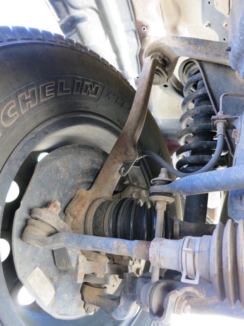

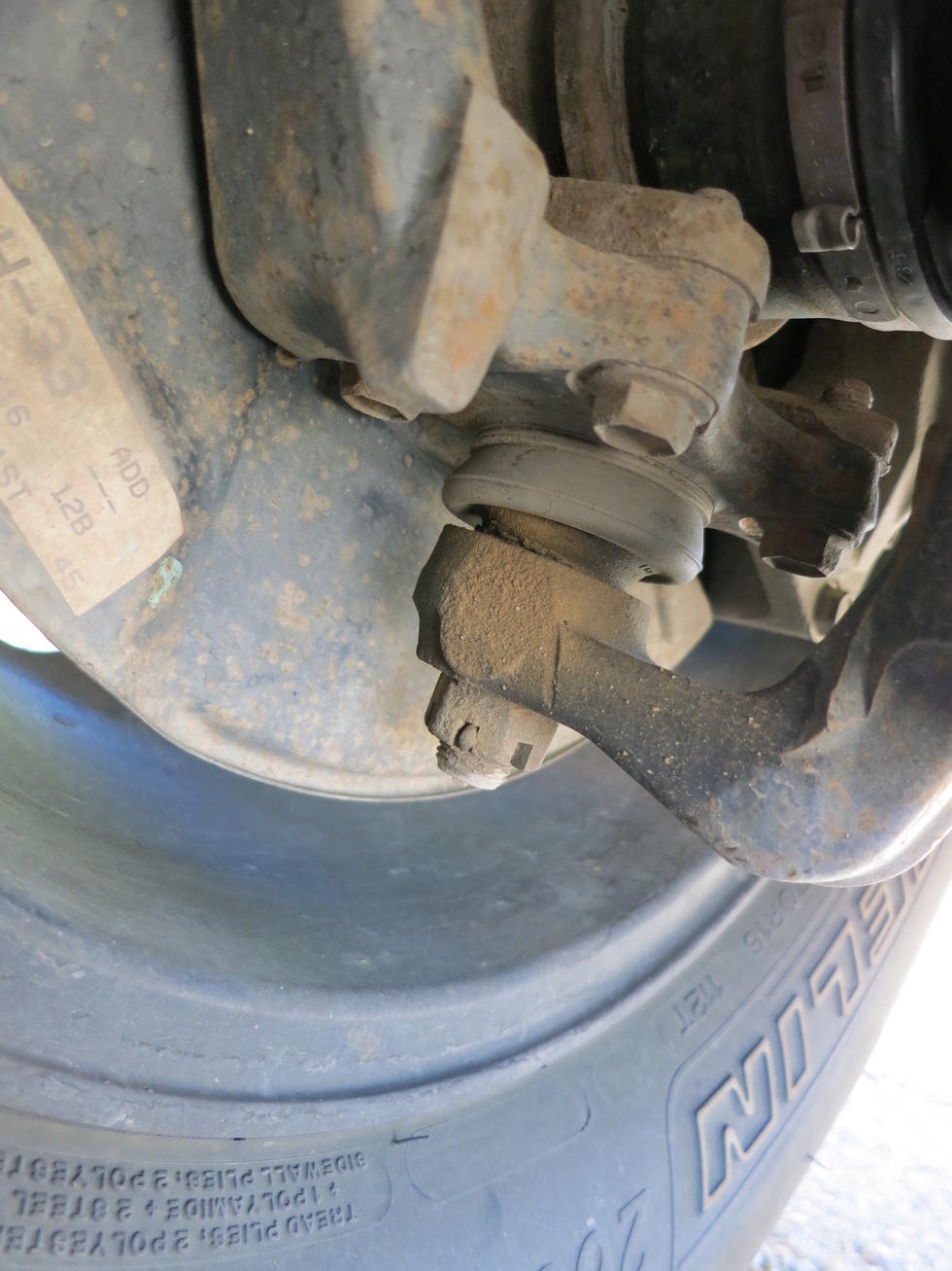

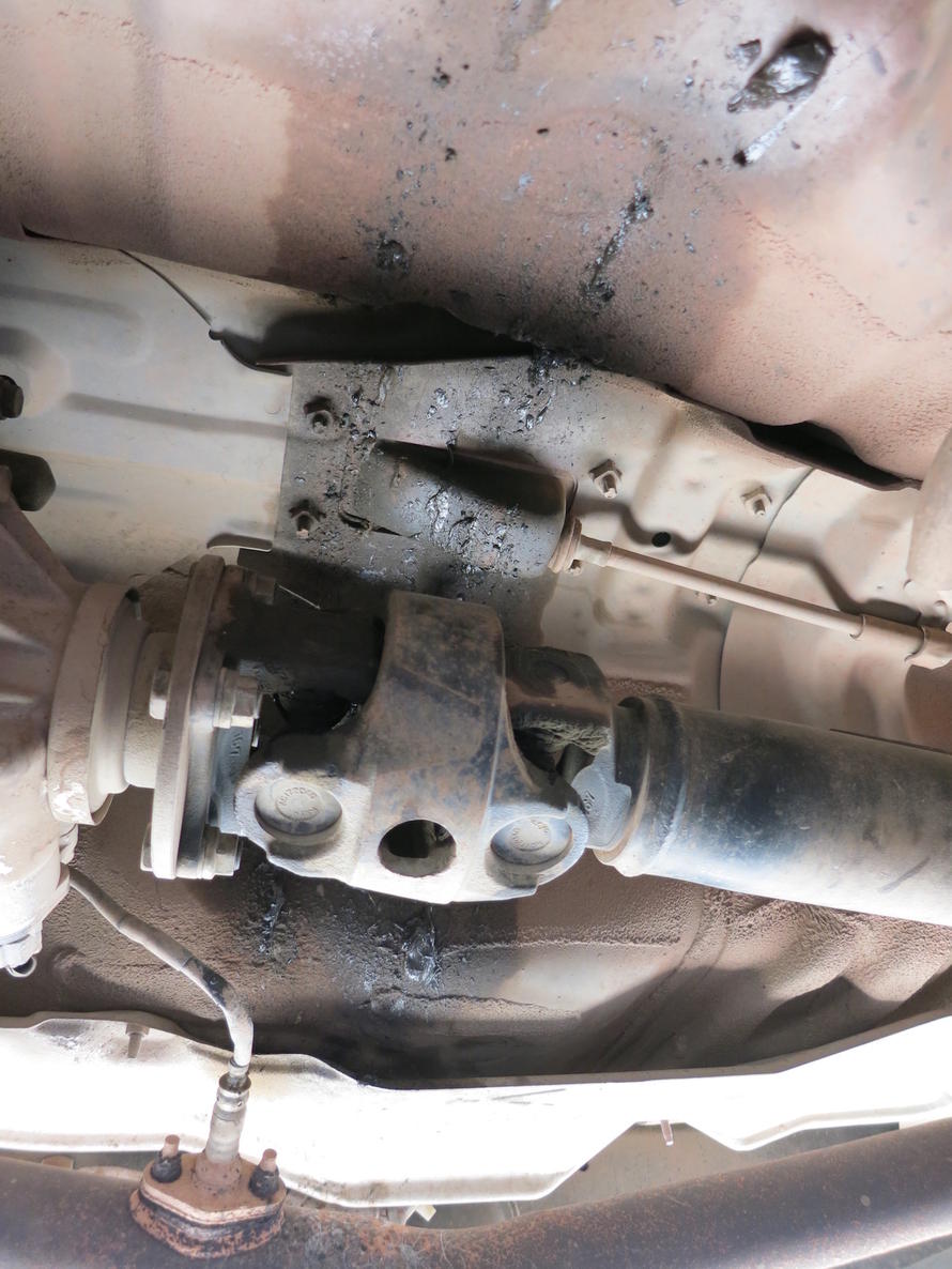

Itching to swap LBJs out, anything else look ripe?
If y'all could lend my your eyes for a sec... I don't have maintenance records from orig owner, but at 153k I'm thinking it couldn't hurt (while I'm waiting for the exhaust I bought to tide me over while I "save" for my lift;)
I was thinking tie rod ends same time. Here's the assembly ATM. Additional pic of major greasing it got last oil change. Hmmm, better grease everywhere than nowhere? Thanks for any suggestions

That looks like they greased it and didn't clean the old grease from outside the U joints after it was pushed out...then it span everywhere after driving :-)
