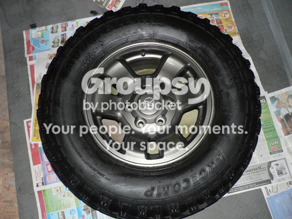

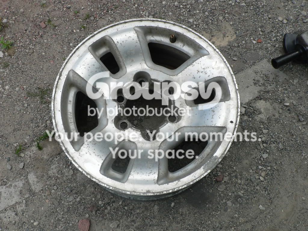

Here's my most recent project:

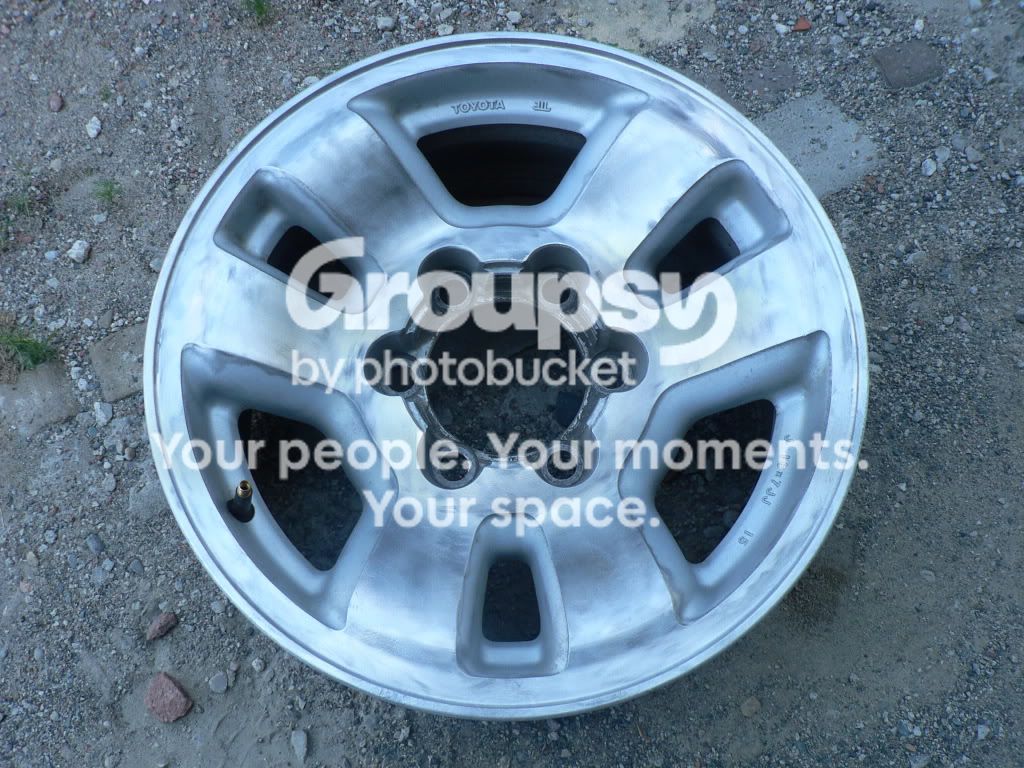

Started off with this:
P1130794.jpg~original
Then grinded them down with an angle Grinder and a wire wheel:
P1130796.jpg~original

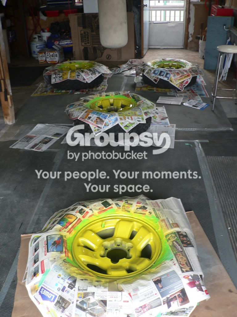

Then masked and primed them with Zinc Primer:
P1130892.jpg~original

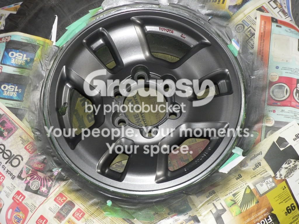

Then painted them, but sanded off the outer ring:
P1130895.jpg~original

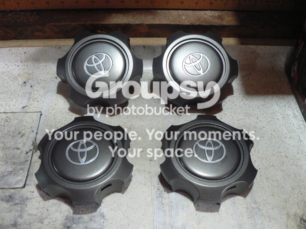

Did the Center caps too:
P1130896.jpg~original
Finished product:
P1140006.jpg~original
All in all, a good 2 days of work, and about $75.00 in paint bought..........

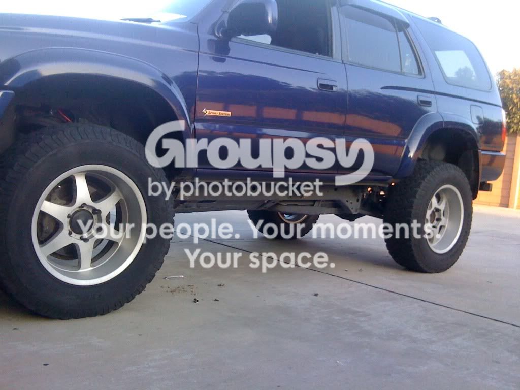

Here is mine I just did.
Answered all you question above in red. I just went in not thinking too much about it and turned out ok. :thumb3:
I personally don't like the way these came out, but props for trying the 2-tone (correction, they came out well, I just don't don't like the look that much). I have been thinking about 2-tone and yours is the only one I have seen done like this.
I was thinking about my wheels (the 5-stars) while looking at them, and I realized that i kind of liked the look of the brake dust collecting mostly on the inside of the spokes, darkest towards the rim, and getting lighter towards the center. I was thinking that painting them like that would look really cool (it'd look like shadowing). I don't know how I could paint the fade easily, so I kind of gave up on it, but I still think it'd look really cool.
I have since cleaned my wheels, which makes them look alot nicer, but I lost the shadowing effect I had going on. I really need to paint them soon...
Nice work. I'm not a fan of two-tone, but it was a cool idea.

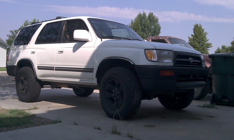

309526_234032353313206_100001193298402_618772_44520719_n.jpg~original
Rustoleum rattle can, Flat Black. 2 coats self etching primer, 3 coats clean metal primer, 3 coats Black

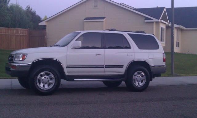

I was bored and had a few beers. Spare set of wheels and tires and some left over "night shades" lens paint. One coat
c5b23893.jpg~original
Two coats
16d9d363.jpg~original
